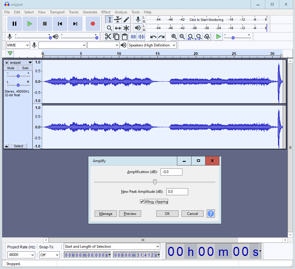

    By default the Amplify filter in Audacity increases the volume so that the loudest part of the audio will not clip (distort). My guess is that there are some parts of your video that are very loud already (this could be even a single sample) so the default amplification isn't very much. If you move the slider to the right (more amplification) those loud parts will become distorted. If those loud parts are just a small part of the full audio you can manually exclude them and crank up the volume for the rest.
    Here's an example. The track has a very loud section at the very end. If you use Amplify to increase the volume of the entire track:
    [Attachment 65613 - Click to enlarge]

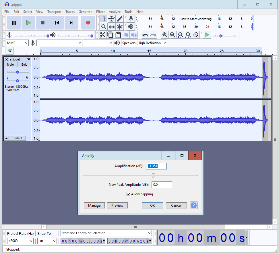

    it defaults to 0.0 dB (no amplification). But if you select only the quite part:
    [Attachment 65614 - Click to enlarge]

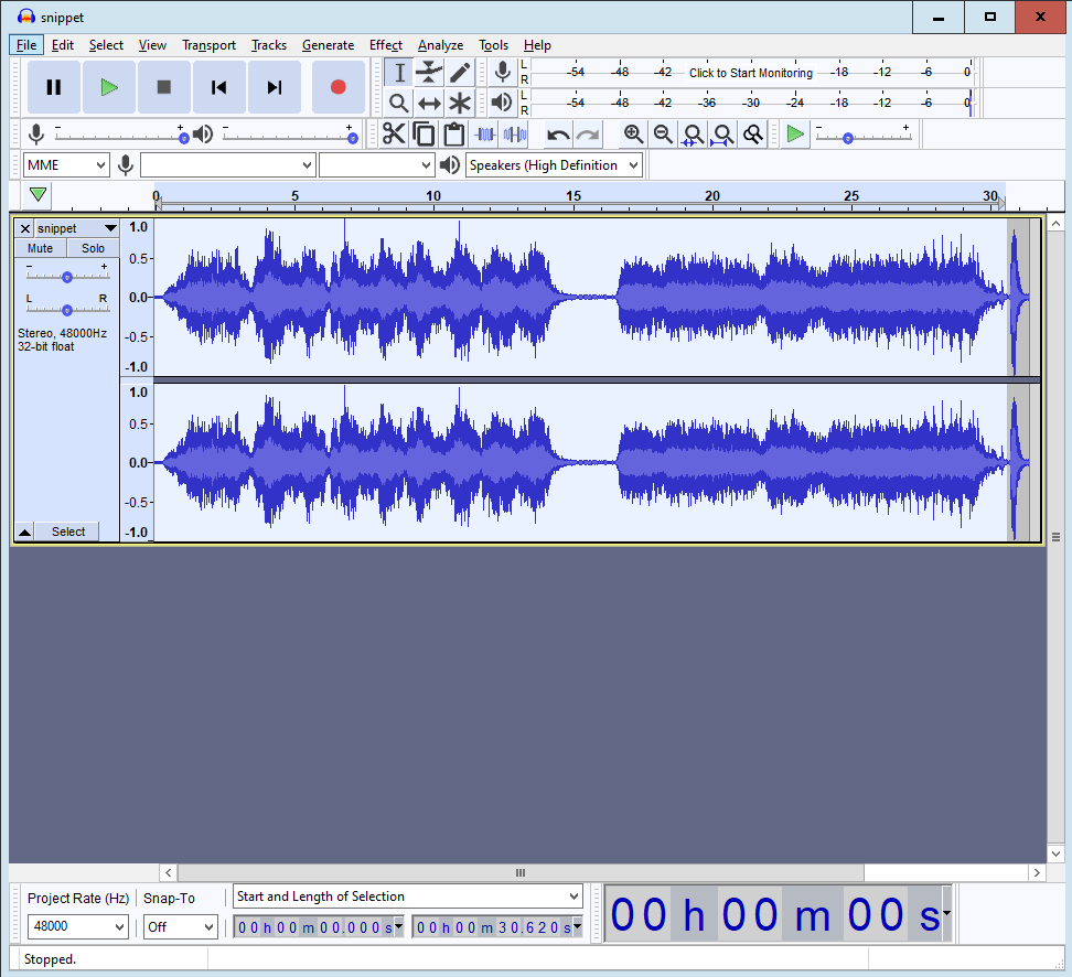

    it defaults to 11.351 dB of amplification. The soft part will become as loud as the loud part:
    [Attachment 65615 - Click to enlarge]
    Or you could use the Compressor (dynamic range compression) filter which will automatically increase the volume of the soft parts but not the loud parts (though it may sound un-natural at times as the volume pumps). If you're dealing with a 5.1 (or higher) source you can try just amplifying the center channel (where most of the dialog is).
