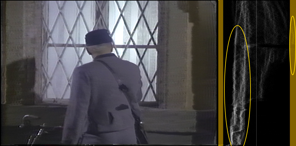

  1. Also using JVC HR-S3800U S-VHS VCR with S-video. Is there any way to get rid of the artifacts along the bottom other than cropping it out? I assumed the TBC would take care of that.
    Mar 2008
    I haven't looked at this latest video, but the interference at the bottom is usually the head switching noise,
    Not much you can do except crop/add a clean border back to keep the same frame size. Easy to do in Avisynth

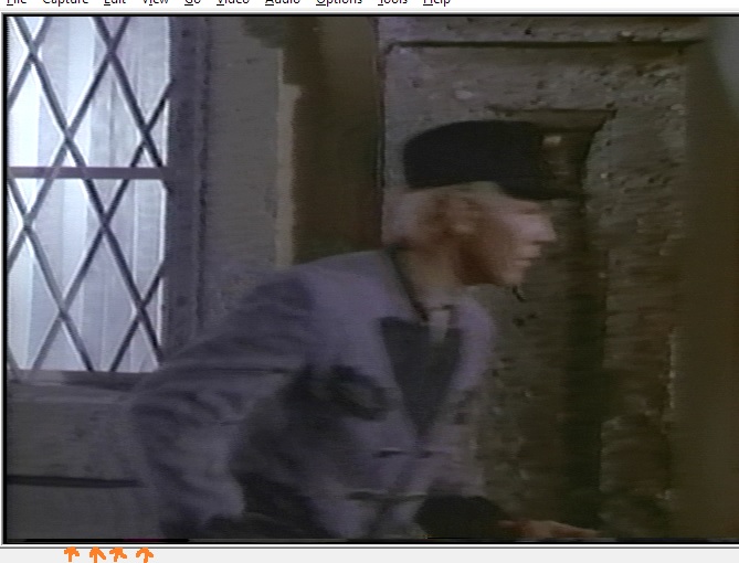

    The video has some strange ghosting, here as the guy moves to the right, you can see 3 or 4 shadows of where he was in previous frames.
    Could this be on the tape?

  8. Don't know, maybe.
    I would suggest lowering the brightness somewaht to make the luma better fit the 16 .... 235 range.
    The black level seems to be elevated.

    Jul 2018
    Italy
    Maybe. It could also be a denoise of the chroma across a temporal radius (cannot check now), even if this appears more on scene change.
    OP must be sure that all Noise Reduction is turned off in Panasonic ES-15.

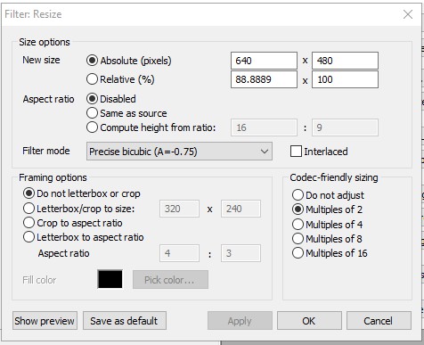

    @Sharc, is this a satisfactory way of doing this in VDub2?
    -Activate Resize filter as follows:
    [Attachment 65594 - Click to enlarge]
    -Export using the x264 8bit codec from the main video codec list (Configure>Quality factor 18 or a bit less), Audio in Full Processing mode, using AAC.
    -Rename video to MP4 (not AVI, which is the default).

  20. Looks right to me, yes, if you want to resize the NTSC 720x480 capture to square pixels. In this case make sure that when configuring the encoder, set the SAR width=1 and the SAR height=1.
    And you can't just rename the .avi to .mp4. When you export it via File->Save video ..... select the file type in the dropdown list as MP4 (MPEG-4 Part 14) (*.mp4). Then it gets correctly muxed into the .mp4 container.
    You could also encode it anamorph (e.g. for DVD). Then you don't need to resize the video but set in the encoder configuration the SAR width=8 and SAR height =9 for 4:3 NTSC. Or crop 8 pixels from left and 8 pixels from right so that the frame becomes 704x480, and set the SAR width =10 and the SAR height=11 in the encoder configuration.
    (For PAL captures you would have to adapt the values accordingly).
