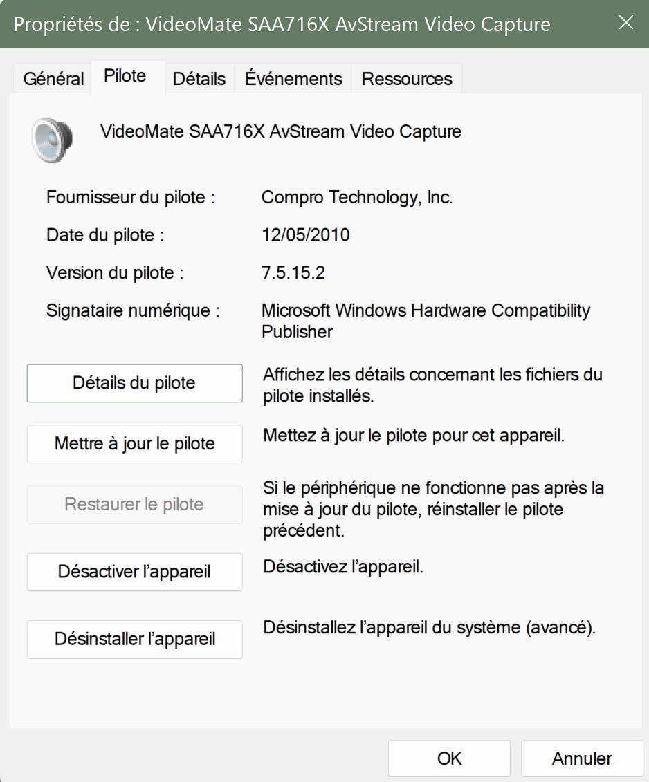

    Feb 2025
    europe
    Je réponds un peu tard à V_J.
    J'ai la même carte tuner tv et j'utilise le logiciel pouchin tv mod enImage
    [Attachment 85260 - Click to enlarge]
    64 bit sur window 11. Ca fonctionne très bien.
Name:	Videomate compro.jpg
  10. Capturing Memories dellsam34's Avatar
    Jan 2016
    Does the Pouchain TV Mode software captures analog video input? That's what the OP seems to want to do.
  11. Interesting... I still have the card but have not used it in a while - still haven't properly reinstalled Windows either...
    The main takeway would be that the card works under Windows 11, with those drivers (at least the tuner part), which is nice to hear. The manual of Pouchain TV does not seem to mention analog inputs, but they may be in a tuner dialog. Perhaps something to try...
