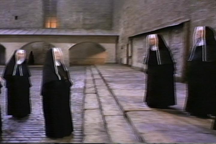

  13. Originally Posted by boolian2 View Post
    Ok I see the duplication every 5 frames. But how can you tell it's been deinterlaced?
    With VirtualDub you would see combing during motion. Something like this:
    [Attachment 65549 - Click to enlarge]

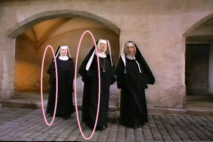

    boolian2, remove any sharpening in the player or in the capture card, to avoid the halos:
    [Attachment 65553 - Click to enlarge]
    when you'll have your new GV-USB card, capture 4:2:2, losslees, interlaced; you will deinterlace later in postprocessing if needed
