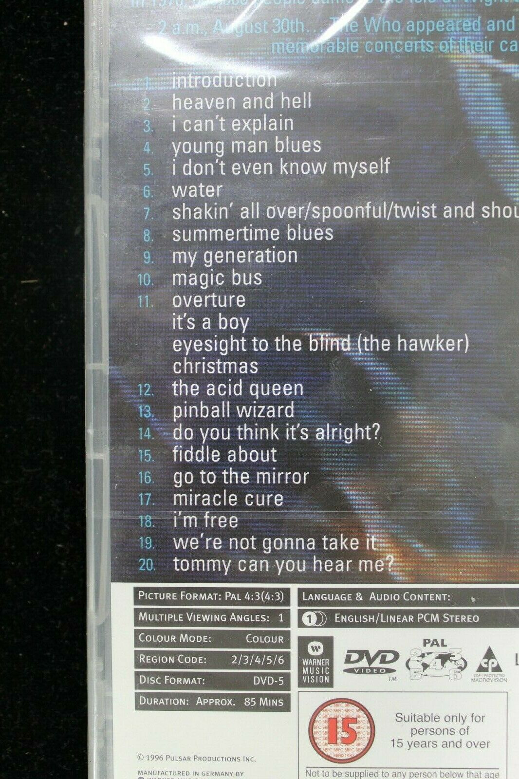

    Nov 2006
    [Attachment 65566 - Click to enlarge]
    This is a German dvd. Would this be 25fps?
  14. Member DB83's Avatar
    Jul 2007
    ^^ That would not be a German dvd. The '15' is a BBFC ( British Board of Film Classification) logo.Like I said, there are various later PAL releases and, like this one, would be 25 fps. Whether they originated from an earlier NTSC version one would only be able to tell from playback (Then you could get some frame-blending)

    Here is a version for the German market. Again @ 25 fps
    https://www.amazon.co.uk/Who-Live-Isle-Wight-Festival/dp/B000HXDLWO/ref=pd_sbs_sccl_1_...00HXDLWO&psc=1
    Aug 2013
    Central Germany
    The back cover states: "Picture format: PAL" (and has some kind of PAL logo). So I would assume 25 fps, yes. But it could be the result of a norm conversion.
