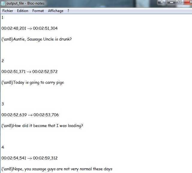

  3. Thanks it works. Is there a solution for empty spaces?

  4. Originally Posted by _Al_ View Post
    This might work, (not tested):
    infile =  'orig.srt'
    outfile = 'output_file.srt'
    #formatting new line, where {0} gets formatted as original text
    new_line = '{{\\an8}}{0}\n'
    with open(outfile, 'w') as out_file:
        with open(infile) as in_file:
            rewrite = False
            for line in in_file:
                if rewrite:
                    #format new text line
                    out_file.write(new_line.format(line))
                else:
                    #just copy line
                    out_file.write(f'{line}\n')
                if '-->' in line:
                    rewrite = True
                else:
                    rewrite = False
    It works after removing
    \n
    Thanks again
  5. ok, '\n' is a new line for printing. I thought that when reading lines that line variable string does not carry it at the end.
