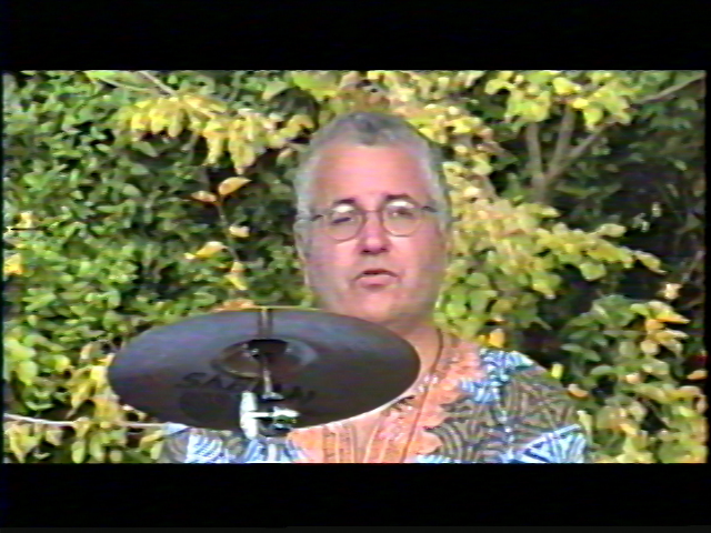

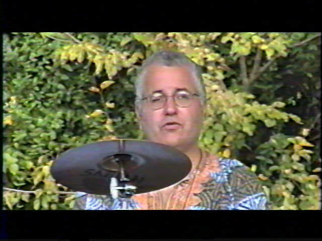

    I may have mis-spoke. I found a professional tape I had done with SMPTE bars and tone and was able to tweak the input settings using colortools vectorscope. I did a frame vs frame again and they now favor. I'll see if I can post some comparisons after some more testing.
    May 2007
    Here's the comparison. I can probably desaturate the HVR2250 a little more and shift the hue to exactly match the DV frame, but the settings on my HVR2250 are calibrated to the colortools vectorscope with SMPTE colorbars whereas I think my Sony TRV-720 may slightly desaturate and slightly shift the colors off the original. Personally, I don't see enough difference to warrant re-doing all the captures using the HVR2250...especially when the final renders will be x264 480P60 using Yadif BOB since that's the only way to get SD content at 60fps on Plex because it doesn't support interlaced.
    x264 Lossless from HVR2250 (4:2:2)
    [Attachment 65515 - Click to enlarge]
    DV Passthrough from Sony TRV-720 (4:1:1)
    [Attachment 65514 - Click to enlarge]
