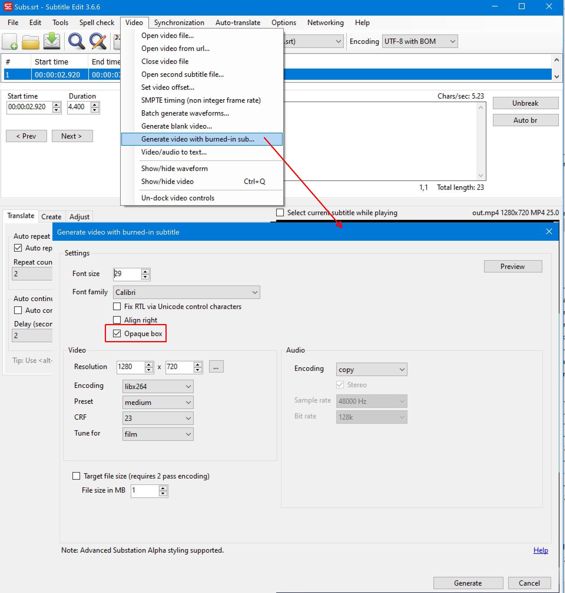

  4. Or you could use Subtitle Edit.
    Drop your subtitle on it. If the video has the same name it loads automatically. Else use "Video -> Open video file"
    Then use "Video -> Generate video with burned-in subs" and you can give some settings.
    [Attachment 65447 - Click to enlarge]
    As far as I remember SE will download FFmpeg if it's not installed

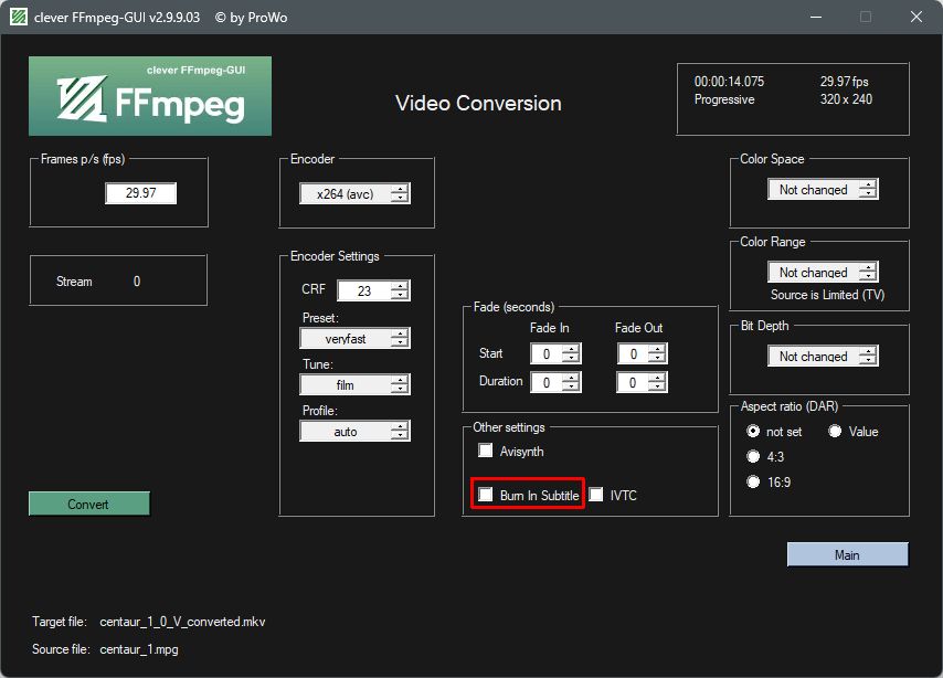

    You can also use clever Ffmpeg-GUI
    I downloaded but i dont see how can i do it! Any help please?
    Here your go:
    [Attachment 65528 - Click to enlarge]

  11. Originally Posted by Mohamet View Post
    Again i dont see this screen to my app!
    Load your file, wait until analysis is done, click main, click convert Videostream, click keep size and voilà, you are there.

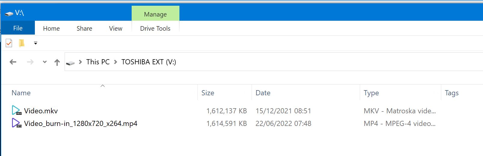

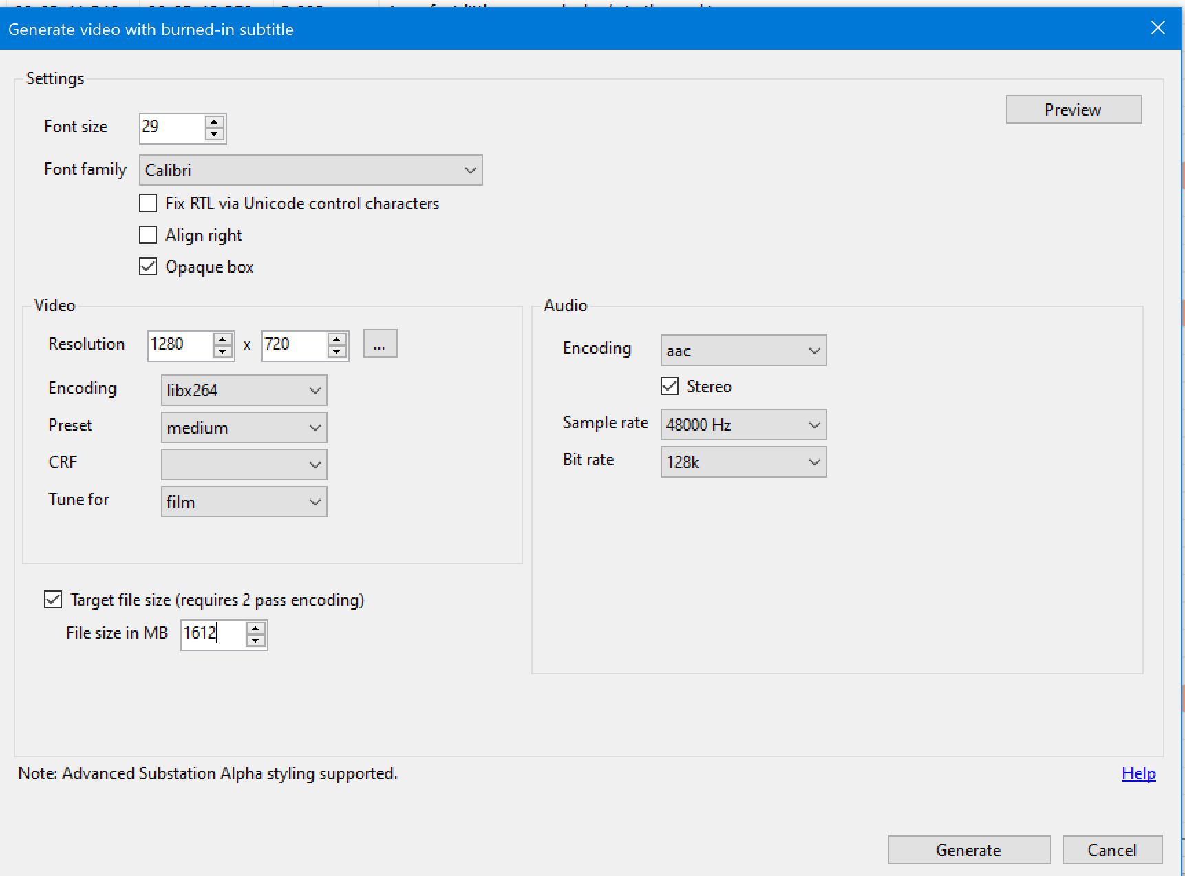

    [Attachment 65550 - Click to enlarge]
    The result is:
    [Attachment 65551 - Click to enlarge]
    The subtitles are .srt and embedded in the file Video.mkv.

  21. Originally Posted by videobruger View Post
    I try it, but again have less size and not the same! From 1.44GB i get 900MB.
    I don't know your settings.
    But using this:
    The result is:
    Awesome! Work perfect with this way!
