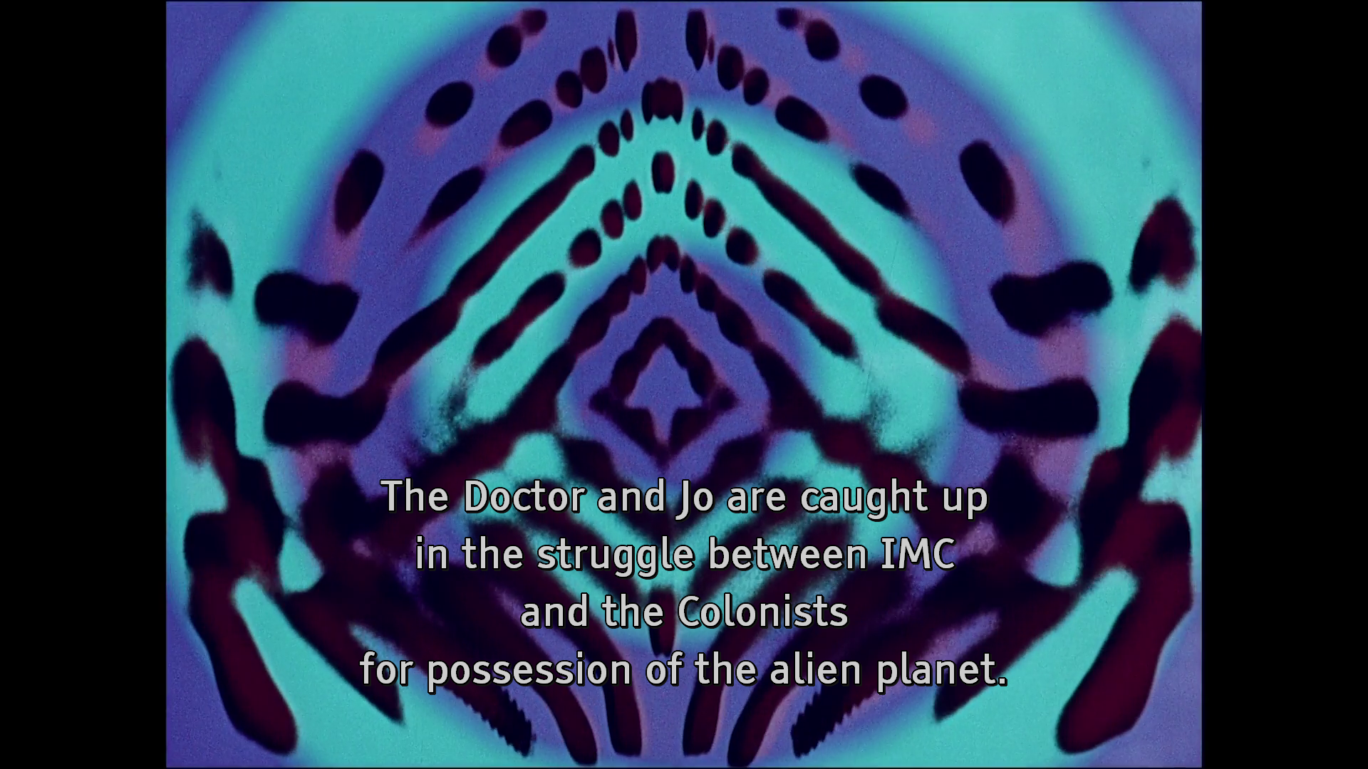

    I am still unsure as to how I can convert my subtitles? As I said they are Blu-Ray Sup, and what I really just want to do is add a gap of about 2 seconds into them? I see here mention of an NLE, which I have no idea is, nor do I understand why Subtitle Edit won't instantly import these subtitles in the same layout they originally have? I have included a picture of my source video for assistance. As you will see the original video was 4:3, and the subtitles appear on 4 lines. Subtitle Edit imports this in just 2 lines and wants to do widescreen. How can I fix this?
    Also, when I try to edit manually Subtitle Edit won't let me add a fourth line?
    Is there any software to import this format without rearranging the layout of the original without asking me first?Image

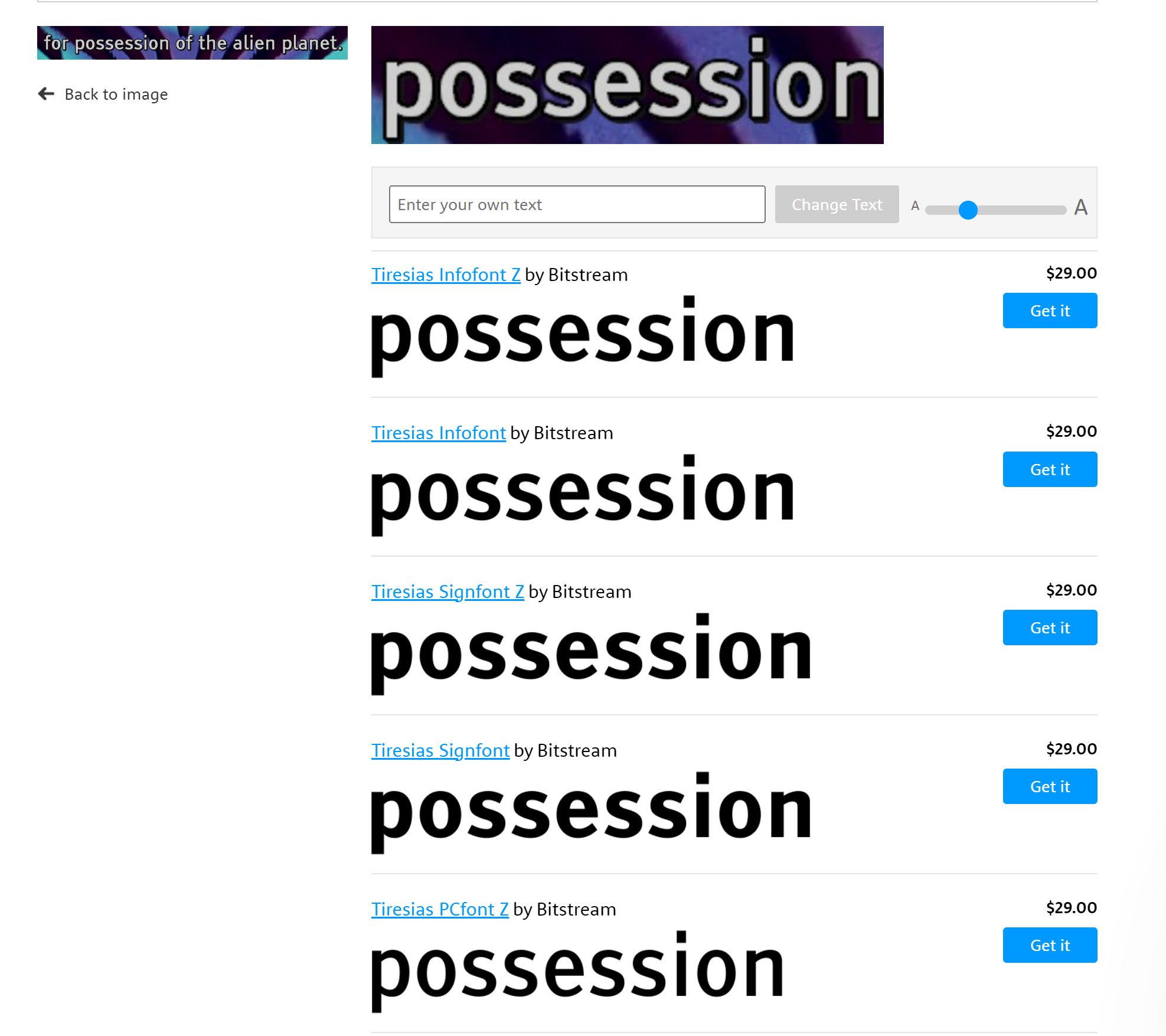

    The font used here appears to be "Tiresias Infofont".
    Good choice for subtitles.
  9. I dont't think the font is the OP problem anymore. But I drop a test on WhatsTheFont and it agrees with Skiller.

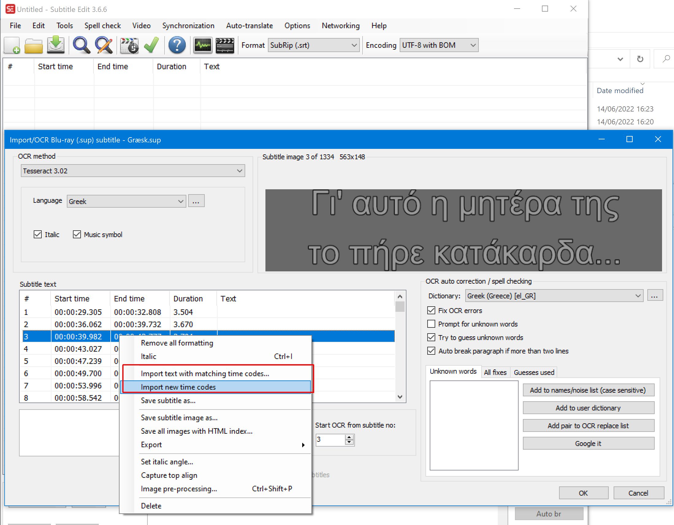

  12. and what I really just want to do is add a gap of about 2 seconds into them?
    Then it sounds to me what you wants is to change the time codes of a PGS file.
    Open the PGS in SE. Untick "Prompt for unknown words". Run the OCR. Don't mind the formatting. What you want from this is the time codes. Introduce your gaps and whatever. Just save it as .srt.
    Open the PGS again and rigth-click in the "Subtitle Text" window and use the time codes from the srt file you created. Right click once more and select "Export -> Blu-ray sup"
    [Attachment 65413 - Click to enlarge]

  14. Originally Posted by videobruger View Post
    Thanks for this. Works perfectly!
