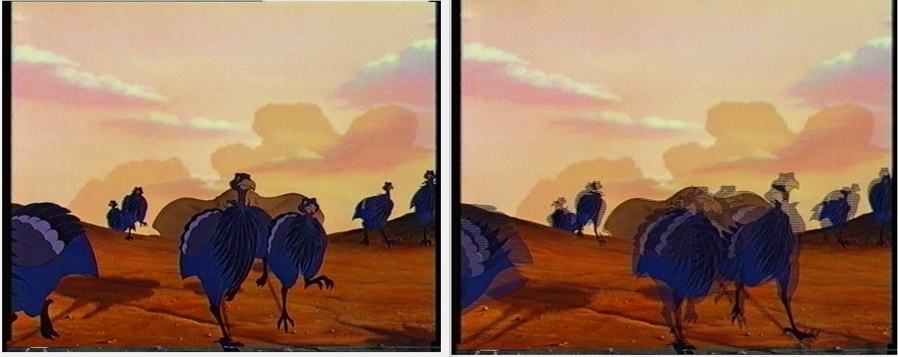

  1. I have a DMR-EZ49V VCR (HDMI Out) and a HDMI Capture device. This workflow only allows me to capture the source at 576p (Lossless).
    I understand that the Panasonic is simply bobbing to 576p so I should be able to undo the deinterlace losslessly?
    I've tried using SeparateFields().SelectEvery(4, 0, 3).Weave() but I'm noticing two things:
    1) It appears to work in that I can see frame-by-frame that the combing is there, but then at certain points later in the test capture, the combing disappears, even on frames with motion.
    2) To confirm this inconstant behaviour I recapped the same scene, ran it through the same script, and unlike on the first capture where I get the combing, on the second I don't!
    Here's the 1st capture, showing two consecutive frames, at a point that shows a successful merging of fields:

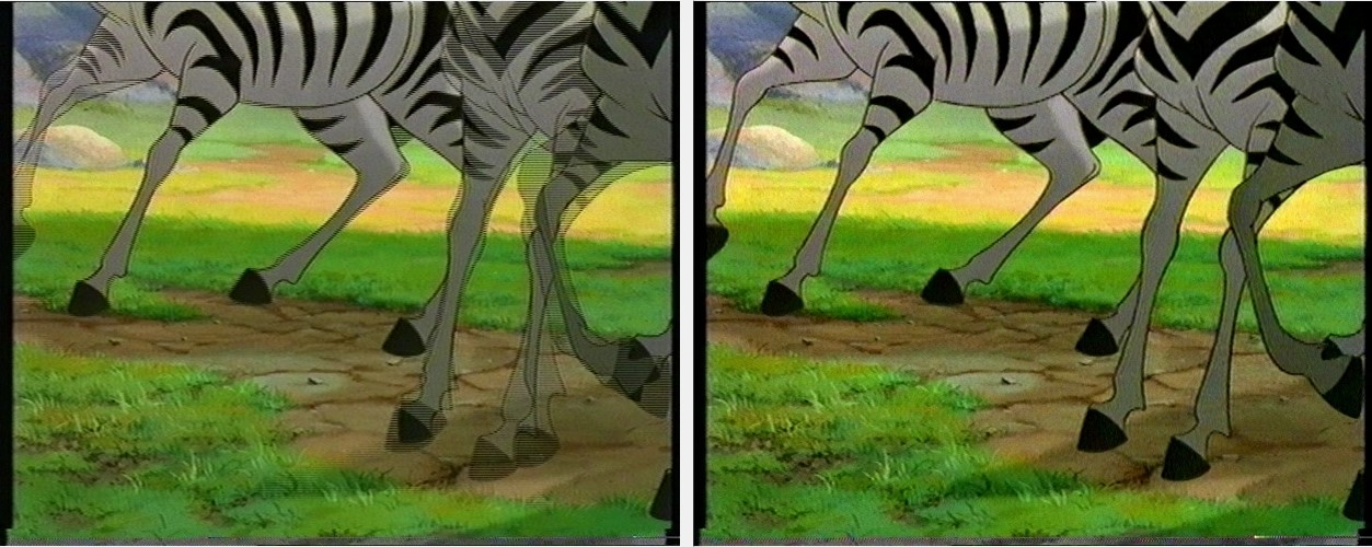

    Here's another area of the 1st capture where no interlacing shows (even over multiple frames of movement):

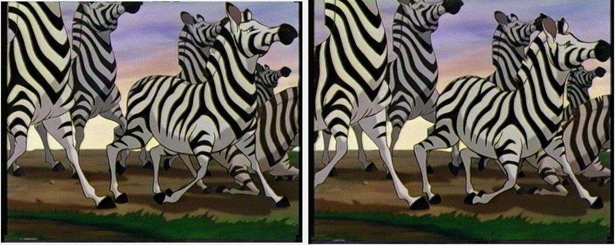

    Here's the same frame from the 1st and 2nd capture after merging fields. One successfully interlaced, the other shows no interlacing over any of the frames:
    [Attachment 65342 - Click to enlarge]
    ...I've tried (4,1,2) as well.
