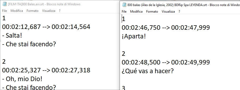

  1. I have an .mkv video with sub SPA incrporate and an ITA .srt file of a dvdrip,
    with SubEdit I extracted theSPA .srt, what is the simplest method to synchronize them?

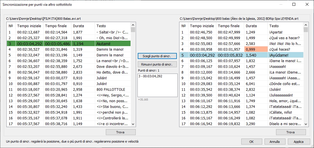

    I tried but it makes me synchronize line by line. Can't you do it in a single solution?

  4. Can't you do it in a single solution?
    Yes. You enter the time for the line you recognizeand set a sync point. Similar for the last line and press Apply & ok.

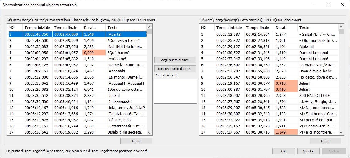

  5. I understood the mistake, first I import the sub I want to keep, you have solved my question,thank a lot

  6. I see a problem, because after synchronizing line 5 with 3, does 5 have a different duration from 3?
    [Attachment 65339 - Click to enlarge]
    before synchronization
    3= start 2:29.127
    5= start 3:04.292 stop 3: 05.832 time 1.540
    after sync
    3= start 3:04.292 stop 3:05.486 time 1.194
