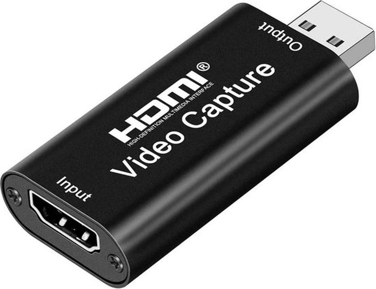

    There are converters that have both HDMI input and output, so using that as passthrough, you can strip the DHCP, and capture with a HDMI > dongle
    don't try to capture in progressive this way, most of the time this has side effects.
    This HDMI Video Capture dongle goes under various brand names the one from EarKings use USB3, others use USB2.

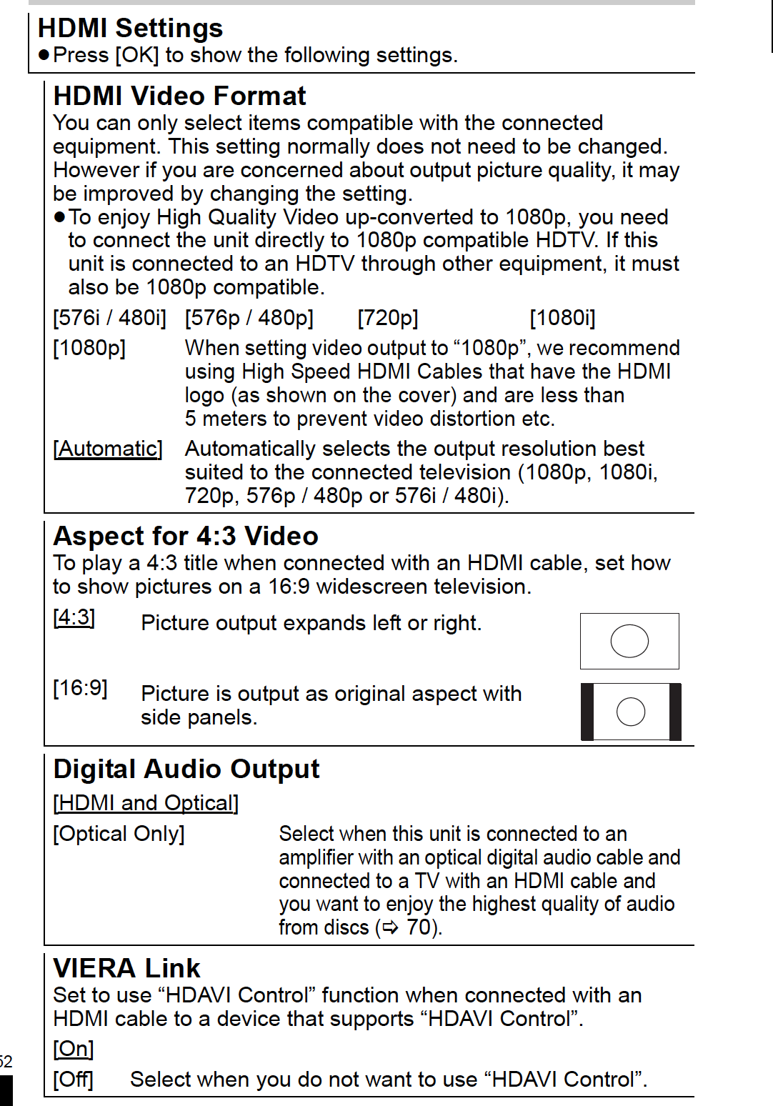

    Hi Eric, unfortunately it's something very similar that I used. (I tried two!)
    The first issue was that 480i/576i was greyed out in the HDMI settings of my Panny when connected to this sort of device, presumably because the handshake didn't allow interlaced.
    I then had to set the Panasonic and encode to 576p, which caused all the problems you can see in the thread linked above. Turns out that although it will accept multiple resolutions and framerates, anything other than a 30fps source ends up with bad frame cadence. It looked reasonable in motion and was only when stepping through frame by frame that we could see it was AABBCCDDEE (for 60) and ABBBCDDDEDDD (for 50).
Name:	Screenshot 2022-06-12 181833.jpg

    Other problem with these "sticks" is that the aspect ratio isn't picked up correctly, i know for sure the input gets the correct aspect ratio.
    To hook up HDMI video camera's these sticks are usable, but also not perfect.
    capturing analog video is best be done without pc, or have a good HDMI capture card (no USB) installed in your windows(?) pc, have a converter with HDMI in and out to strip the HDCP of your EZ49V you can use your EZ49V also as passthrough for any camcorder, the EZ49V gives a stable video signal ?
    If my ES35V gives up the ghost, i still have a DMR-EH63 dvr with HDMI output, recording/capturing outside a pc/laptop is a better option, due to "upgrades" of operating systems, that changes also the interface each time with that
    Did some searching…. best is to switch off VIERA LINK and set video format on automatic, but chance is still... it will output a widescreen with the 4:3 & sidebars, it will do this for sure in the 1080 setting.
    My guess is, it sees the dongle as a 1080i device, most of the time you can't control the dongle's setting, with Mac this is even more of a problem…. these dongle's don't need a driver though…
    [Attachment 65362 - Click to enlarge]
    ^^Click on image to enlarge^^

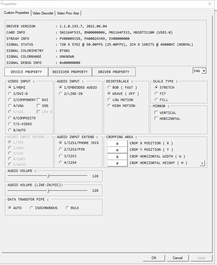

    The Startech USB3HDCAP happily captures 576i through HDMI from my Sony HXD 890. The driver says it is capturing BT601. I do need a HDMI splitter to defeat the HDCP. Results are as good as my Comp/SVideo USB sticks.
    [Attachment 65408 - Click to enlarge]

    Originally Posted by slikvik
    is that the properties screen of the Startech driver? Pretty detailed for Startech.
    Yes it is.
