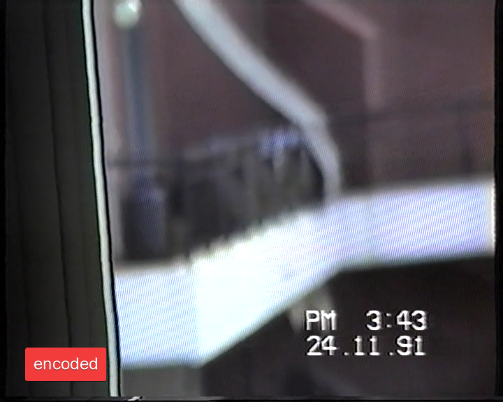

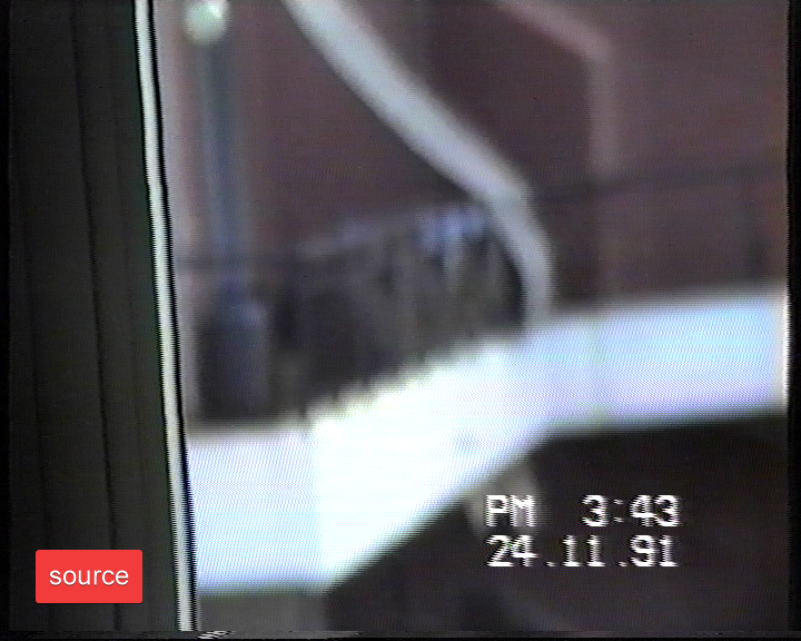

  1. Hi, I'm digitizing some VHS (I'm using an Hauppauge USB-Live2 and AmarecTV, because with virtualdub the videos were going out of sync) and when I watch the video I see diagonal lines (as you can see from the below pictures), although they don't remind me of the classic interlaced video effect

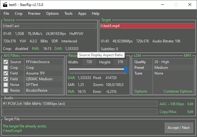

    I used StaxRip with the settings as per the image to convert to mp4, but in the encoded video those lines still remain
    Could someone please help me? Thanks in advance

  2. those diagonal lines have nothing to do with interlacing, thus QTGMC isn't the right tool to tackle them.
    Just from the screenshot DeFreq (http://avisynth.org.ru/defreq/defreq.html) might be something that could help.
    -> if you want help, you need to share a sample since a screenshot doesn't really tell anything about the temporal part which is essential in video
