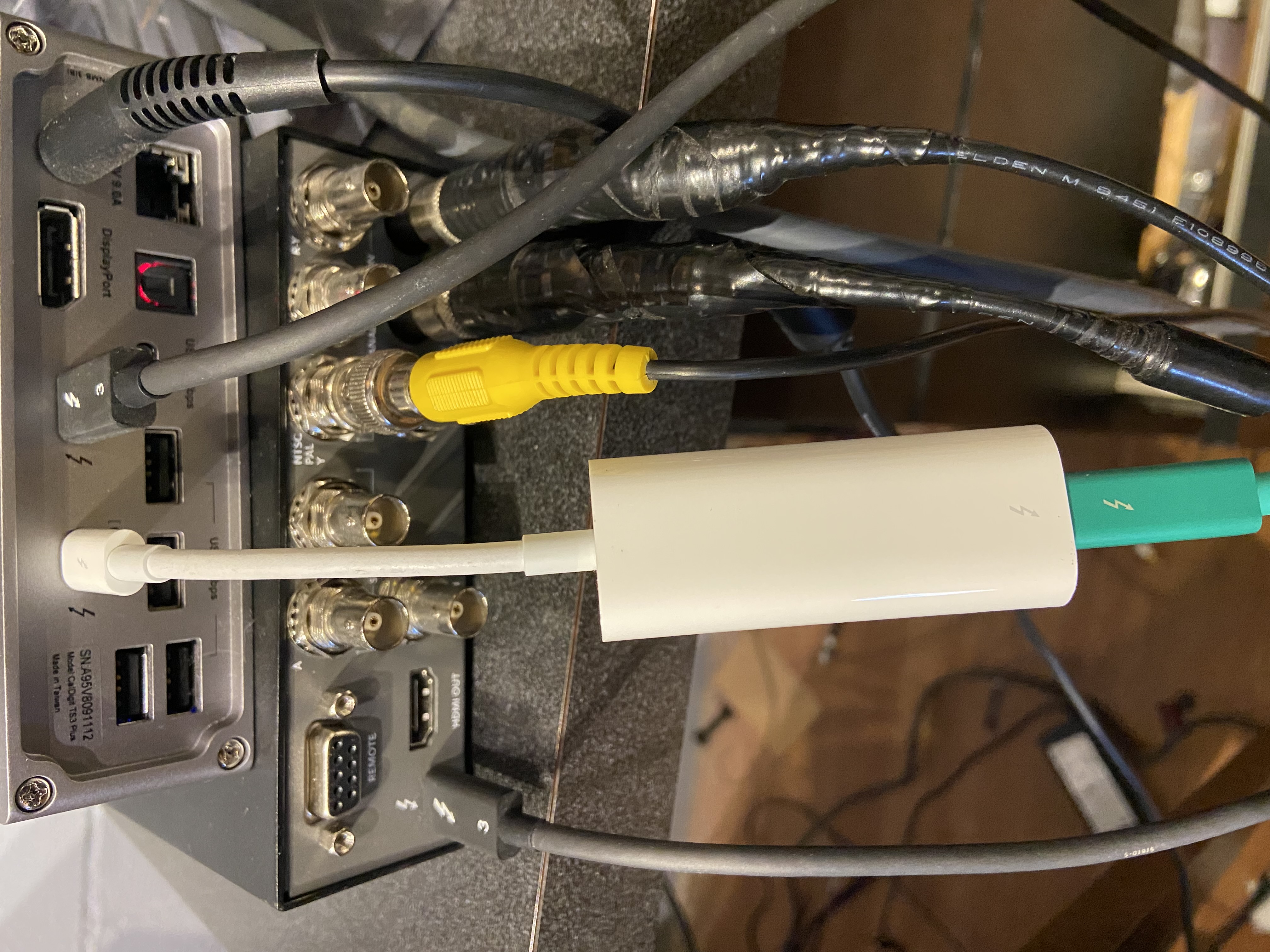

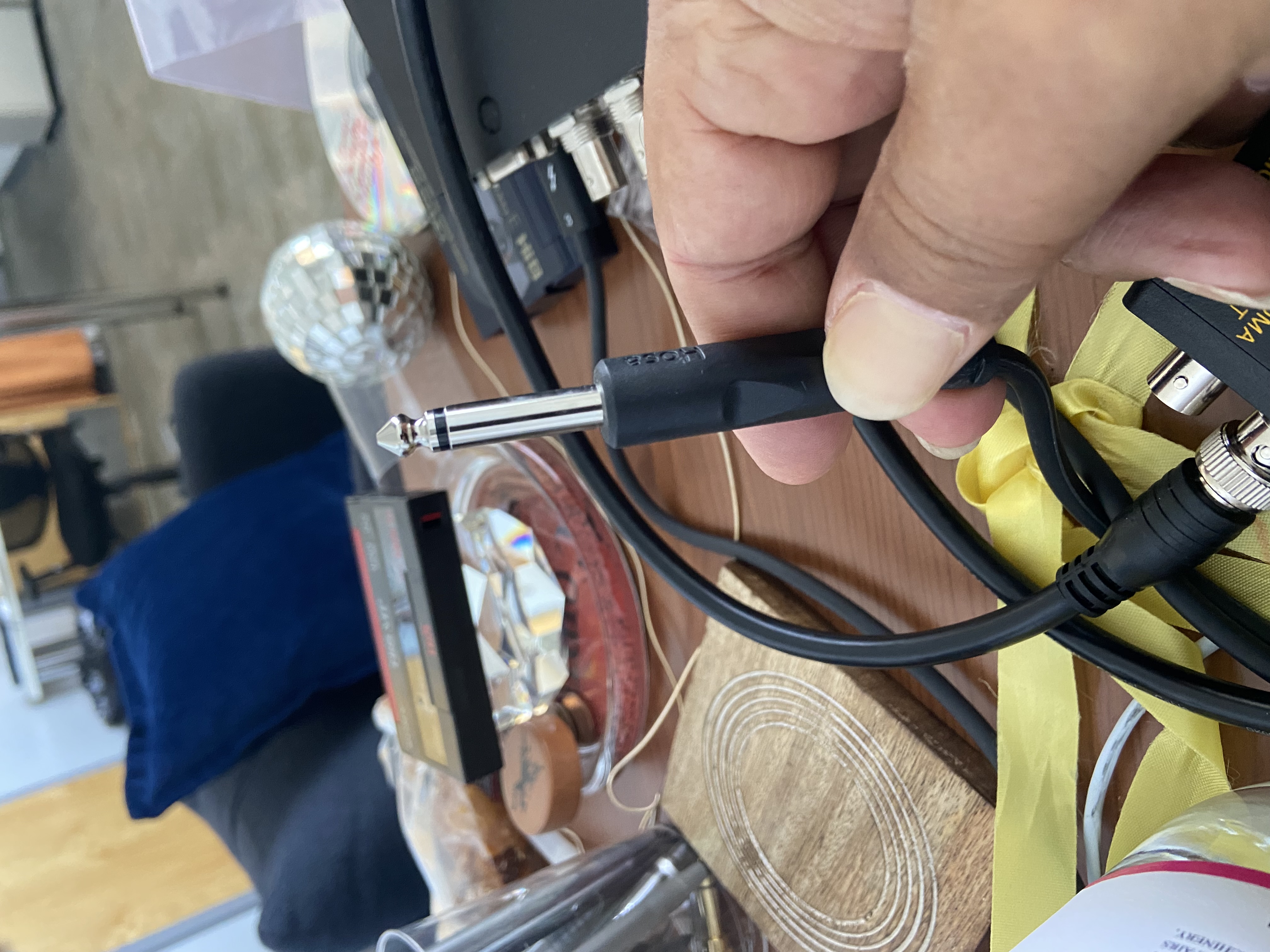

    I am a complete novice at this so i can't speak to the types of signals. Here is a photo of the back of the blackmagic and its connection to the CalDigit. Then there is a photo of the two Thunderbolt cables that the white adapter is connecting in order to plug into the Mac Pro. Image

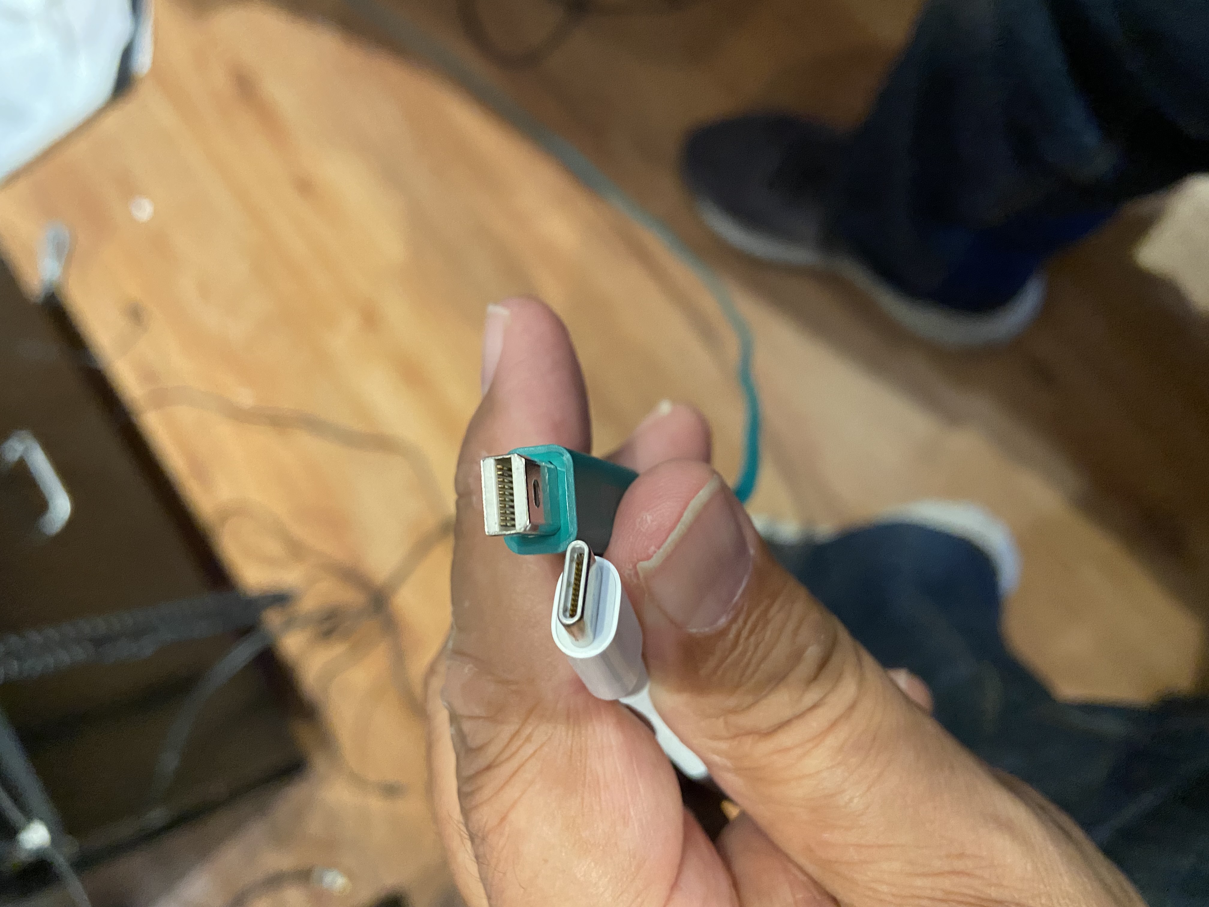

    Hi, I just installed Blackmagic onto another computer, an iMac, with a thunderbolt 3 input. So the signal is going direct from the Mini HD into the Mac. And the Hi8 camcorder is plugged directly into the Mini HD. But the audio distortion began to occur about 13 minutes into the capture - just as it was doing before when I was using a thunderbolt deck as an adapter into our Mac Pro that has no thunderbolt 3 inputs. The problem happens with both Hi8 and VHS decks. And the distortion is not present if I capture in short intervals. Really strange.
    Jan 2016
    What setting are you capturing to? 8bit UYV or 10bit RGB. I really need to know models numbers for those boxes so I can look up their specifications, Could you post a screenshot of the MediaExpress showing the setting?

    Is it this BM box you are using? If so, What type of 1/4" connectors you are using? Those are balanced 3 connector type (Hot, Cold, Ground), Usually to go from unbalanced consumer stuff to balanced pro connector you could just short out the cold to the ground however it is not always the case unless the manufacturer suggested so.
    Thunderbolt 3 is 40Gbps, so it shouldn't be the bottle neck, There is a performance test app in the Desktop software, it analyses your system performance (CPU, HDD, Memory ...etc), Launch it and set your video parameters and post the test results here.

    Those XLR audio cables in your pic look like some hot garbage, gotta say. That's an impressive level of electrical tape, which isn't a compliment. Get some new audio cables man, seriously.

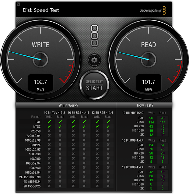

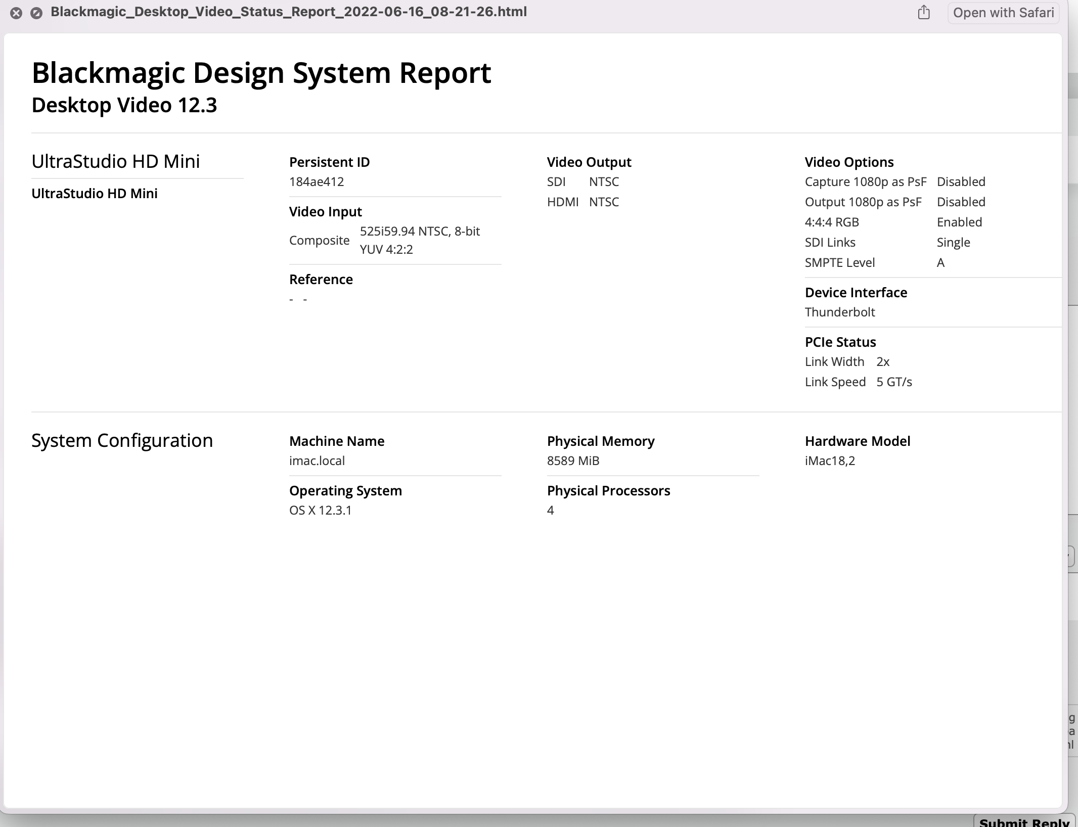

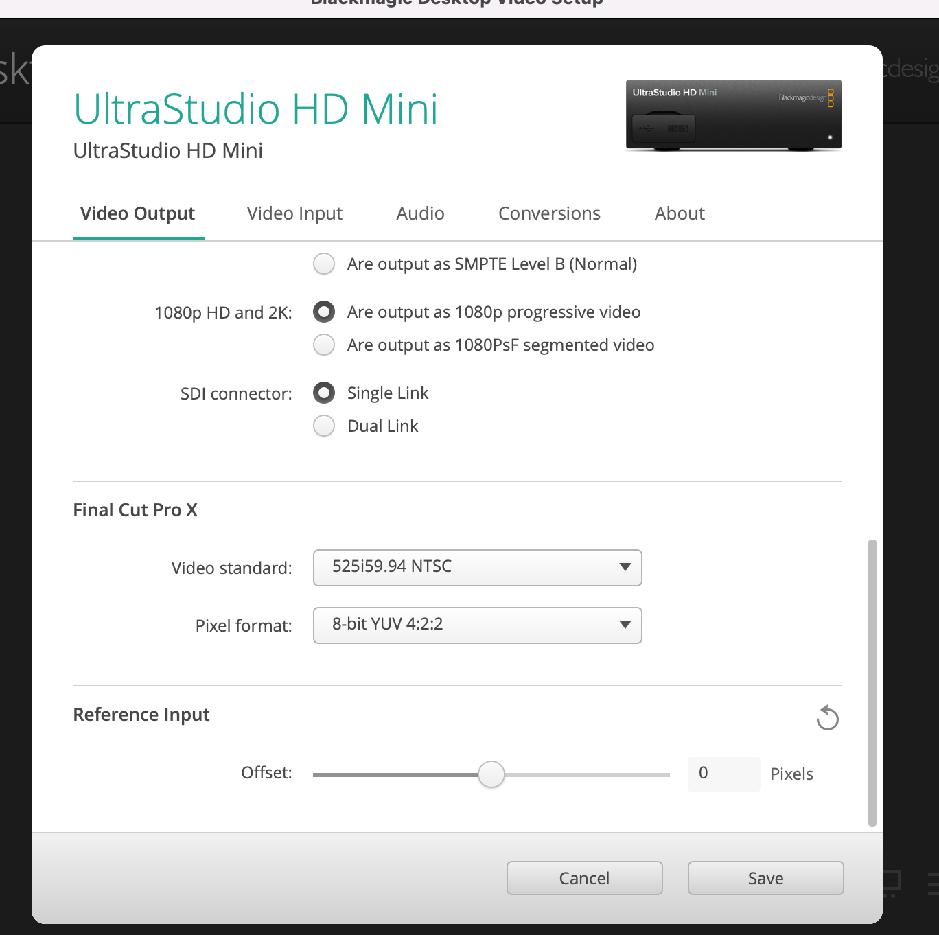

    I think this is the test

    Trying again

    Nope, It looks like this:

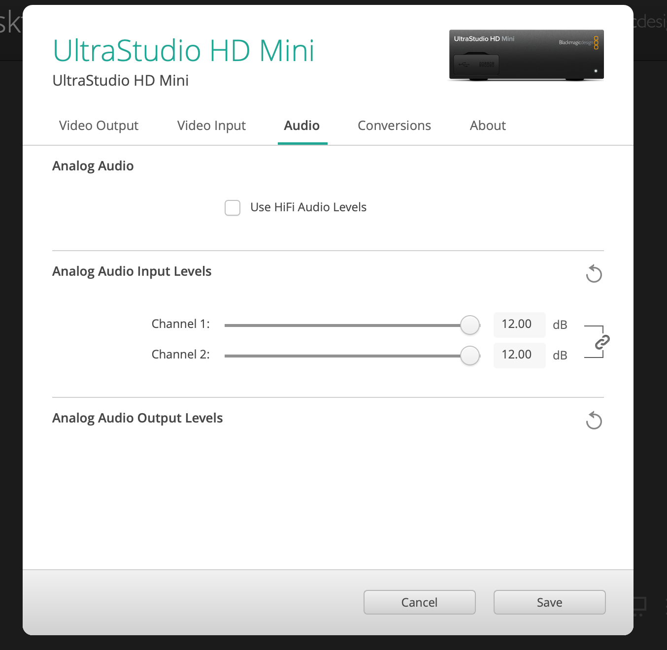

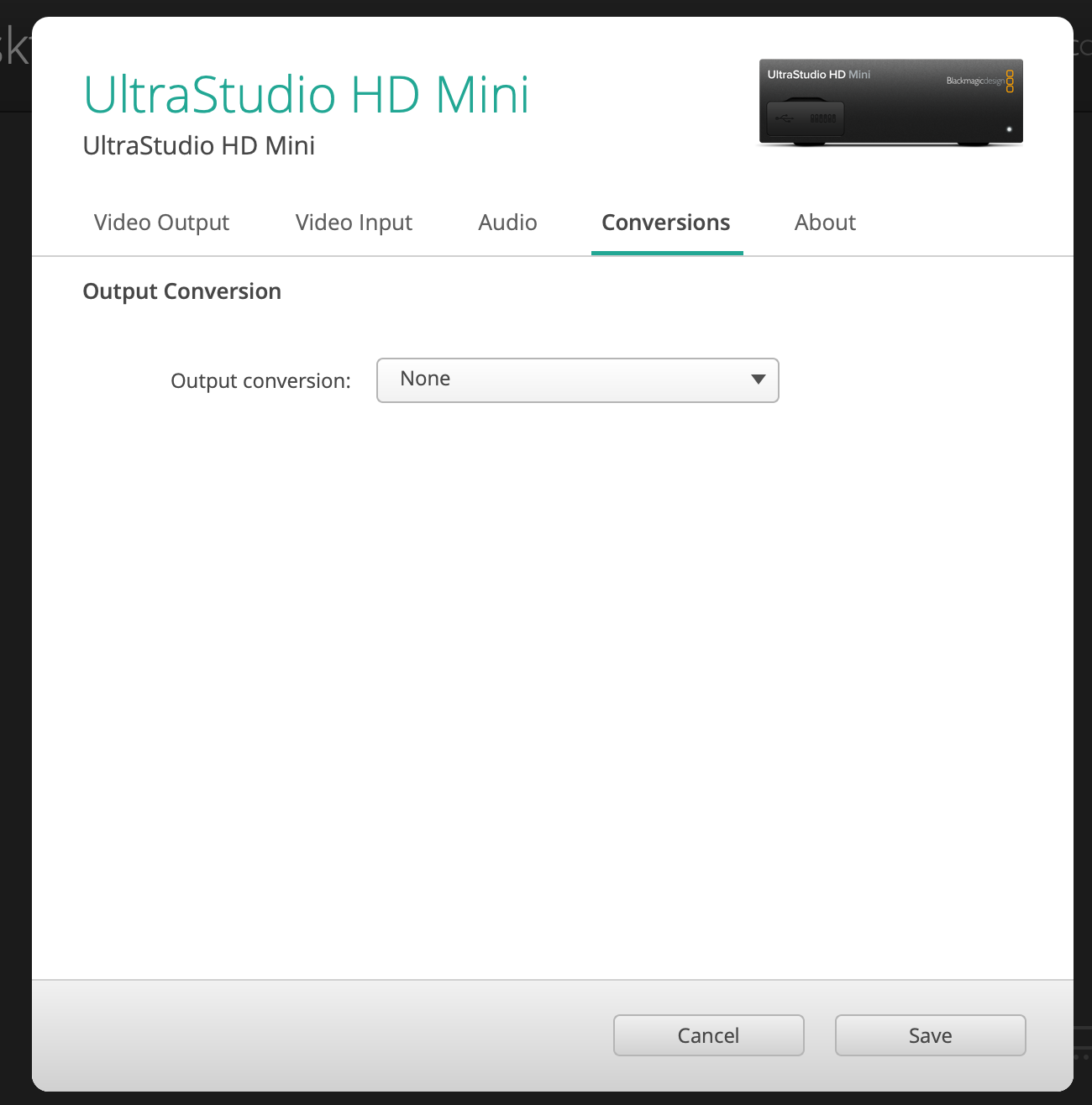

    Your settings are wrong, Output should be set to SMPTE 259M-C level C, not 1080p. For audio try checking "Use HiFi Audio Levels". Your 1/4 jacks should have 3 connectors, unless the cold is in the center sleeve not the tip.

    Thank you. Those settings were on my IMac which seems to have been overwhelmed by the capture. I went back to my Mac Pro and was able to capture an hour and a half tape without trouble. Here is a photo of the test.
