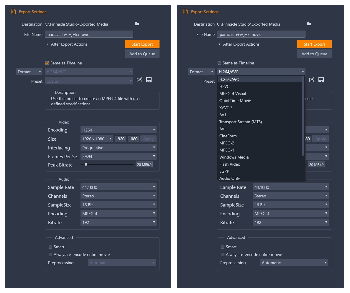

    Can't you export to a lossless format in Pinnacl Studio?
    As it so far seems, no.
    [Attachment 65312 - Click to enlarge]
    I've tried a few presets now. But it seems colors are degraded a bit after export, and parts of the dyn. mask bleed through. Even when I check "same as timeline".

  6. selecting format AVI should give you more options . If you have a lossless AVI codec installed, such as lagarith, it should allow you to use it
