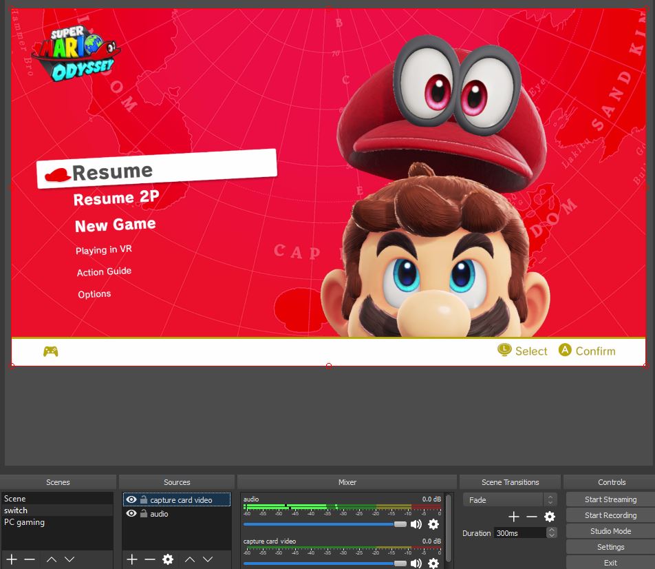

  3. Image
    [Attachment 65270 - Click to enlarge]
    The sources are just an "Audio Input Capture" from the source "HDMI(usb capture HDMI+)", and a "video capture device" from the source "usb capture HDMI+". The parameters are just set to device default, match output fps and so on, everything is set to defaults but in checking for errors I tried to change everything I could without help.

  7. Late response but I've had my share of OBS audio headaches. Saw this in the OBS text file:
    17:56:38.836: video device: USB Capture HDMI+
    17:56:38.836: video path: \\?\usb#vid_2935&pid_0004&mi_00#7&c417ff&0&0000#{6 5e8773d-8f56-11d0-a3b9-00a0c9223196}\global
    17:56:38.836: resolution: 1920x1080
    17:56:38.836: fps: 59.94 (interval: 166833)
    17:56:38.836: format: YUY2
    17:56:38.878: using video device audio: no
    17:56:38.878: audio device: Computer (USB Capture HDMI+ Computer)
    This tells me the capture card video device you've added is NOT using its HDMI audio as its associated audio input in your scene, and is using "computer" (peeked briefly at their documentation and it looks like this is for if you are screen recording your desktop which you aren't, you have added the card as a video device). Try going to the video device settings and changing the audio device associated with it from "computer" to "HDMI" so it is grabbing from the source and see if that works. If not may need to see screenshots of all of the settings associated with the video device and audio device.
