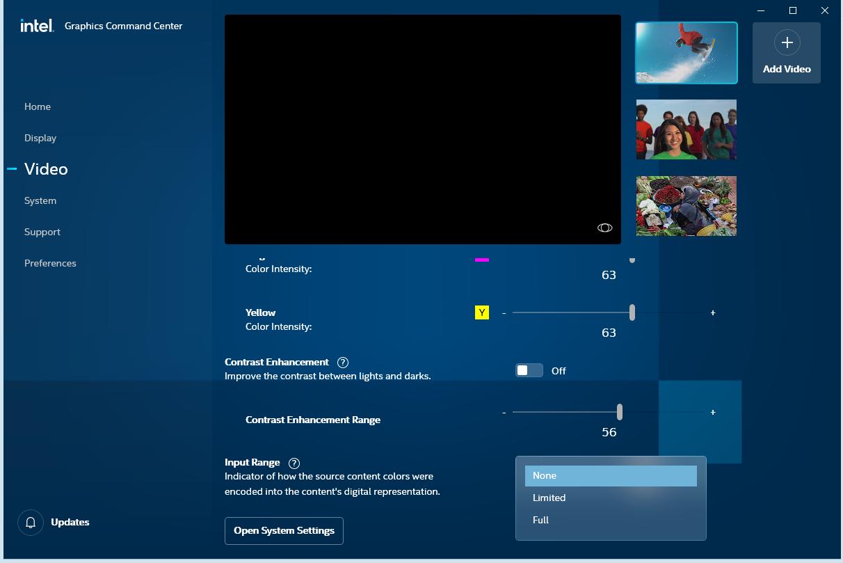

I believe it's the graphic driver that's responsible for that. At least in part. Use the manufacture's graphics config applet to make sure it's not forced to limited range or full range. Intel for example has a pulldown where you can select None, Limited, or Full.
[Attachment 65770 - Click to enlarge] -
