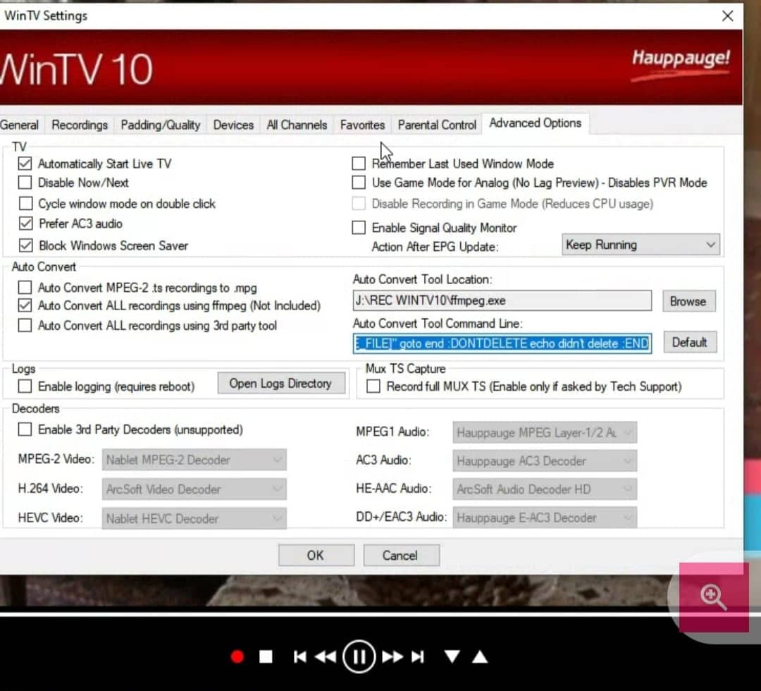

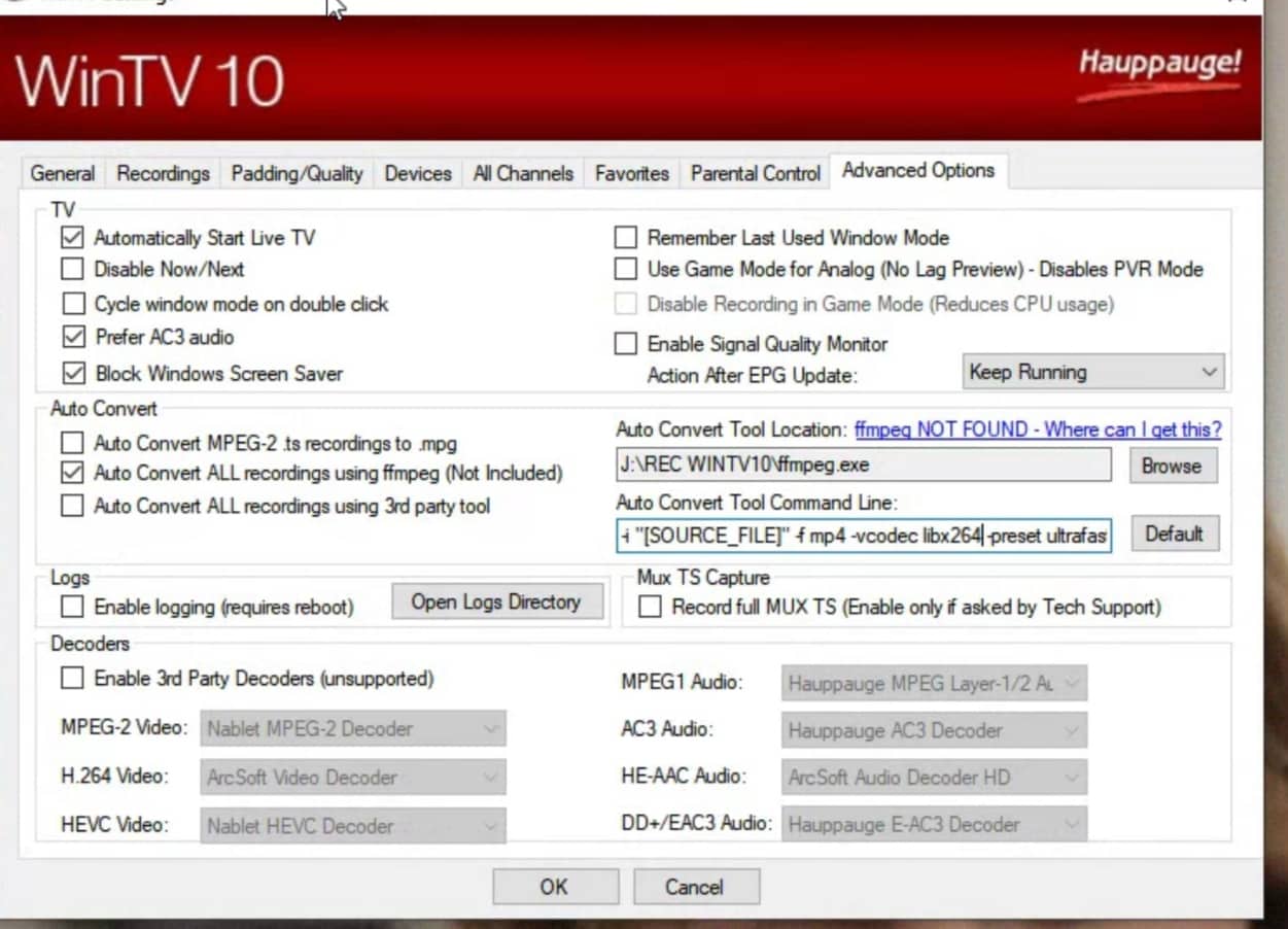

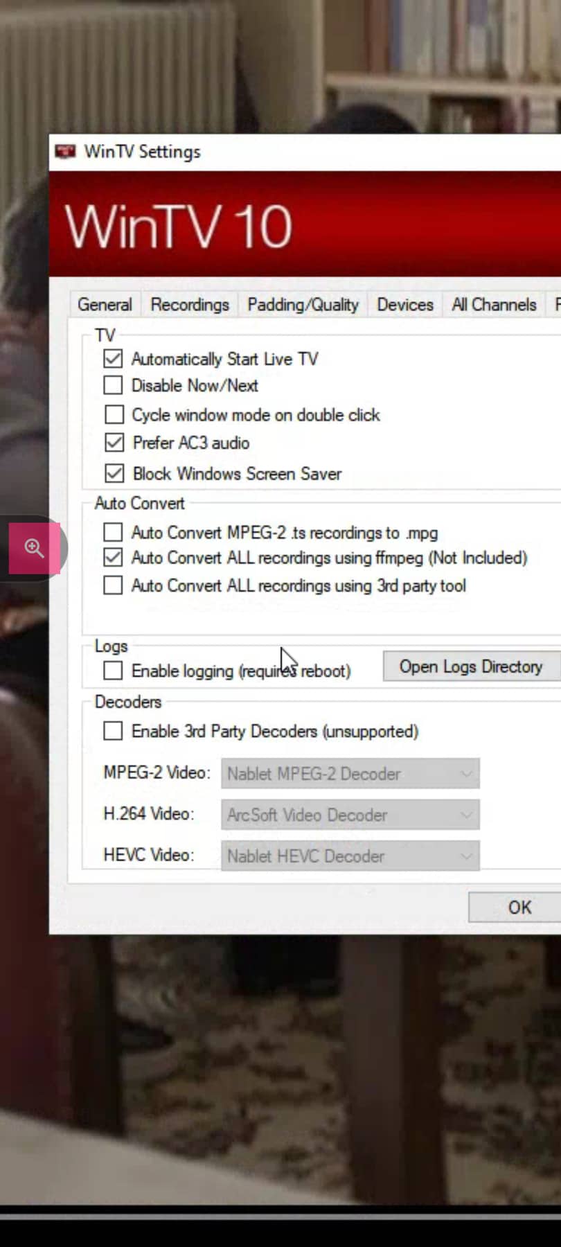

    Hi , I am using Hauppauge WinTV and my schedule recordings having the .ts format.
    [Attachment 65249 - Click to enlarge]
    WinTV has the option by converting all recordings using ffmpeg
    by default the ffmpeg command for the conversion of the recorded .ts files to.mp4 is as follows:
    -i "[SOURCE_FILE]" -f mp4 -vcodec libx264 -preset ultrafast -profile:v main -acodec aac "[DEST_FILE].mp4"
    [Attachment 65247 - Click to enlarge]
    [Attachment 65248 - Click to enlarge]
    How to modify the above command in order to set ffmpeg to always converting huge .ts files in size to .mp4 format but the .mp4 file to be much smaller in size?
    please advise,

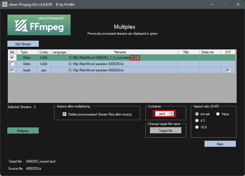

  3. Use clever FFmpeg-GUI.
    It's designed for just that purpose. You can, for example, re-encode only the video track (to make it smaller) and mux one or more audio tracks unchanged from the ts file into a new container (e.g. mp4, mkv etc), or you can also change each audio track as you like.

    I've tried it but no option to convert .ts files to .mp4. By default videos conversion encoder is x264 (avc) that gives the result to .mkv output target file.
  5. Originally Posted by neroman00 View Post
    Thanks!
    The new created videostream is per default enbedded in a mkv container. Mux it with the desired audiostreams to mp4.
    [Attachment 65285 - Click to enlarge]

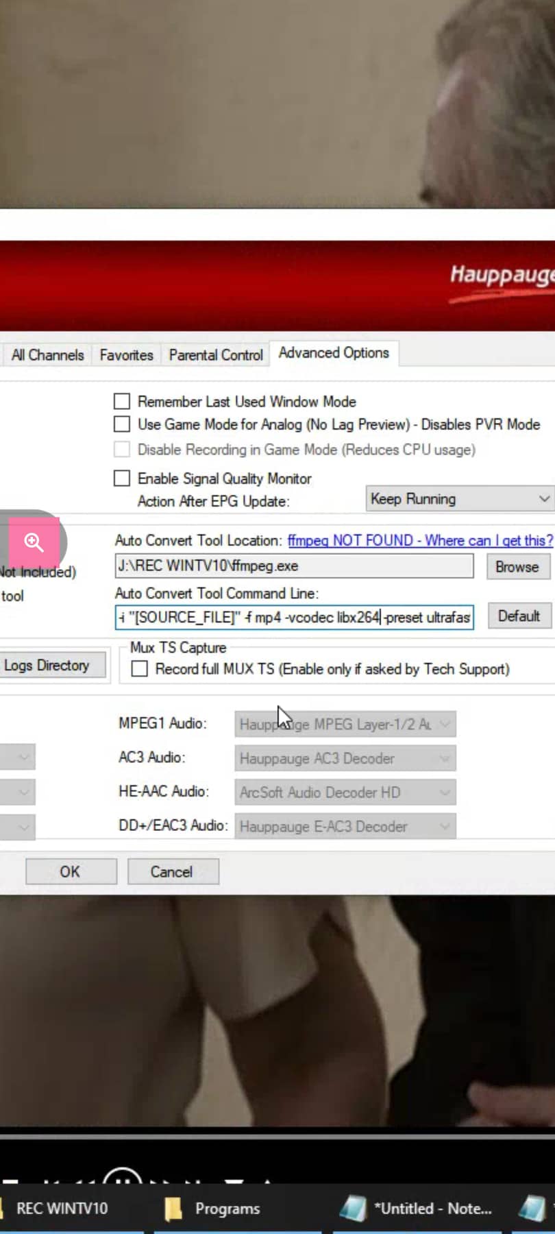

    Hi again,
    The following command is working fine:
    ffmpeg -i "[SOURCE_FILE]" -f mp4 -vcodec libx264 -preset veryfast -crf 25 -profile:v main -acodec aac "[DEST_FILE].mp4"
    I added your new batch file command without line brakes in order to be recognized to my software's settings as following:
    -i "[SOURCE_FILE]" -f mp4 -vcodec libx264 -preset veryfast -crf 25 -profile:v main -acodec aac "[DEST_FILE].mp4" if errorlevel 1 goto DONTDELETE del "[SOURCE_FILE]" goto end ONTDELETE echo didn't delete :END
    [Attachment 65383 - Click to enlarge]
    After this there is not any result!
    [Attachment 65382 - Click to enlarge]
    Please advise!

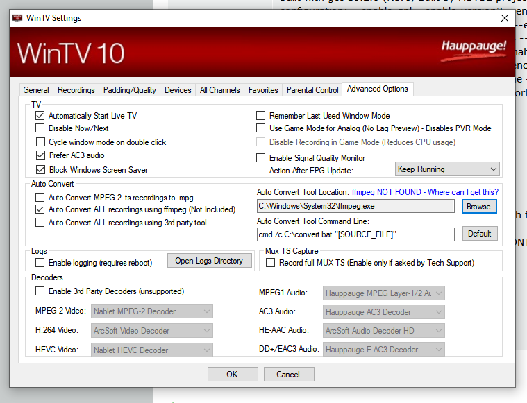

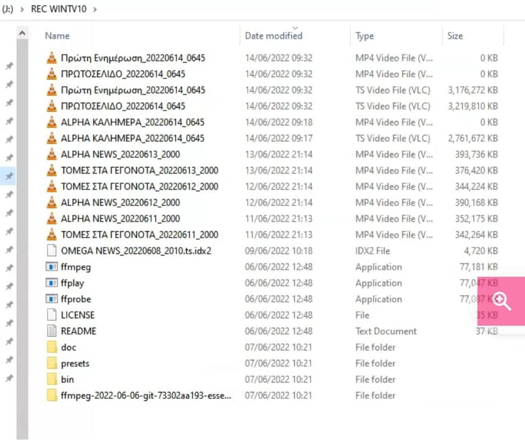

  14. Yes, I thought you were using a batch file. It may be possible in your program to change the Auto Convert Tool Location to use C:\Windows\System32\CMD.EXE, then set the Auto Convert Tool Command Line to point to a batch file and provide the filename:
    /c c:\batch\convert.bat "[SOURCE_FILE]"
    The batch file would have to look something like:
    "c:\path\to\ffmpeg.exe" -i "%~dpnx1" -f mp4 -vcodec libx264 -preset veryfast -crf 25 -profile:v main -acodec aac "%~dpn1.mp4"
    del "%~dpnx1"
    goto end
    :DONTDELETE
    echo didn't delete
    :END

  16. Originally Posted by neroman00 View Post
    Thanks but unfortunately a (.bat) batch file requires each command to be on a separate line and Auto Convert Tool Command Line DO NOT accepts separate command lines but only a single command line.
    The program calls a single command line:
    cmd /c c:\batch\convert.bat "[SOURCE_FILE]"
    It has no idea what that command line is doing or how many lines are in the batch file. Just like it has no idea what ffmpeg really is doing.

  18. The tool location should not point to ffmpeg. It should point to c:\windows\system32\cmd.exe. The command line should not include the initial cmd. Just the part from /c to the end.
    Dear jagabo
    I tried do that. Tool location point as you said but when I do the change and press ok for this change, then by going back to recheck the amendment then the tool location rolling back to point to ffmpeg.
