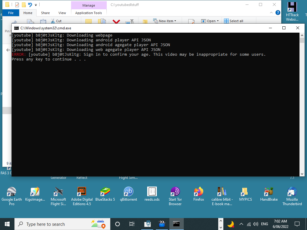

    But I got that same problem. Wonder why if you didn't? Country specific maybe? I'll try vpn.
    [Attachment 65217 - Click to enlarge]
    p.s. Yep. Country specific. I'm in Aus. We're slaves here. Unknowing dumb slaves.

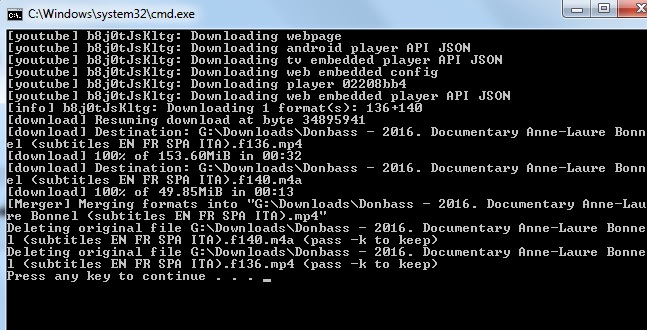

    Comparing your CMD report to mine produces some differences.
    I just wonder if the latest version of yt-dlp has broken the system as it has in the past. I am using v 2022.4.8.0.
    So here is the docu as well. (The other thing is to ensure that you rename youtube-dl.exe (in the same folder) before renaming yt-dlp else TVDownloader will use the wrong program)

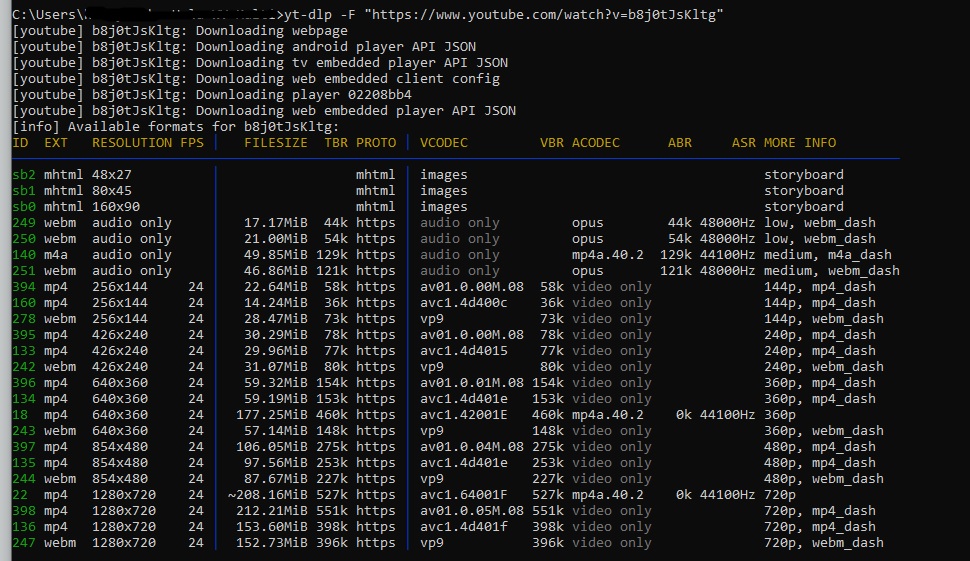

    No. I do not have a Y/T login, but download weekly from there inc age gated stuff. Age gate is superfluous with yt-dlp.
    With the OPs url, I too get the age gate warning but the formats command gives this:
    [Attachment 65232 - Click to enlarge]
    So to download the 'best' available (with ffmpeg in same dir) the syntax is:
    yt-dlp -f 398+140 "https://www.youtube.com/watch?v=b8j0tJsKltg"

    Ok. But how do you explain the variation between the OP's CMD and mine. And both appear to be created by yt-dlp ? (youtube-dl, atleast the version I was using before I switched, was different.)
  12. OPs downloading some sort of age gate player, although he was using youtube-dl wasnt he DB ?
    "downloading android ageplayer API json
    downloading web ageplayer API json"
    Your yt-dlp preamble mentions no agegate players in the API

    @codehound
    thanks for that command. I used it and it worked perfectly.
