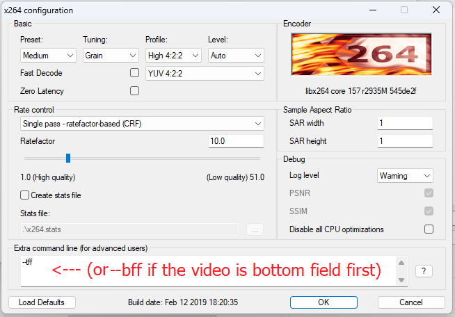

You should reencode the interlaced file you've got to a more modern format such as AVC or HEVC (still interlaced).
VirtualDub2 workflow:
Since I had never worked with DV files I am not sure if they are top field or bottom field first. I recommend you load the deinterlacing filter (video->filters->deinterlacing), then select "bob" -> double frame rate, top field fist. if the motion on the second video window looks weird (jiggering), then it means that your video is bottom field first.
The last thing that you should do is to encode the video. Use the x264 10-bit and these settings
[Attachment 65214 - Click to enlarge] -

@ballboy, if you want to keep your equipment and your process but you do not like the bitrate, then you have to re-compress. Using a different capturing program will make no difference aside of a possibly different container. Whether you want to do other processing besides re-compression, like deinterlacing, depends on the intended usage.Last edited by ConsumerDV; 5th Jun 2022 at 18:40.
S-MP, I'm having all sorts of trouble with those settings of yours:
- You haven't mentioned the file extension for saving.
- "-bff" (or as you have it "-tff") throws an error; remove it and the export works (and yes, PAL DV, at least, is BFF)
- I get FFMpeg error messages every time I try your X264 parameters
- Your QF 10 gives a file size 30% larger than DV
- You've not mentioned what to do with the audio. For example, MP4 will not accept PCM.
I suggest that, if you are going to propose solutions, you cover all bases so the newbys don't get even more bamboozled.
ALSO ITS --bff and --tff with two dashes, not one.
I see you're using 4:2:2 in your export.
Code:-x264opts interlaced:tff=1
