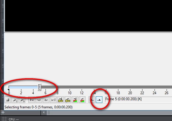

    Just open this in Virtual Dub, trim the end off (put the Play marker/cursor on your desired length and click the black right-pointing arrow; the selected bit will turn blue) and Save Video... with Video>Direct Stream Copy. You'll get an AVI. If you want to encode it to another coded (VP6), go to Video>Full Processing mode

  4. Or with only VirtualDub2:
    1) Start the program.
    2) Select Tools -> Create Test Video, then 640 (640x480) and One of the test types (we're going to filter it to all black so it doesn't matter which).
    3) Video -> Filters, then Add... Add the Brightness/Contrast filter. Move both sliders all the way to the left. You should now see a black output pane.
    4) Video -> Frame Rate... enable Change Frame Rate to... 25.
    5) Use the Mark-in and Mark-out tools (aka Edit -> Set Selection Start and Edit - Set Selection End) at the main window to select the length you want (as shown in Alwyn's image).
    6) Audio -> No Audio.
    7) If you have a VP6 VFW encoder installed it should show up in Video -> Compression. Select and configure it. If you don't, just leave the compression set at "uncompressed RGB/YCbCr" (and use your other method of converting to VP6).
    8 File - Save Video... Select a location and name, then save.
