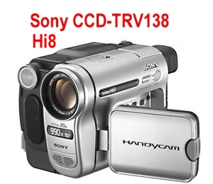

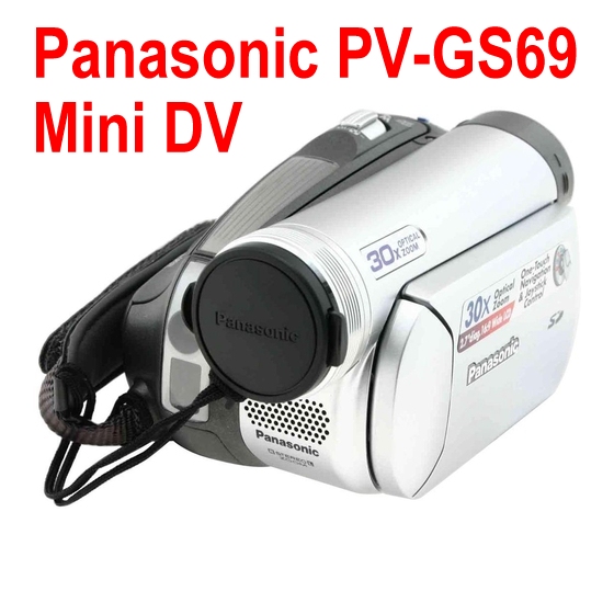

    I only have this Mini DV and this analog Hi8.
    I think this MiniDV only has outputs and not inputs.

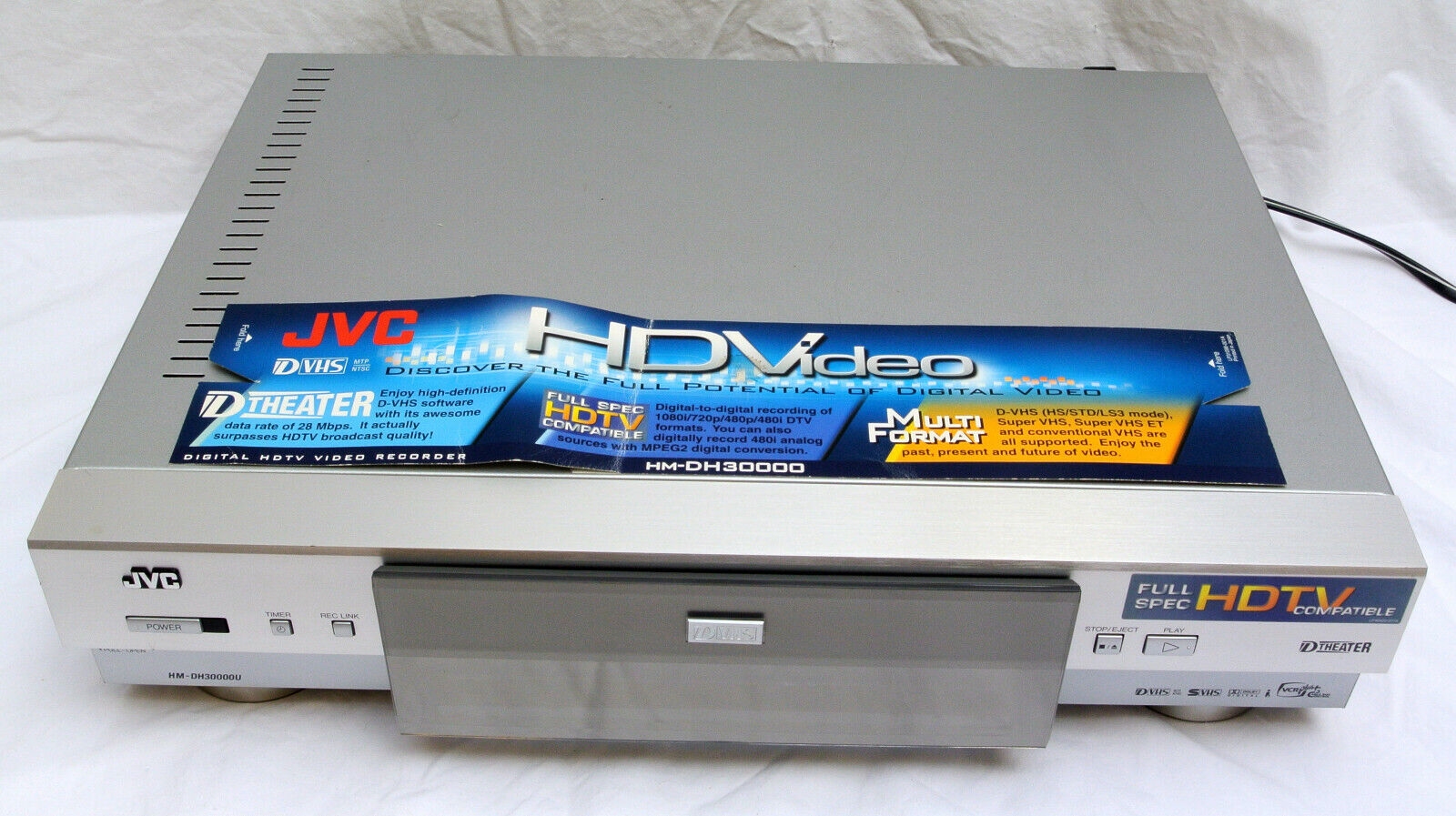

    I have this one. I think all I need now is a capture card that is compatible with it, as neither my DVD recorders or my pinnacle 700 pci do not support its i.link output.
    [Attachment 65164 - Click to enlarge]
