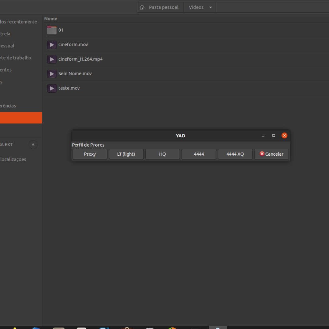

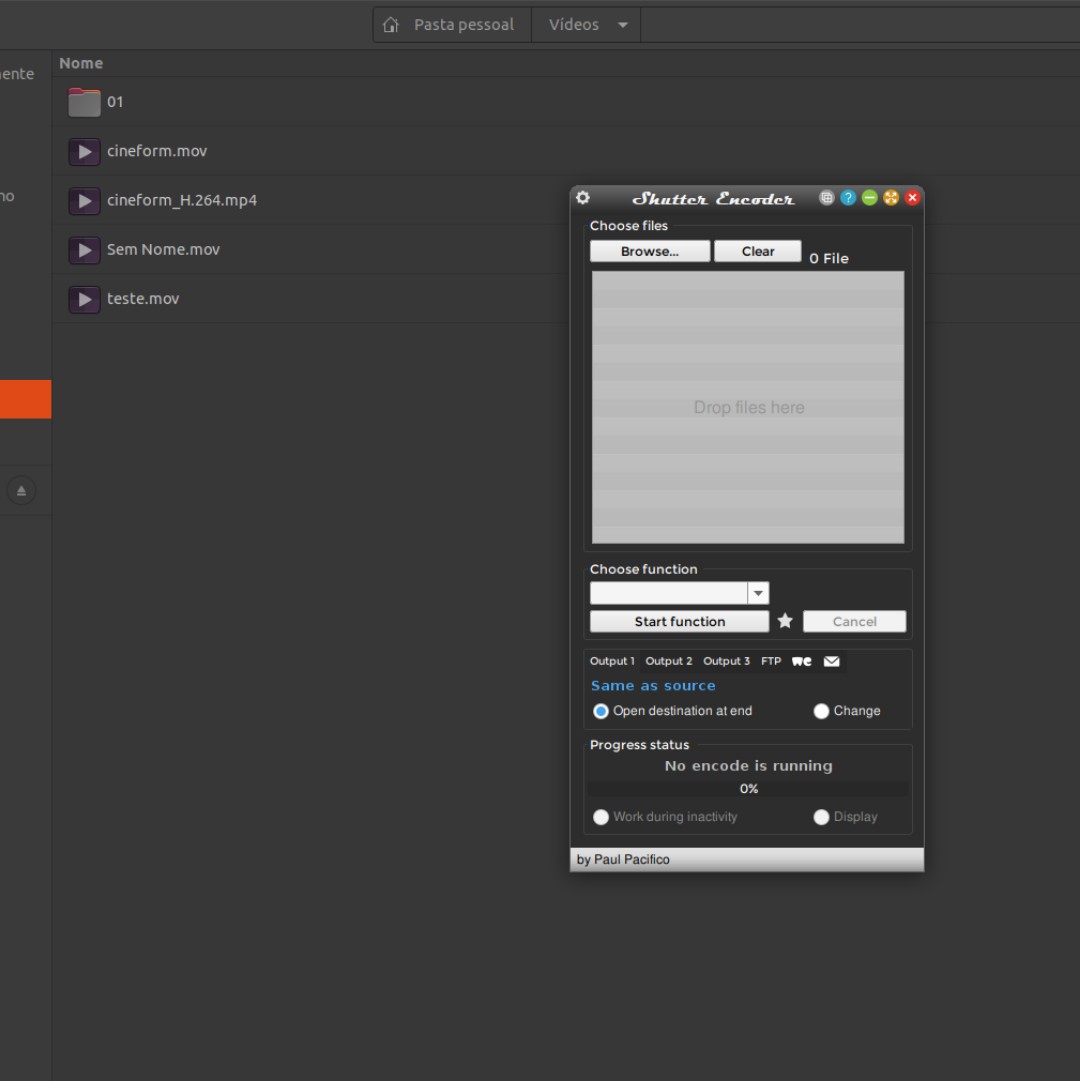

    Thanks october262 for your feedback/suggestion, i just wanted to convert some file to prores, since then i found out shutter encoder that does that and more, but if anyone is interested theres a quick GUI/script @ https://sourceforge.net/projects/prores4linux/files/
    [Attachment 65074 - Click to enlarge]
    [Attachment 65075 - Click to enlarge]
