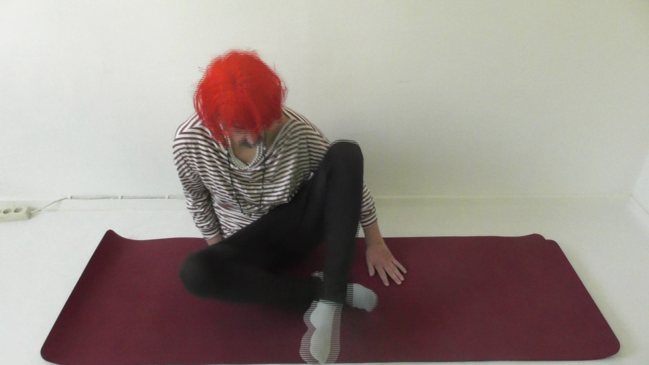

  5. Just for clarification: my dancing moves is not blurred, they are "striped" or "sandwiched" if you will. Well maybe I should try lightening equipment then after all. Thanks for enlightening me
    see also attachment

  6. Use 50p mode if you don't want to bother with deinterlacing.
  7. It IS recorded at 50 frames
  8. Originally Posted by TheSwant View Post
    No, it is not.
  9. You're right it's not. But how could you tell from a png-file?
  10. Originally Posted by TheSwant View Post
    Combing. Maybe this short video can help. Old camcorders could shoot interlaced video only. In your case, you can switch to 50p mode, "p" meaning progressive scan or frame-based. Interlacing is old-timey tech.
  11. That's interlacing. You can deinterlace it with handbrake, by switching to yadif, Bob and 50fps constant in the framerate settings

  13. So if I understand this correctly: If I shoot at 50 f/s, I don't get problems with horisontal strips?
  14. Originally Posted by TheSwant View Post
    Correct.
  15. Originally Posted by TheSwant View Post
    you might as well also deinterlace the ones youve got
