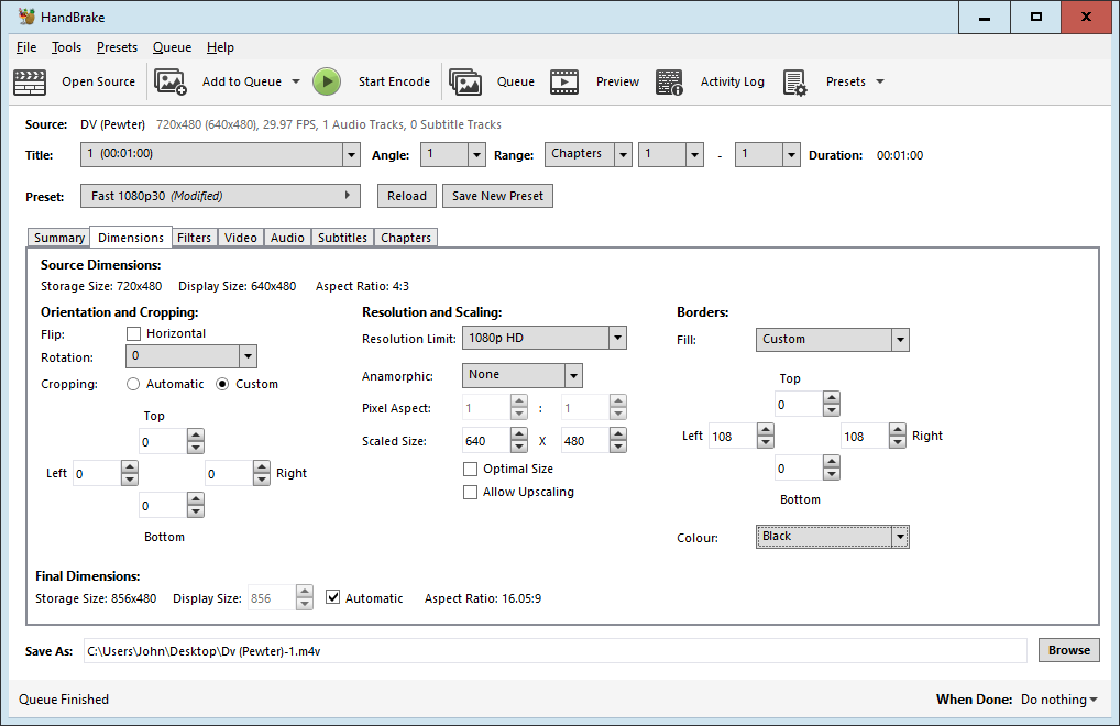

    So it's not a full featured NLE. Handbrake can pillarbox and save. Here's an example for an NTSC 4:3 source:
    [Attachment 65017 - Click to enlarge]

    jagabo: I tried using Handbrake, and it seems the program can only create MP4 files, which I can't use. VideoReDo will only accept .mpg and .vob files.

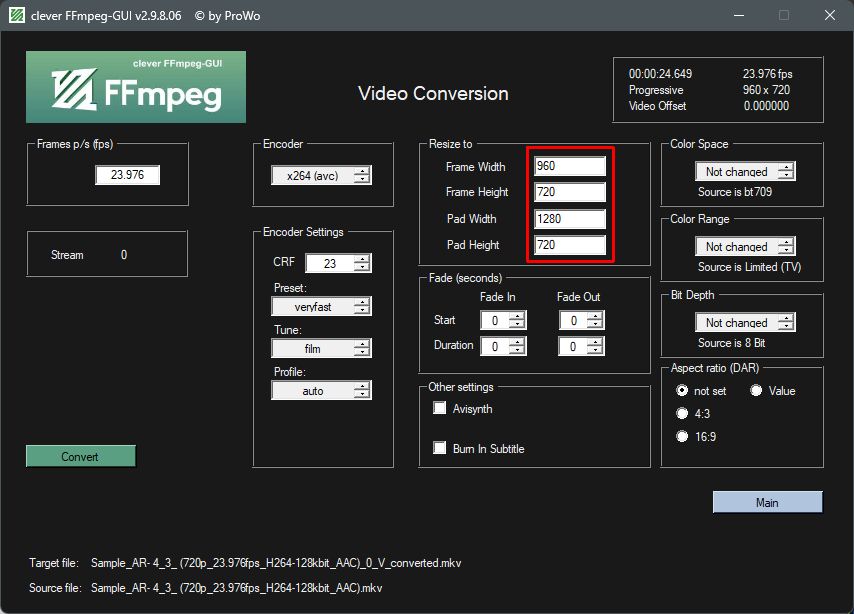

  10. Use clever FFmpeg-GUI.
    Load your file, click main, click video conversion, click resize, set Pad Width and Pad Height according your desired target video (in my example target is 1280x720, source was 960x720 (4:3)), select the desired encoder and click convert.
    [Attachment 65024 - Click to enlarge]
    If done, click multiplex, the new created videostream is shown in green, click multiplex.
    If done, you have a new 16:9 video with black bars left and right.

    Prowo: I downloaded FFmpeg-GUI and tried to install it, but I can't get the program to work. It says I need to download more files (FFmpeg, FFprobe and FFplay), but when I click on the link it just takes me back to the same download page, and those files are not available for download.
  12. Download ffmpeg here in the software section

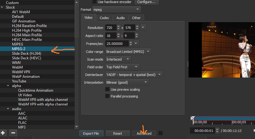

    Start the project as new, and the first thing to do is to set the video mode (making sure to set "Pal" or "NTSC" appropriately).
    Then add your source and export

    davexnet: Here's what happens with Shotcut... Everything is fine until I try to export. If I select the MPEG format, it creates an .mpg file, but it's MPEG-1. If I select the mpeg2video format, it creates an .m2v file. If I select the VOB format, it creates a .vob file, but there' no sound. I don't know what else to try.

    I'm runnning the latest beta, not sure if there s any difference
    https://github.com/mltframework/shotcut/releases/download/v22.05.23/shotcut-win64-220523.exe

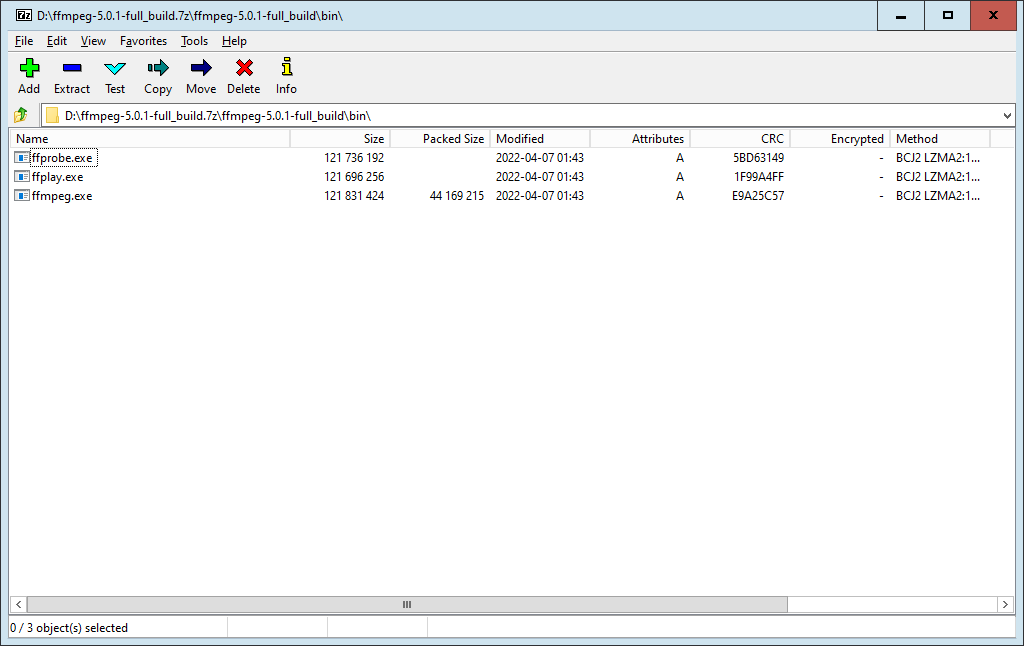

  21. Originally Posted by rw1954 View Post
    ProWo: Where can I download FFProbe and FFplay?
    They're usually included with ffmpeg. The archive downloaded from this site includes them.
    [Attachment 65036 - Click to enlarge]
