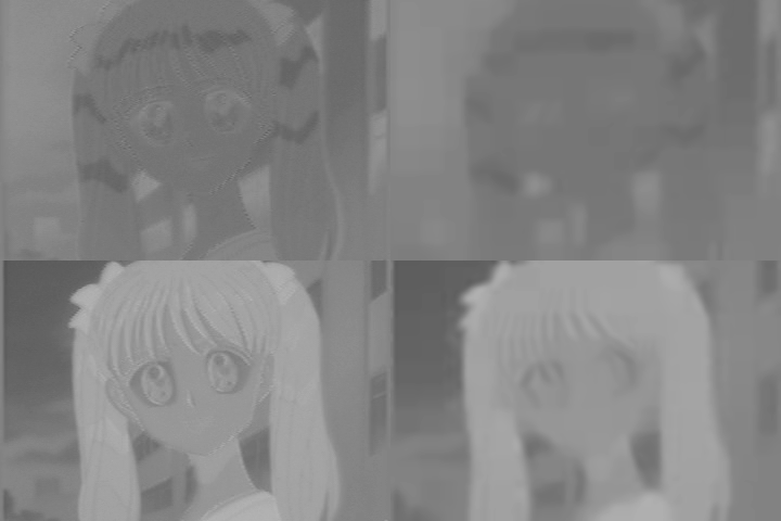

    That's totally destroying the chroma. Clip1.mkv, U (top) and V (bottom) planes, original on left, after FFT3DFilter(sigma=40.00,plane=3) on the right:
    [Attachment 65474 - Click to enlarge]
  12. yup

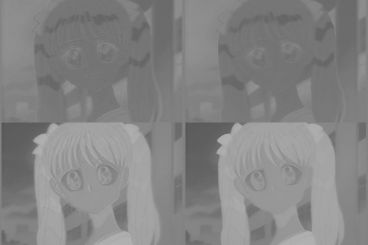

  13. Here's what I came up with:
    LWLibavVideoSource("clip1.mkv")
    AnimeIVTC(mode=2,bbob=4,degrain=3,normconv=False)
    BilinearResize(480, height)
    DeRainBow(threshold=20, bfactor=1)
    MergeChroma(aWarpSharp2(depth=5), aWarpSharp2(depth=15))
    SMDegrain (tr=2, thSAD=200, refinemotion=true, contrasharp=false, PreFilter=4, mode=0, truemotion=true, plane=4, chroma=false)
    FineDehalo(rx=2.5, ry=2.0, BrightStr=1.5, DarkStr=1.5)
    nnedi3_rpow2(2, cshift="Spline36Resize", fwidth=720, fheight=480)
    aWarpSharp(depth=5)
    Sharpen(0.5, 0.3)

    There's much less damage to the chroma. Clip1.mkv, U (top) and V (bottom) planes, original on left, after FFT3DFilter(sigma=40.00,plane=3) on the right:
    [Attachment 65480 - Click to enlarge]

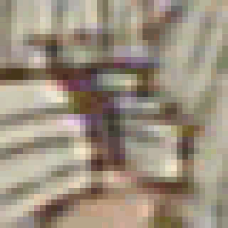

  15. I thought he was talking about this (8x point upscale):
    [Attachment 65482 - Click to enlarge]
    That's back and forth between two frames from the boy's white shirt with black stripes. The green/magenta discolorations are from high frequency luma interfering with the chroma carrier of a composite signal.
    I'm not absolutely sure, but I think I wrote the derainbow filter I used above.
  16. Yup and I was looking at these:
    Cu Selur
  17. Yes, very different phenomenon. I guess we'll have to wait for the OP to clarify.
  18. Yup.

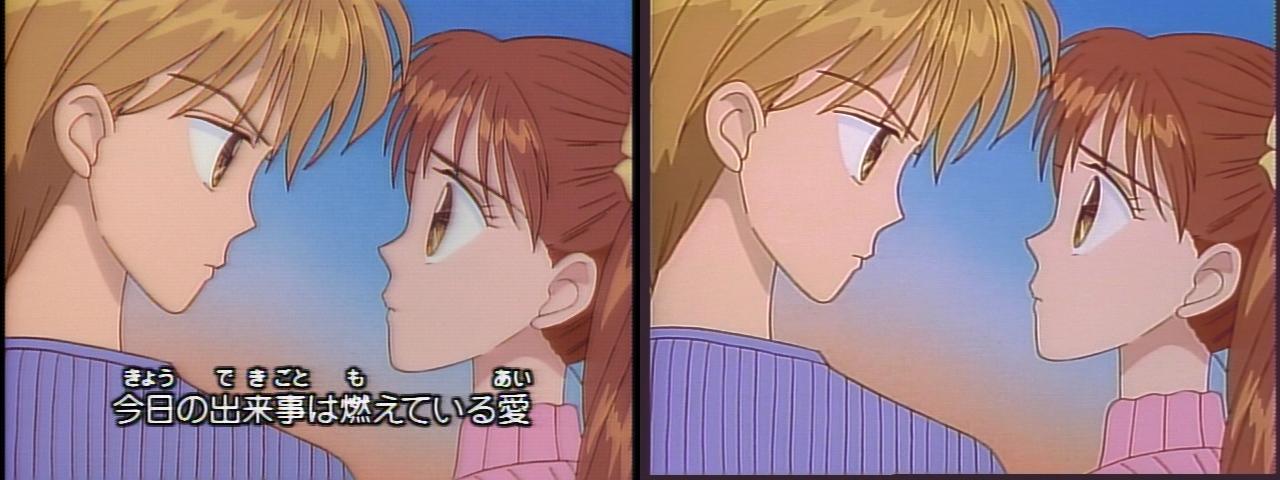

  20. So, unrelated to the main thing, but i want some help.
    The only creditless version of the opening i can find is from a Laserdisc copy of the series, and that version doesn't have the exact colors of the DVD.
    How can i fix this?
    ep_file = "EPISODE 01.mkv"
    op_file = "LASERDISC EXTRAS.mp4"
    ep = FFVideoSource(ep_file).Spline64Resize(640, 480)
    op = FFVideoSource(op_file).Spline64Resize(640, 480)
    op = op.Trim(7351,10073)
    #op = op.Levels(0,1,210,0,255)
    #op = op.ConvertToRGB32(matrix="Rec601").RGBAdjust(r=251.0/246.0, b=251.0/238.0).ConvertToYV12(matrix="Rec601")
    #op = op.Tweak(hue=50,bright=20,sat=1)
    ep = ep.Trim(0,op.FrameCount-1)
    StackHorizontal(ep,op)
  21. users currently on my ignore list: deadrats, Stears555, marcorocchini
  22. One needs a wider variety of colors and levels (especially some large patches of full blacks and middle greys). But this is a fairly close:
    right = right.ColorYUV(gain_y=-85, off_y=122, gamma_y=-150)
    right = right.ColorYUV(off_v=4).Tweak(hue=3)
    right = right.Tweak(hue=55).ColorYUV(cont_u=25, off_u=5).Tweak(hue=-55)
    Where right is the right half of the image.
    [Attachment 65624 - Click to enlarge]
  23. Originally Posted by jagabo View Post
    Oh, thanks.

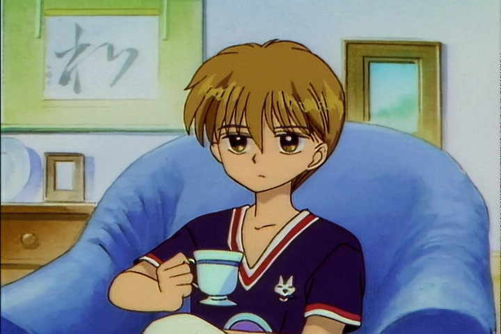

  25. I now did get the BD of the series and strangely, my TComb line doesn't work on this frame here.
    What TComb can i use now?
    Here's the original line
    Tcomb(mode=2, fthreshl=4, fthreshc=5, othreshl=5, othreshc=6, map=False, scthresh=12.0)
    Also some suggestions for the halo too.
  26. That's not a lot to work with but here's a first approximation:
    ImageSource("bd_ep19_f1.png", start=0, end=23, fps=23.976)
    ConvertToYV24()
    Overlay(last, last, x=6, y=0, mode="subtract", opacity=0.07).ColorYUV(gain_y=20)
    dehalo_alpha(rx=3.0, ry=3.0, BrightStr=1.1, DarkStr=1.0)
    [Attachment 65707 - Click to enlarge]
  27. Originally Posted by jagabo View Post
    ConvertToYV24()
