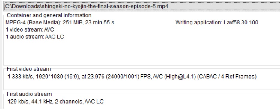

i need to convert an anime episode to 720p. this is the media info of the source file:-
[Attachment 64970 - Click to enlarge]

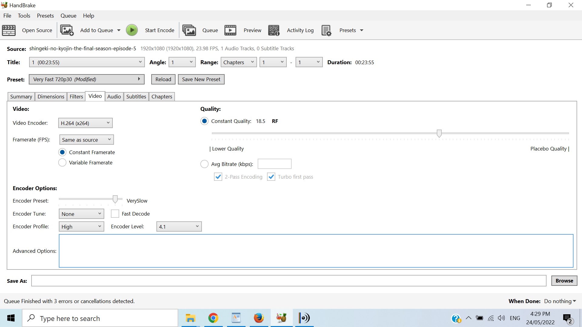

this time i used constant quality in handbrake to do the encoding. this is the settings that i used:-
[Attachment 64973 - Click to enlarge]

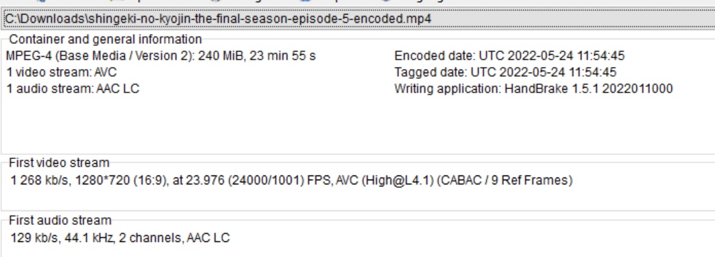

this is the media info of the encoded file:-
[Attachment 64974 - Click to enlarge]
will there be loss of quality in the encoded file like what happened before when i was experimenting?

Since you are using a lossy compression, your encode will naturally be lossy.will there be loss of quality in the encoded file like what happened before when i was experimenting?users currently on my ignore list: deadrats, Stears555, marcorocchini
It should be better, as you've gone from 900kbps to 1268kbps. Whether that is a large-enough increase to improve the background to an acceptable quality, you'll have to compare.will there be loss of quality in the encoded file like what happened before when i was experimenting?

No, "better" was the 1268 version compared to the 900 version, obviously not the 1268 (or 900) to the 2250.Correction, @Alwyn, there MAY BE LESS LOSS. Big difference.

regardless the fact that every re-encoding with a lossy codec does not preserve the original "quality" (the resulting video with good settings might be perceptually identical quality wise, but something will be different, anyway) .. you are not simply re-encoding the video (using a different bitrate).. you are also downscaling it from 1080p to 720p (losing 1/3 of the original information).. So.. every pixel will be different in the re-encoded file (every pixel will be re-interpolated to obtain 2/3 of the original ones). It's a very destructive process, you will lose a lot of information and the quality of the new video will always be ways lower, even with optimal settings..
If you watch the 720p video on a 1080p tv it will look good as long as the original was good,then watch the the 720p on a 2160p tv then you will notice the difference,so if you are never going buy a uhd tv then it won't matter.
