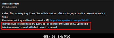

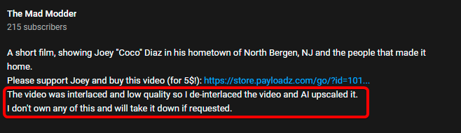

    Uploader said "The video was interlaced and low quality so I de-interlaced the video and AI upscaled it."

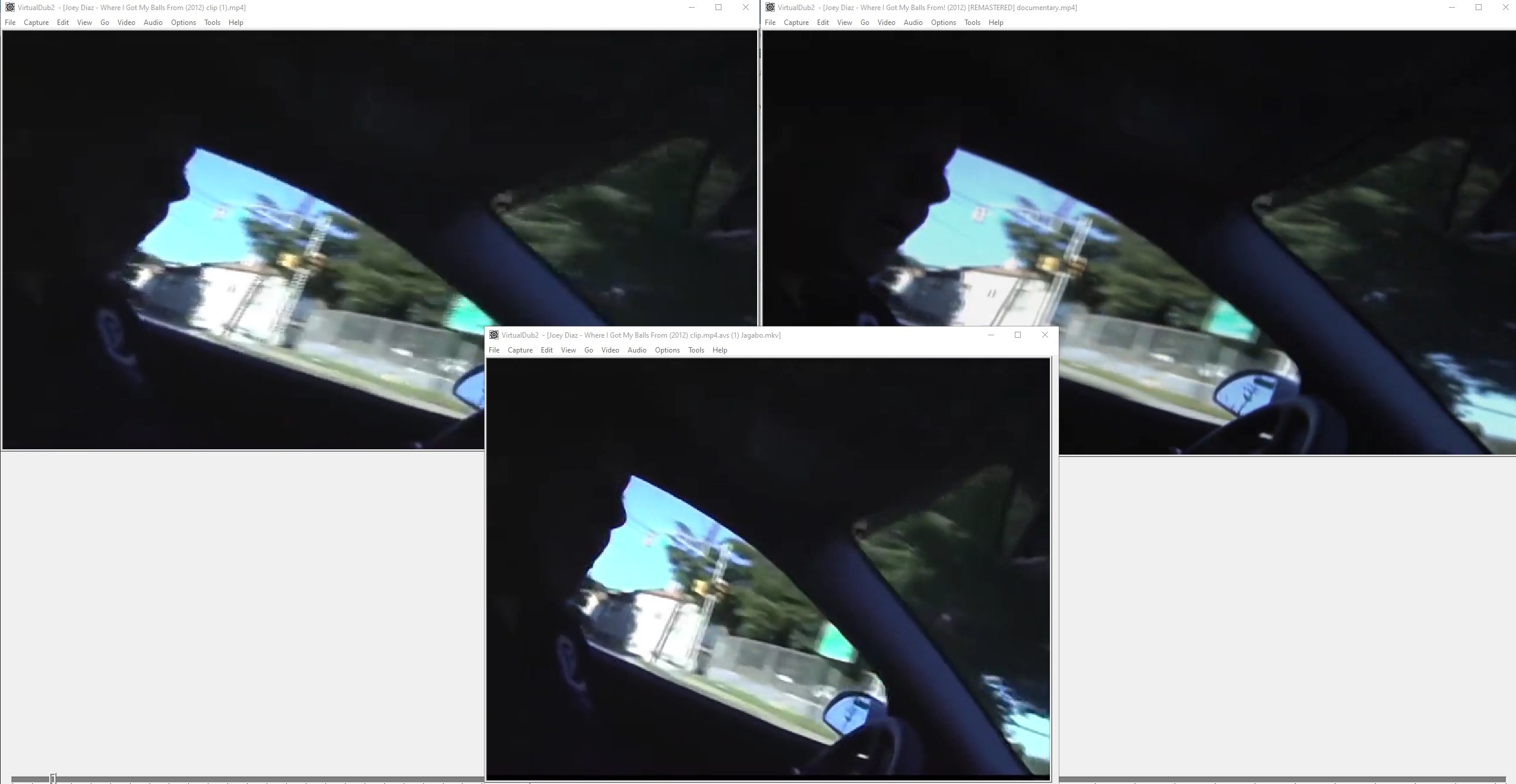

    This is what I think it should look like (first 10 minutes). I've made the outside-scenes video 4:3 and left the speech video and titles "as is", all in a 1280x720 16:9 frame. Did this is my video editor.
    They have fixed the interlacing (Jagabo's at the bottom):
    [Attachment 64865 - Click to enlarge]

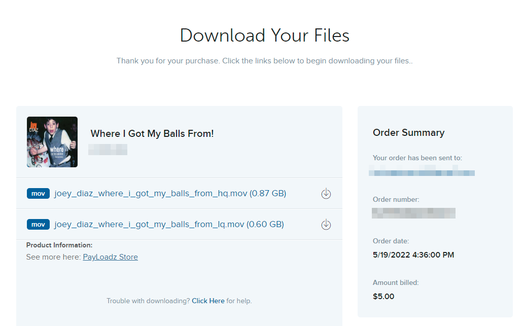

    Joey Diaz's tweet said the movie can also be bought from here https://store.payloadz.com/go/?id=1016064 and yes you are right it is $5 USD.
    Description of the movie says:
    There are two files available to download. The one labeled HQ is the higher quality and LQ is a lower quality video. There's no difference in the content at all. Also, neither video is over 1 GB but they could take 30 minutes or more to download depending on your internet speed.

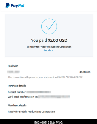

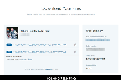

    EDIT:
    Just bought the movie

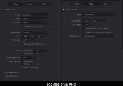

    I used Davinci Resolve to export the clip and these were the export settings I used:
