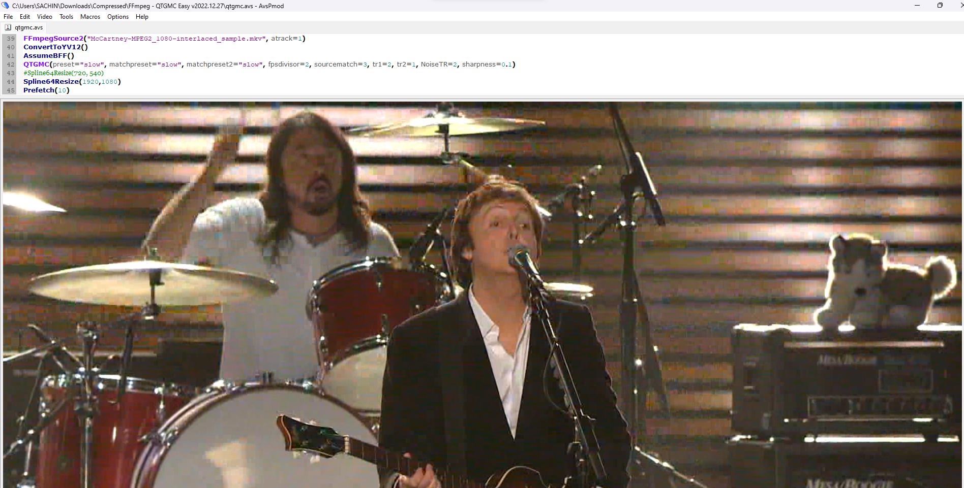

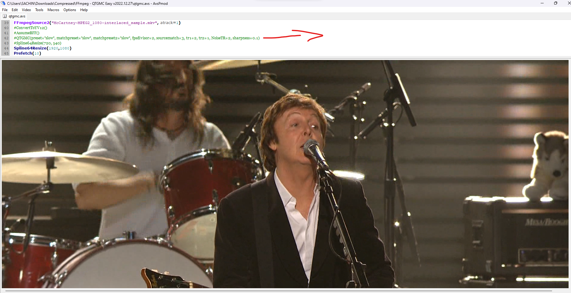

  30. SetFilterMTMode("QTGMC", 2)
    FFVideoSource("McCartney-MPEG2_1080-interlaced_sample.mkv")
    ConvertToYV12(interlaced = true)
    AssumeTFF()
    QTGMC(preset="slow", EdiThreads=3, matchpreset="slow", matchpreset2="slow", fpsdivisor=2, sourcematch=3, tr1=2, tr2=1, NoiseTR=2, sharpness=1.2)
    Spline64Resize(1920,1080)
    Prefetch(10)
    BUt still not getting the proper result
