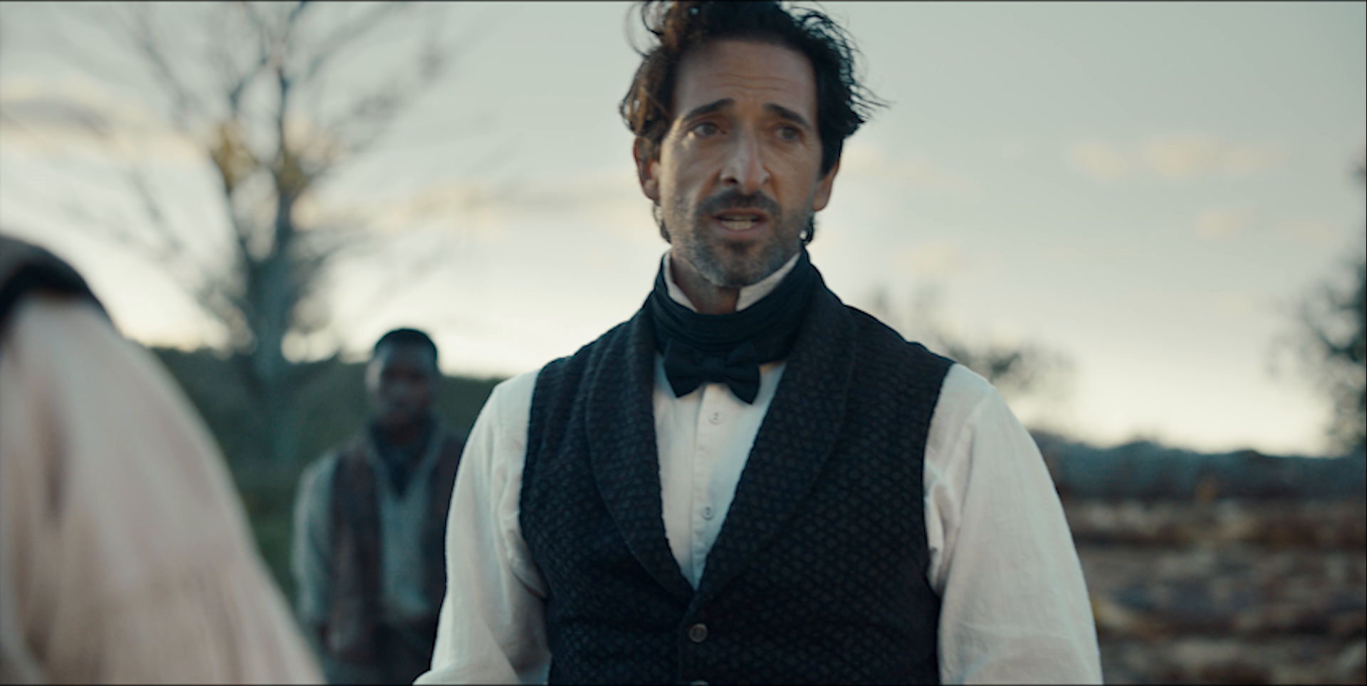

  1. this is the original video screenshot:
    https://i.imgur.com/rJGSvwJ.png

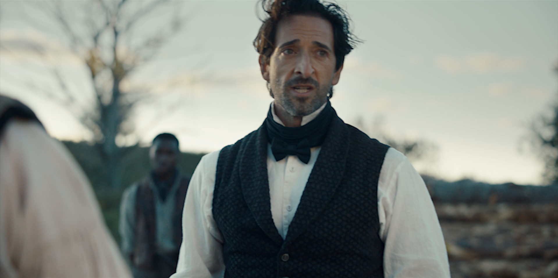

    i crop the image to
    1918(right side 2px)x960
    https://i.imgur.com/1yfKmb1.png
    1918x958
    https://i.imgur.com/omCHIXl.png
    1918x956
    https://i.imgur.com/kwWZQ3y.png
    which dimension is correct to crop, any suggestion please? i am new with video cropping and editing, so i am looking for suggestion. i assume i cannot crop 958. top side crop either 60 or 62

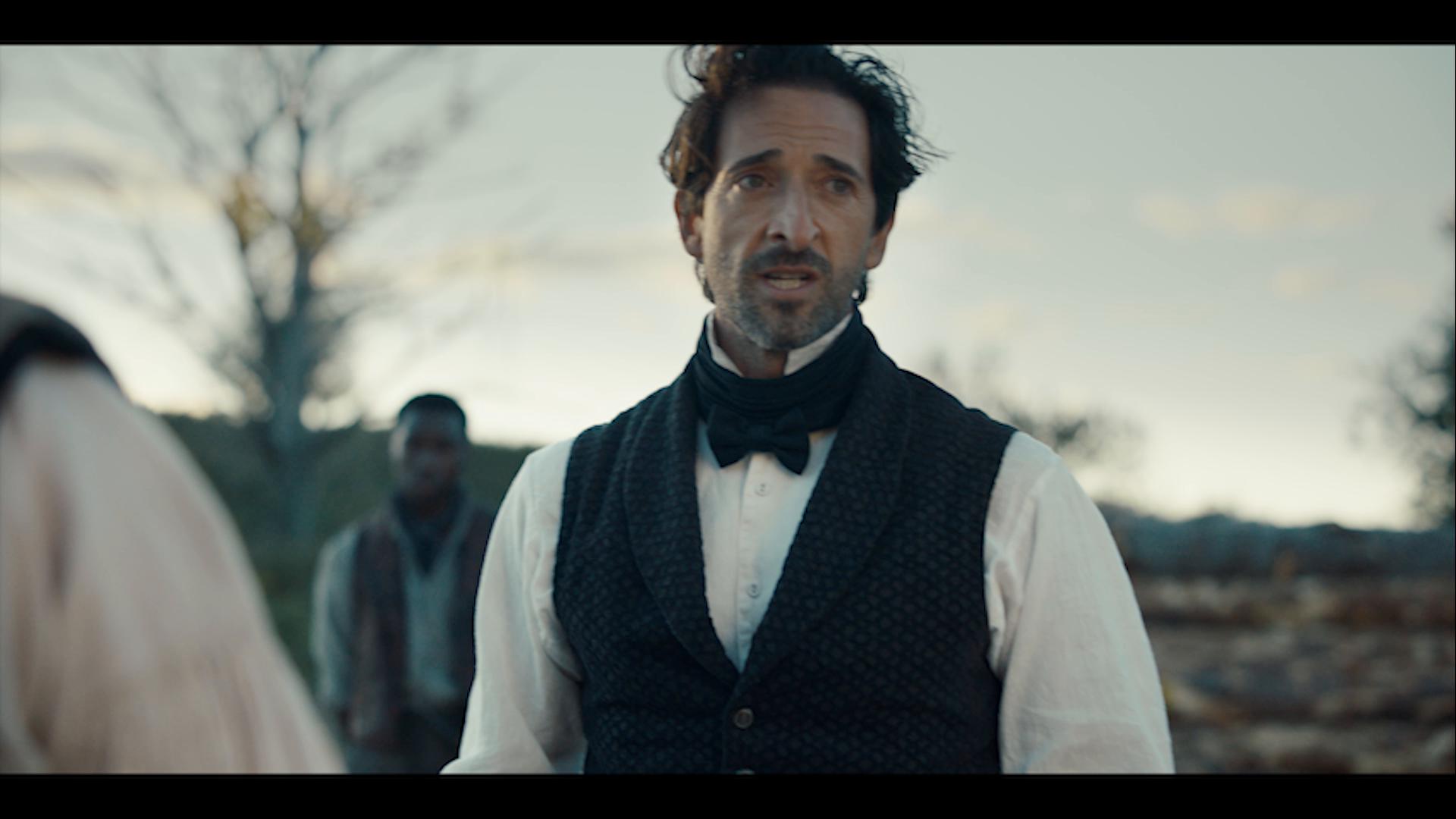

  5. If you want the widest compatibility avoid mod2 sizes. Use Mod4 or higher. YV12 (most video, YUV 4:2:0) cannot be cropped mod1. I'd copy that video to 1920x964.
  6. this is 1920x964
    https://i.imgur.com/YkKdB5F.png
    there is at least 2px black border top and bottom. and right side 2px border. any particular reason to keep that?
  7. Originally Posted by iKron View Post
    1920 mod 4 = 0; 964 mod 4 = 0
