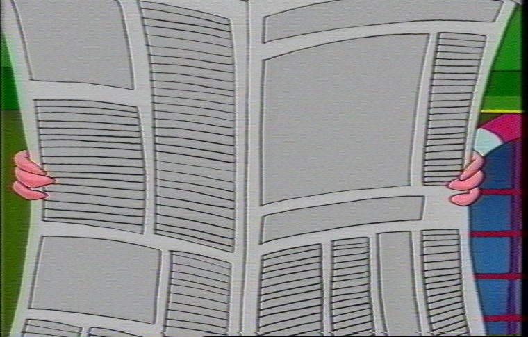

That's not the top, it's the bottom section that includes the head switch, If you take those lines away you end up with 480 lines, Most of the video contained in the head switch section is a repeat of the last few active lines.
[Attachment 64810 - Click to enlarge]

	The head-switch area isn't a repeat of the lines above it. It just so happens that in that specific screenshot, the whole area is animated to be flat brown, so it does appear that way. Head-switching causes a horizontal skew, but the information is still there:

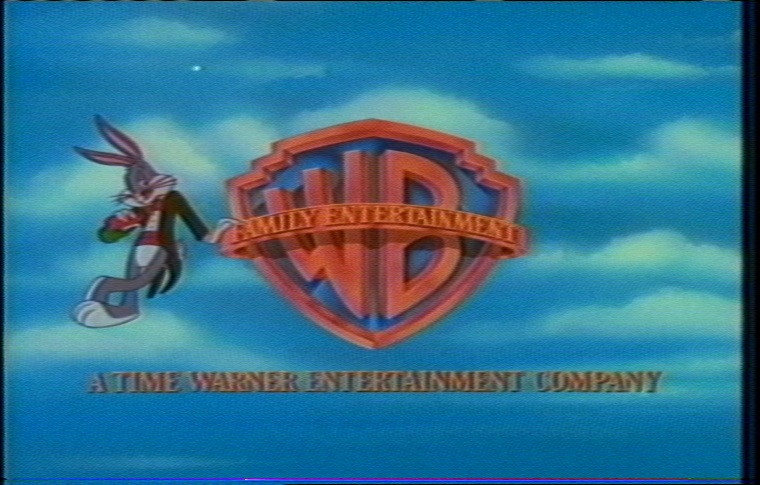

 Note the closed-caption line on the WB logo. The trailer itself has no captions, and puts active video on NTSC line 21. Yes, the extra 4 lines really are at the top of the image, not the bottom. A 480-line capture (at typical SMPTE RP 202 spec) would include the same amount of head-switching noise, just with the bottom half-line cropped off.

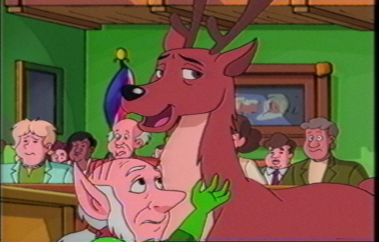

	As mentioned in my "geek fun" thread linked earlier, my solution these days doesn't have head-switching noise in the visible image anyway. I've adjusted the head-switch point to avoid the issue and obtain every possible clean line.
 These Reindeer samples are old files with default HSW point. I only brought up this specific video because I know you have it too, and you'd said that you've never seen useful video within 486's "top extra 6 lines that is reserved for signaling and other proprietary barcoding." Meanwhile, my copy has 4 complete video lines up there.
