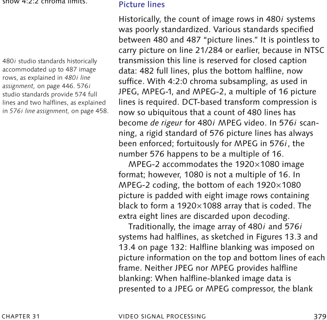

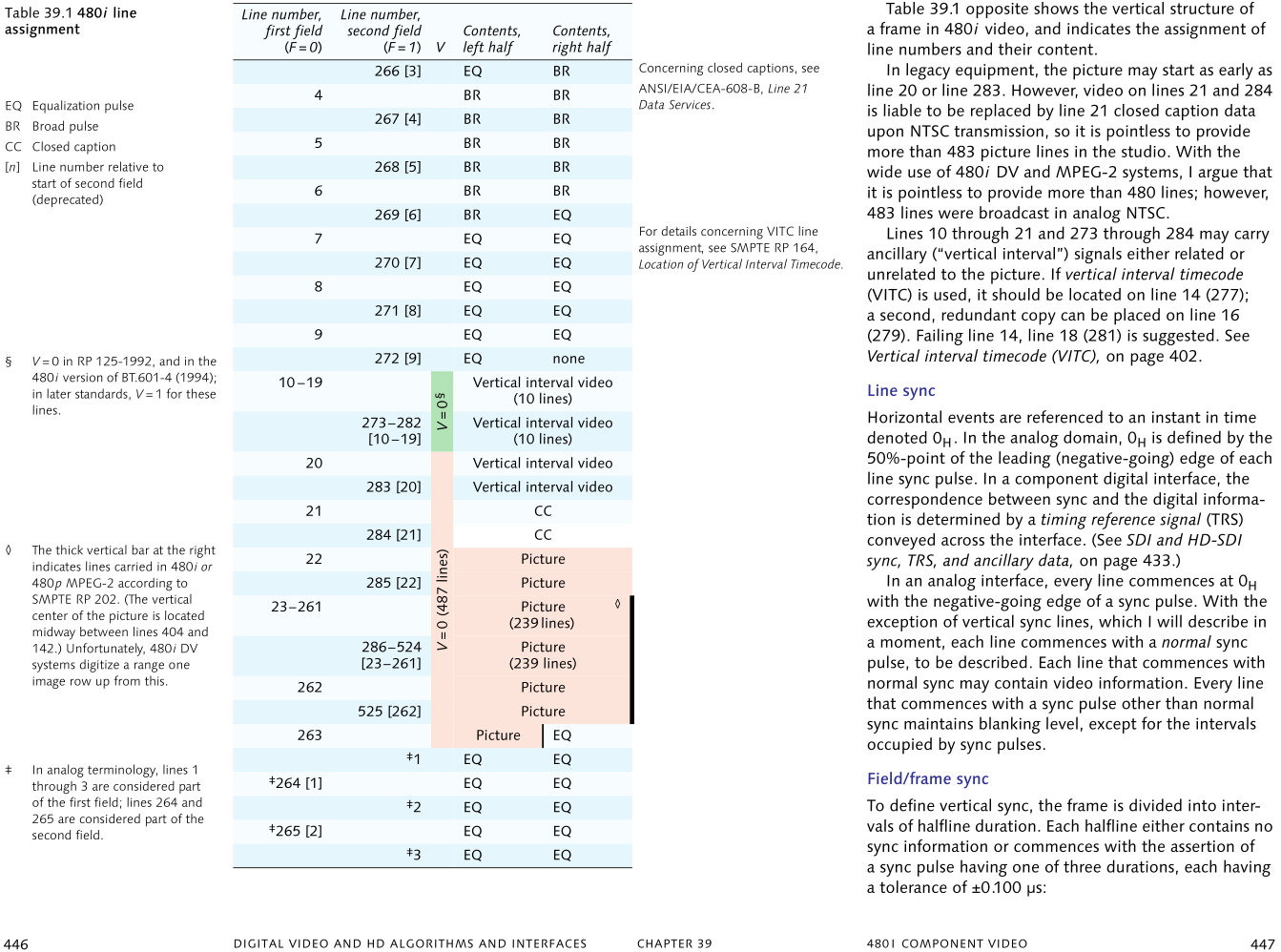

  24. Originally Posted by Brad View Post
    All of your questions are answered in a book [URL="https://forum.videohelp.com/threads/403503-What-exactly-is-the-purpose-for-the-16-to-235-luma-range-in-YUV-encoding#post2634938]
    Had you read the book, you would also know that this is wrong. There's only a half-line below a typical 480-line capture. All of the other extra lines in a 486-line capture are from above.

    I'm thinking in terms of archival. Not like making a quick digital video to post on YouTube, but rather a way of archiving the video as a digital master copy, that loses NONE of the original information that would have been present in the image portion of the signal (this means all 486 lines must be recorded). Yes, there can be useful informatino there. There are ways though you can store digital data on those 6 missing lines, in particular closed caption text data. Other types of digital data from various sources may also use these 6 extra lines for their own source-dependent metadata (maybe some professionally made VHS tapes would store metadata describing the content of the tape, or broadcast sources might have used it to store the call letters of the TV station). For the purpose of archiving tapes, 486 lines recording is essential, as it can be more than just image signal stored there.
    Professionals follow the professional rules, and those rules include:
    Don't use blanking lines for anything except the reserved values (e.g. CC, VITC, WS, program guide). So not just anything else added there.
    Don't put "essential" image info anywhere except safe area. So, nothing important around the edges.
    Use the most common pro standards for universality of interchange. So 486 is not expected to be as common as 480.
    Above all else: anything you/we are capturing off of consumer formats (vhs, etc) would almost never be considered "masters", unless that is the only format on which it exists (e.g. camera raw footage from home video).
    Even for archival you need to separate VBI from Video - unless you are using non standard (i.e. data on video lines).
    VBI is not video so to parse VBI use dedicated HW.
    Going with your way of thinking then for archival copying you need to store also VBI area i.e. stop recording video as video but record samples with sync pulses and remaining structure - for example Macrovision - it should be archived or exactly opposite - Macrovision shall be stripped from source?
    Where is border in accurate copy? At sync level, video samples? content?
  27. Originally Posted by Cornucopia View Post
    You are right about not using blanking for anything other than reserved values. However, those 6 lines I was describing are NOT blanking lines. Those are technically image lines, though they aren't safe from overscan. And guess what, many professional sources will embed digital data on one or more of those video lines. And consumer grade 480 height capture devices miss those, which means you can't say that your consumer grade device has truly archived the signal, as there's some missing signal on those 6 lines. Most sources won't include anything on those 6 lines (particularly consumer grade camcorders or other consumer grade video sources), but studio VHS tape production equipment certainly can (as can TV broadcast equipment), and many companies do use such equipment to include their own proprietary data on those video lines for home video releases on VHS (or even on TV broadcast, which may have been recorded by some people's VCR recordings to VHS). To archive and analyze recordings for such data embedded in lines of video normally not captured by 480 line capture cards, it's essential to make sure you are capturing all 486 lines.
  28. Originally Posted by pandy View Post
    Nonstandard isn't completely impossible. Sometimes copyprotection data is embedded in blanking areas of the video. In fact, if I remember right, not only does VBI and HBI sometimes contain copyprotection data, as people got more sophisticated in breaking copyprotection, some of the final versions of the Macrovision copyprotection actually altered the sync signals as well. They were altered just enough that a TV could still properly sync, but VCRs wouldn't be able to sync properly (due to VCR sync detection circuits usually being stricter in only detecting sync that stays on spec, while TV sync detectors are intended to pick up even poor quality signals so they can still detect the intentionally out-of-spec sync pulses). For the purpose of archiving a video source, ideally the entire source signal would be archived (all image, blanking, sync, absolutely everything) so that people could study the structure of such video signals (both in-spec signals, and signals with proprietary stuff added). It could make for an interesting study, but to make such a study possible, the equipment to capture the signals is needed first. Obviously that equipment would be likely expensive, but I wouldn't think that it would be too expensive to make a cheap capture card that could capture all 486 lines of video (even if it captured nothing else), and that itself would be an interesting study. See how many different companies sources embedded stuff in the video lines just outside of the normal 480 lines.
