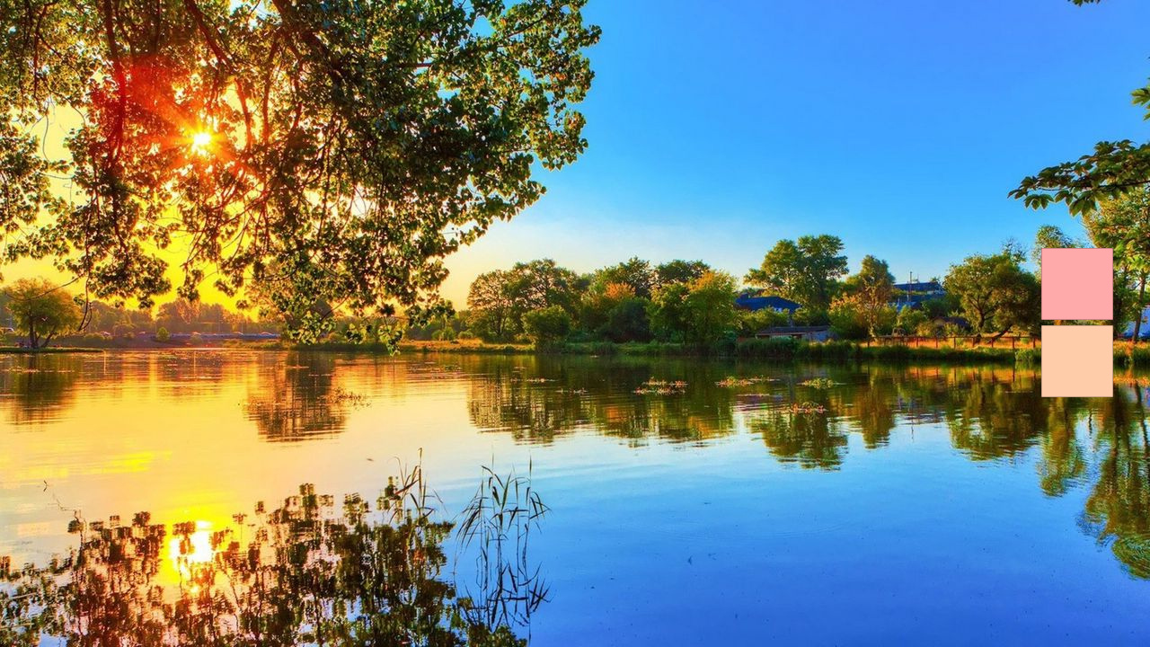

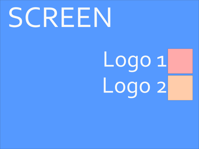

  1. I'm looking for a way to add logos/icons/images to the screen for 5 seconds at the beginning of the video, like this:
    [Attachment 64750 - Click to enlarge]
    I'm using this script that does what I need:
    clip1=LWLibavVideoSource("video.mp4").ConvertToRGB32()
    clip2=ImageSource("1432193.jpg").ConvertToRGB32().BilinearResize(1280,720)
    maskclip = ColorKeyMask(clip2, $00B140, 0)
    Overlay(clip1, clip2, mask=ShowAlpha(maskclip), mode="blend", opacity=1)
    On top of that I want to add two logos to the right of the screen, I did try something like the code bellow to se if it would show up:
    icon1=ImageSource("logo1.png").ConvertToRGB32().BilinearResize(80,80)
    icon2=ImageSource("logo2.png").ConvertToRGB32().BilinearResize(80,80)
    layer(icon1, icon2)
    Instead, the final video is 80x80 with the logo2.png on top, I also try "Overlay" but it end up with the exact same result.
    How do I do that?
    Thank you.
  2. Member Cornucopia's Avatar
    Remember that for many compositing processes with images (text is usually excluded here), all images' canvases/frames need to be the same size. So if you have an 80x80 logo sprite to overlay on top of a 1920x1080 video, you will need to apply borders to the 80x80 to expand it out to 1920x1080 (and you would also want to include additional padding with the mask, so that those borders don't show up).
  3. Video Damager VoodooFX's Avatar
    Oct 2021
    At Doom9
    Change "layer(icon1, icon2)" to:
    Overlay(icon1, x=50, y=200)
    Overlay(icon2, x=50, y=300)
    Adjust x y coords [top left corner] to your needs.
  4. Originally Posted by pokoloko View Post
    layer(icon1, icon2)
    What you are doing is overlaying icon2 onto icon1 and returning the result -- an 80x80 image that is just icon2. You want to layer each of the icons on top of the earlier video, which is named "last" since you didn't name it:
    # assuming last is the output of the previous code
    layer(last, icon1, x=?, y=?)
    layer(last, icon2, x=?, y=?)
    Set the x and y coordinates as needed.
    Remember, when you don't specify a clip by name the name "last" is assumed, both for input and output.
    Overlay(icon1, x=1159, y=276)
    Overlay(icon2, x=1159, y=362)
    [Attachment 64751 - Click to enlarge]
    PS: How to make that fadeout after 5 seconds at the beginning of the video?

    Thank you sir, works like a charm.
    layer(last, icon1, x=1159, y=276)
    layer(last, icon2, x=1159, y=362)

  8. This is the changes done to make the logo 1 and logo 2 to fadein and fadeout at the beginning of the video:
    icon1=ImageSource("logo1.png", start=0, end=150).ConvertToRGB32().BilinearResize(80,80).FadeIn(10).FadeOut(15)
    icon2=ImageSource("logo2.png", start=0, end=150).ConvertToRGB32().BilinearResize(80,80).FadeIn(10).FadeOut(15)
    Define the amount of frames (start, end) and set FadeIn, FadeOut at the end.
    Thank you all for the help.
