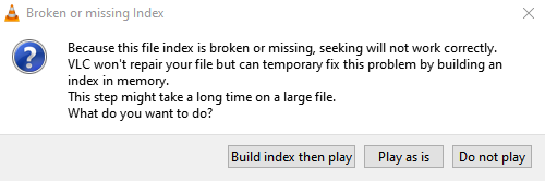

    So I setup VLC to capture the lot (about 40/50 mins of footage), to my horror when I returned to review the footage:
    [Attachment 64746 - Click to enlarge]
    I'm capturing with the following settings, I imagine they are all massively incorrect but I've given it a go:
     :dshow-vdev=OEM Device :dshow-adev=OEM Device  :dshow-aspect-ratio=14\:9 :dshow-chroma= :dshow-fps=25 :no-dshow-config :no-dshow-tuner :dshow-tuner-channel=0 :dshow-tuner-frequency=0 :dshow-tuner-country=0 :dshow-tuner-standard=32 :dshow-tuner-input=0 :dshow-video-input=-1 :dshow-video-output=-1 :dshow-audio-input=-1 :dshow-audio-output=-1 :dshow-amtuner-mode=1 :dshow-audio-channels=0 :dshow-audio-samplerate=0 :dshow-audio-bitspersample=0 :live-caching=300
    I've tried:
    • The 'Build index then play' option - Plays a minute of footage and then you can no longer scrub forward in the timeline
    • The 'Play as is' option - Plays the footage but you can't click about the timeline otherwise the image gets lost, also gets 'jittery' the longer it plays
    If theres anyone that can help provide a bit of a steer on this I'd be massively grateful, trying to do a favour and really struggling to find any resources for this issue

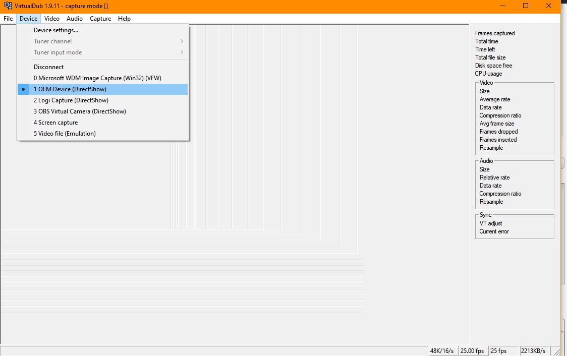

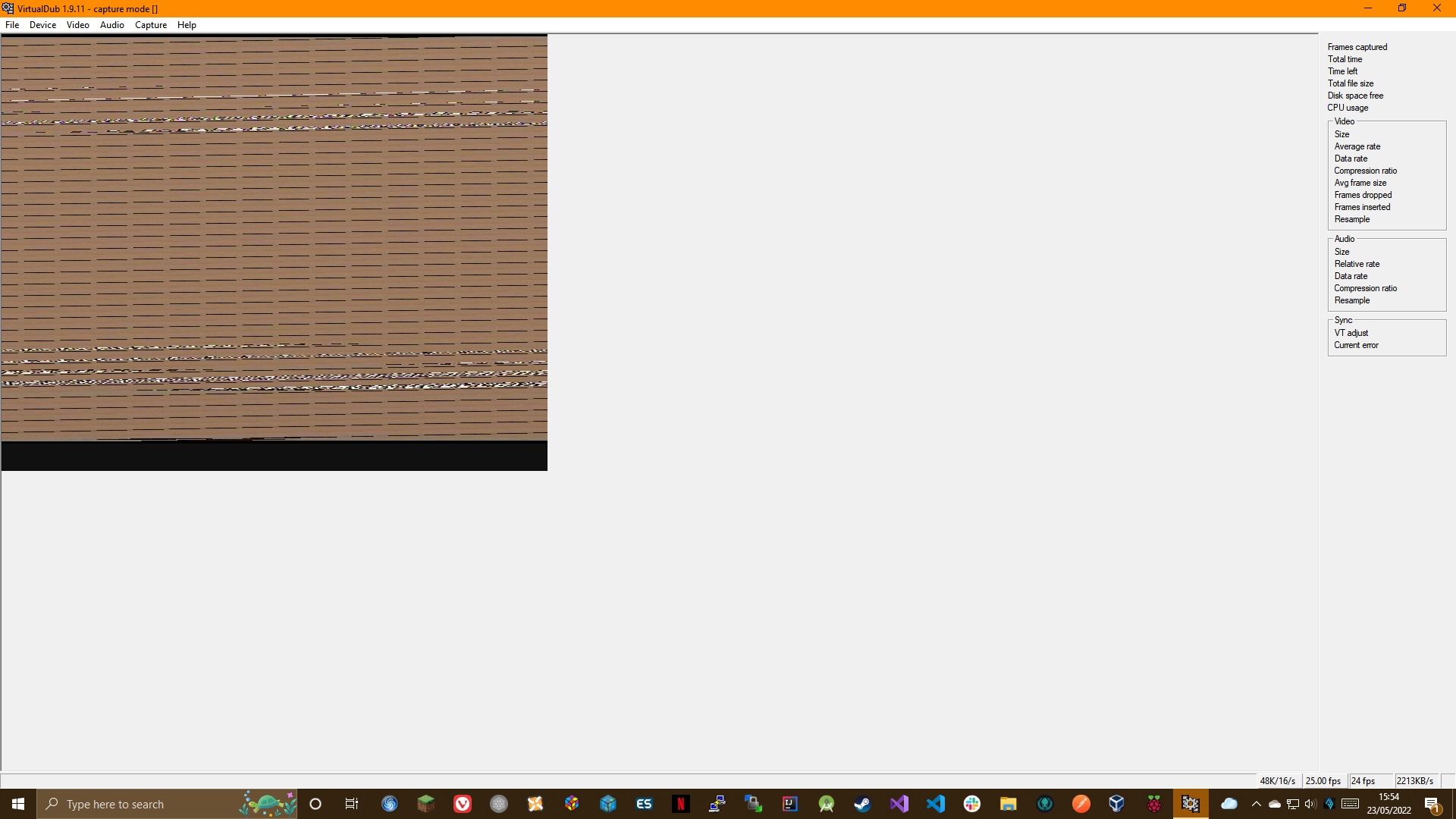

  8. Hi all,
    I've gone installed VDub from Alywn's links.
    Initially after unzipping and then opening for the first time it looked like it was semi there regarding capturing (Obviously choppy video needs fixing):
    [Attachment 64942 - Click to enlarge]
    At somepoint though, when playing with the settings my PC crashed caused my Win10 to Blue screen of death, I restarted my PC and now I can't see the capture preview window anymore
    [Attachment 64943 - Click to enlarge]
    I also installed Lagarith which I thought might have caused the above issue around crashing, but yeah really not sure what to check. This is where I bailed last time and went back to VLC

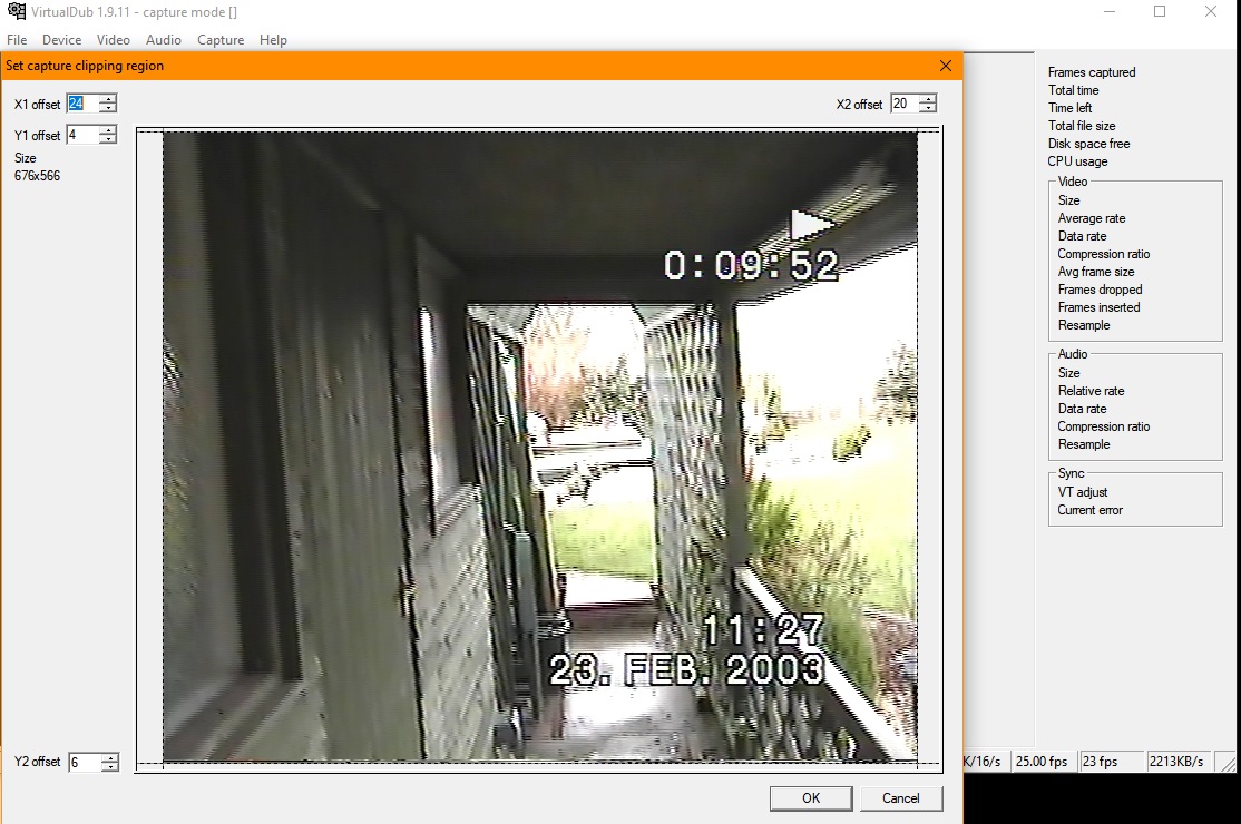

  9. Sorry just to add to this, I've noticed I can actually see the video when I go to Video> Cropping:
    [Attachment 64945 - Click to enlarge]
    Stumped

  12. Capturing Memories dellsam34's Avatar
    Jan 2016
    Stumped
    Switch between "Preview" and "Overlay" and see if that fixes the preview.
