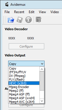

    -avidemux do not support 265/hevc
    --video-codec >> XVID4 | x264 | FFmpeg4 | VCD | SVCD |DVD | XSVCD | XVCD

  8. Originally Posted by kucing View Post
    It does:

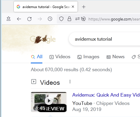

  9. thank you for the reply jagabo,
    but the main problem : the tutorial on the google almost not exist, all replies suggest to using FFmpeg

  13. Originally Posted by kucing View Post
    Yeah, searching google for "avidemux tutorial" only gives 670,000 hits.
