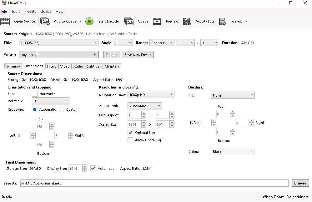

I having trouble to understand the handbreak auto cropping
this is the cropping setting is showing when i open the file using handbreak

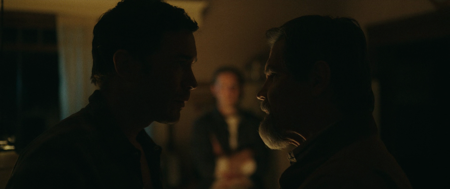

here is the original video screenshot (taken using vlc player)

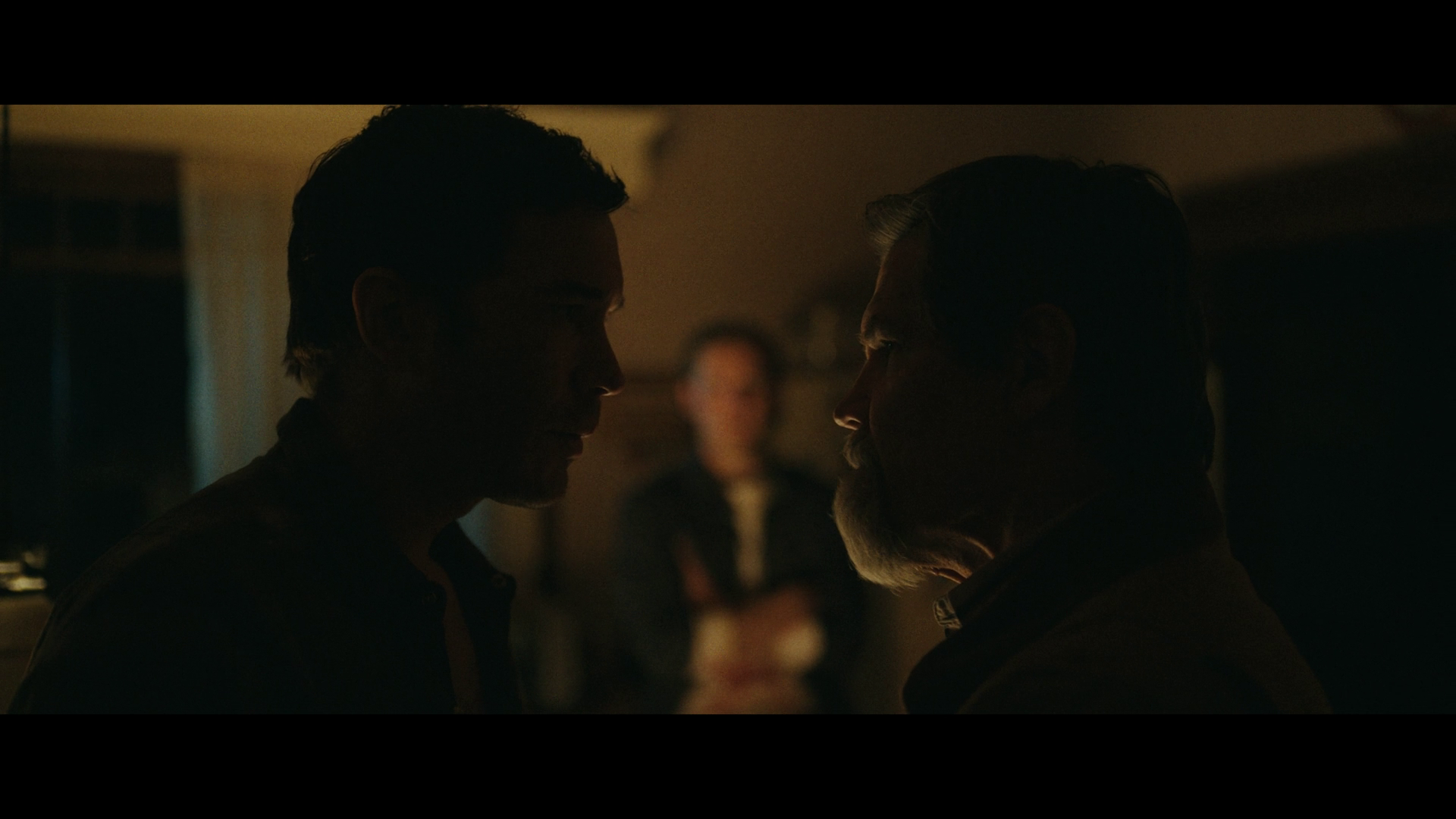

here is the encoded video screenshot using handbreak

the output video no-black part has top and bottom few pixel more crop than the original video. and i don't see and black border right side of the original video. i think it's about PAR/DAR/ASPECT ratio issue or something. any suggestion what am i doing is wrong?

1. How do you expect anyone to be able to distinguish a border (one that handbrake has actually determined) when the picture is so dark ?
2. You are wasting your time with the crop even if you cancel the right-side element. You have an AR greater than 16:9. By all means crop the letter-boxing away but once you play the movie full-screen the player will bring them back (unless you want a distorted view) -
It has nothing to with aspect ratios -- it just miscalculated. Just select Custom and set the cropping yourself. It's YV12 video so it must be cropped mod2.
@DB83 idk but i think they did pretty much good job though, almost perfect. i tried on virtualdub but it seems the crop number which handbreak used, may correct.
@jagabo if 16:9 video has top and bottom black border. will be there any beneficial to crop the top and bottom black bar? -
Removing black bars allows the player to optimize the picture for any display aspect ratio. For example, if you leave the black bars and view on a 21:9 display the player will add black bars to the left and right to fill the sides of that display -- you'll end up with black bars on all four sides.
