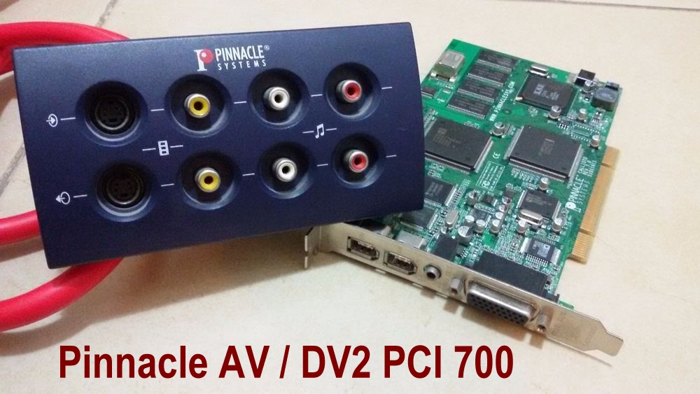

    I have this card, I'm having problems capturing mini DV tapes straight to the DVD recorder.
    For those who already understand my problems with the d-vhs and this same card, you must already be familiar with my drama.
    I'm afraid of damaging the DV output of this camcorder too, because I don't know if this card is generating some kind of short circuit in these firewire inputs.
    So what you guys advise me to do? Should i plug it in? Do I take the risk? Who should I turn on first the computer or the camcorder?

    First, you should do what many have already told you: READ THE MANUAL(S).
    Next, does this card/device have visible flaws? (May want a magnifying glass, and should check capacitor integrity and solder points). Without visible flaws or a HISTORY OF IT RUINING DEVICES*, why would you think there would be something wrong with it if you use it properly for its stated purpose?
    *Note: using it improperly would not be its fault, it would be your fault.
    Very often, manuals recommend to only plug in when both devices are turned off, then turning on the source, then the sink (destination).
    Am betting the manual for that device only mentions usage with analog or DV footage, NOT with mpeg2 footage, but protocol mismatching would not influence short-circuiting.

    Your drama with D-VHS is created by you, If you just followed the immense advice given it shouldn't have to be drama. I told you numerous times that the above card is only limited to DV by driver, You cannot use it to ingest from D-VHS or from a firewire hard drive or optical drive, You need a firewire card with a universal driver for data not just DV.

    There was no visible flaws at this PCI board.

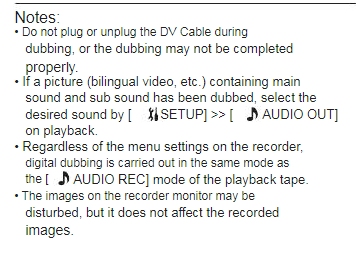

    I found this on the manual of my camcorder Panasonic PV-GS69 Image
    [Attachment 64702 - Click to enlarge]
