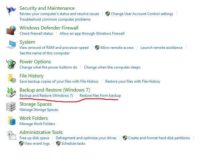

  5. Member pchan's Avatar
    Mar 2003
    Singapore
    You have done the Windows 10 Backup with a Windows 7 Utility?
    Anyway, if the Backup is from your Windows 10, you have to boot your computer with the Windows 10 Install CD, select the repair option prior the install start and restore all 3 backups.
    This is in Windows 10.
    [Attachment 64690 - Click to enlarge]
    I tried that route and it said something ISO image is not compatible with UEFI.
  6. Have you tried the other boot repair options from the Windows 10 Install disc?
    Read this
    https://www.howtogeek.com/239312/how-to-restore-system-image-backups-on-windows-7-8-and-10/
    In the future, use a decent backup program.
    https://www.lifewire.com/free-backup-software-tools-2617964
