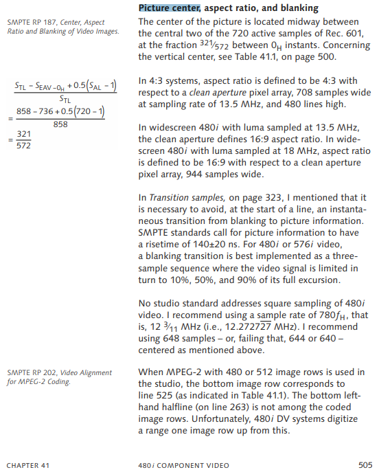

    It's not that simple, the active video area is not always in the center so cropping 8 pixels on each side blindly is not going to look good, Also it is not always 704, sometimes more, sometimes less, It's usually anywhere from 694 to 712 depends on the format and the recorder/camera that recorded the content.
    You cannot judge if a video is centered by looking at the blanking at the sides. A video produced in the analog times can be perfectly centered (meaning whatever was in the very center during the shoot or post is still exactly there) but there may be a huge border on the left and barely any on the right. Without a test pattern or some hint you cannot be sure. Unless it is obviously shifted I would always blindly crop to the center. That's how it would be displayed on a TV as well. Think of it this way: what was once actual video might have simply been overridden with black at some point (quite typical, happended all the time). This doesn't shift the position or change the size.
    That's in theory but in practice it's rarely in the center, I'm talking from experience dealing with several analog video formats not from a text book.
    What I normally do to center a 720x576 capture is to crop all back borders, then add same amount on the left and the right side and on the top and bottom side to build the 704x576 frame.
    Skiller's point, as I understand it, was that this is technically a distortion of the original signal. An accurate presentation of the video as seen on some theoretical, perfectly-calibrated CRT of the time would have the horizontal center precisely in the center of the horizontal sync pulses, no? And once digitized, the picture center is defined by spec. He's speaking of the center as originally "framed up", not in terms of where the edges of blanking sit in a final broadcast after it's passed through many signal chains.
    (Charles Poynton, Digital Video and HD: Algorithms and Interfaces, 1st Ed.)
    Of course, if you're going as far as shifting the vertical center of a 576 capture after head-switch noise crop, you don't care about this little inaccuracy.
    (None of this really matters to me either, personally. I'm happy to accept both some shift and a small percentage of aspect ratio distortion. Even the best BVMs/PVMs of the time weren't perfect and couldn't manage the precision of our flat panels that base their geometry on subpixels...)
    That's exactly what I'm talking about, thanks Brad.
