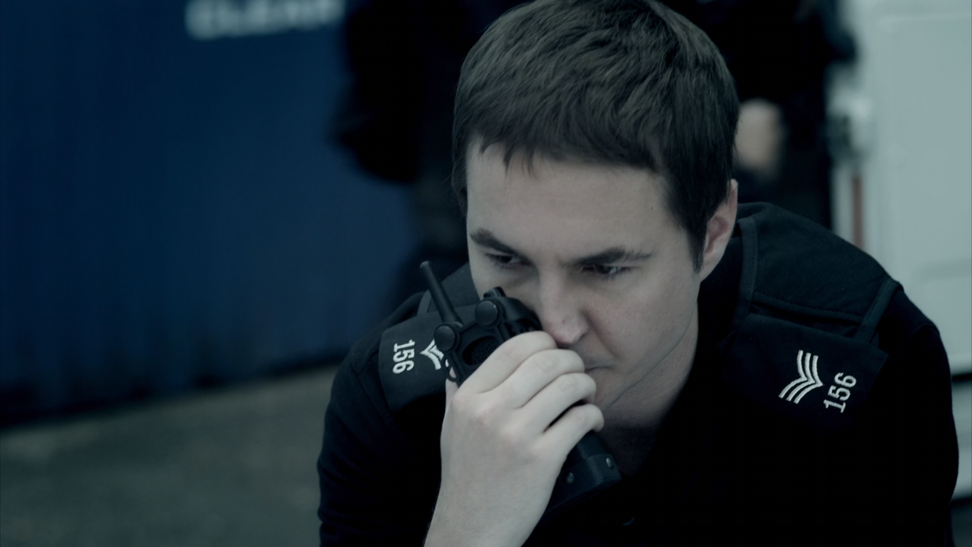

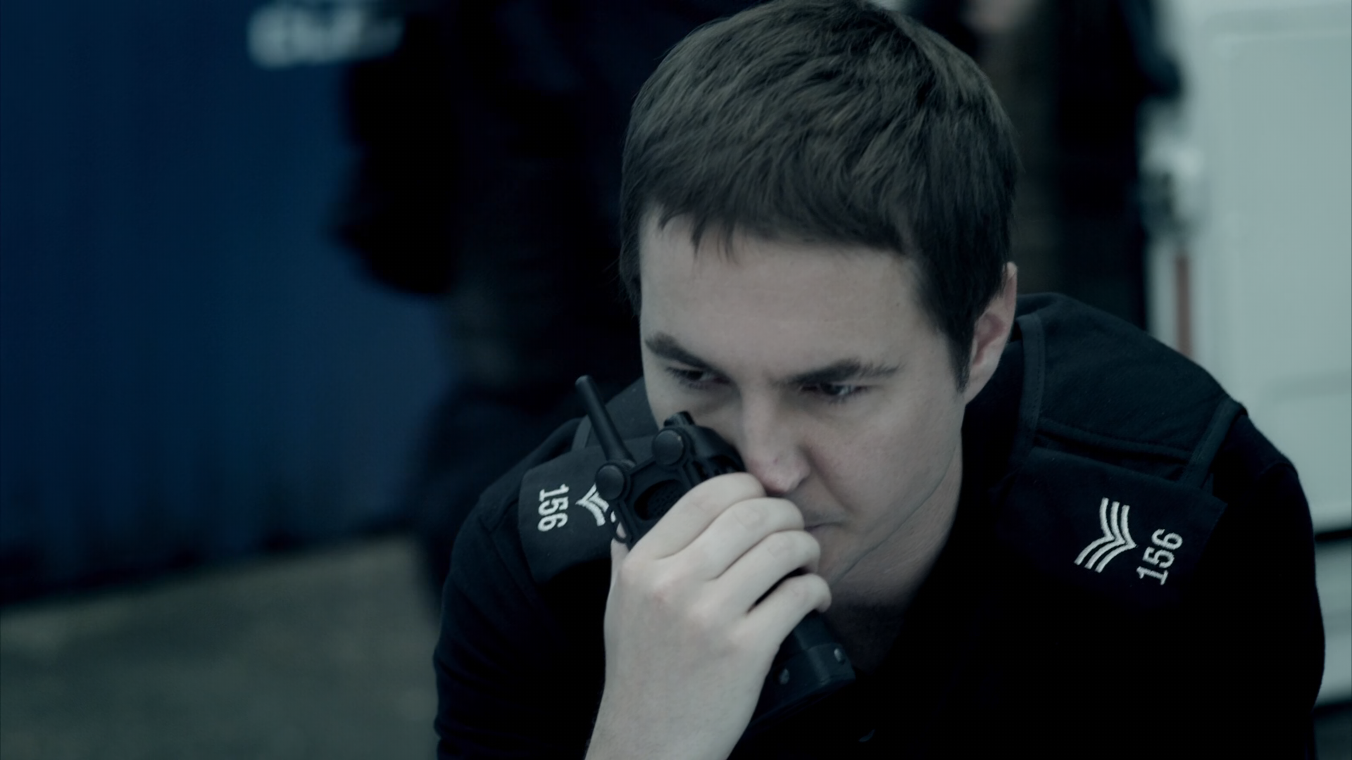

  1. Hello, I have done sample encodes with Staxrip and Vidcoder, both using CRF 18 with the slow Preset, but I can see a difference in the two of them.
    I will show a couple of screenshots from each encode.
    Vidcoder
    [Attachment 64603 - Click to enlarge]
    Staxrip
    [Attachment 64604 - Click to enlarge]
    For the sample with VC, I used Vidcoder, and for the sample with SR, I used Staxrip.
    I have also provided Mediainfo files
  2. Noise reduction was applied to the Vidcoder video before it was encoded. Hence the smaller file (ie, lower bitrate).
    Could you explain how, I have all the filters turned off via the Vidcoder settings.
    The filters now include Chroma Smooth and Colour Space, should I enable those filters? I am using the settings I am to try to get as close to source quality, bang for buck as I can.
  5. Another difference is the staxrip encode uses aq-mode 3, and the vidcoder encode aq-mode 2

  7. Vidcoder used compressed AAC LC for audio, while staxrip used PCM 1536 kbps (22% of the filesize).
    The video quality differences are very subtle IMO so keep the one you prefer.
