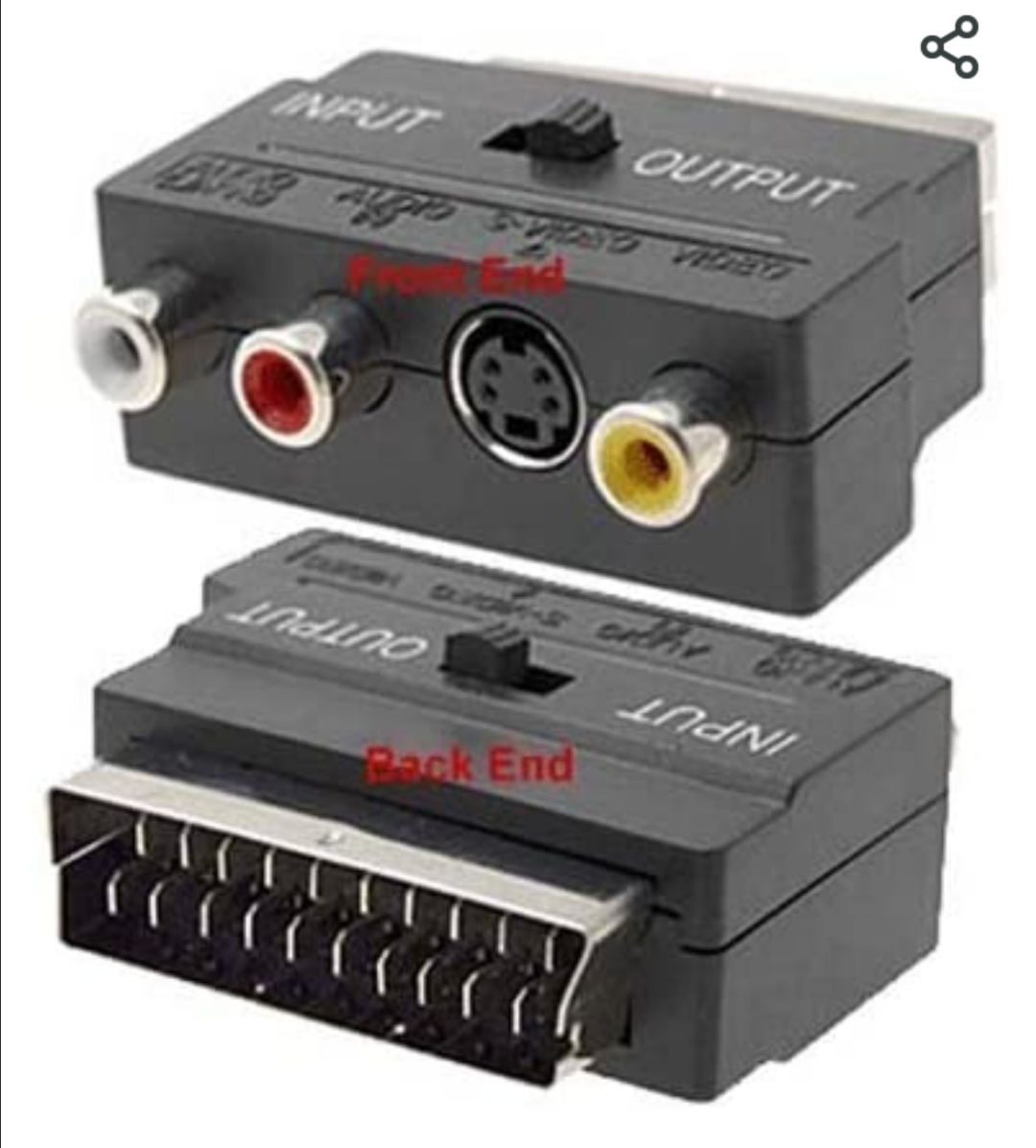

  2. Use an adapter like this
    [Attachment 64598 - Click to enlarge]
    and connect it to the VCR Scart output.

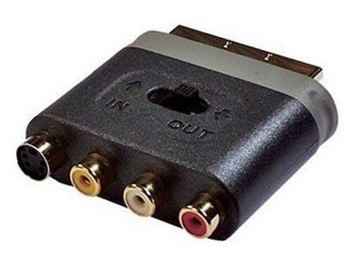

    Hello, I am using one - this (the Belkin SCART adaptor) is what I'm using in the back of the VCR:
    [Attachment 64599 - Click to enlarge]

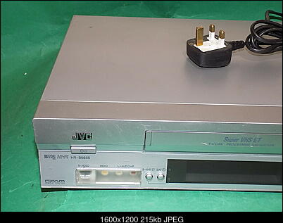

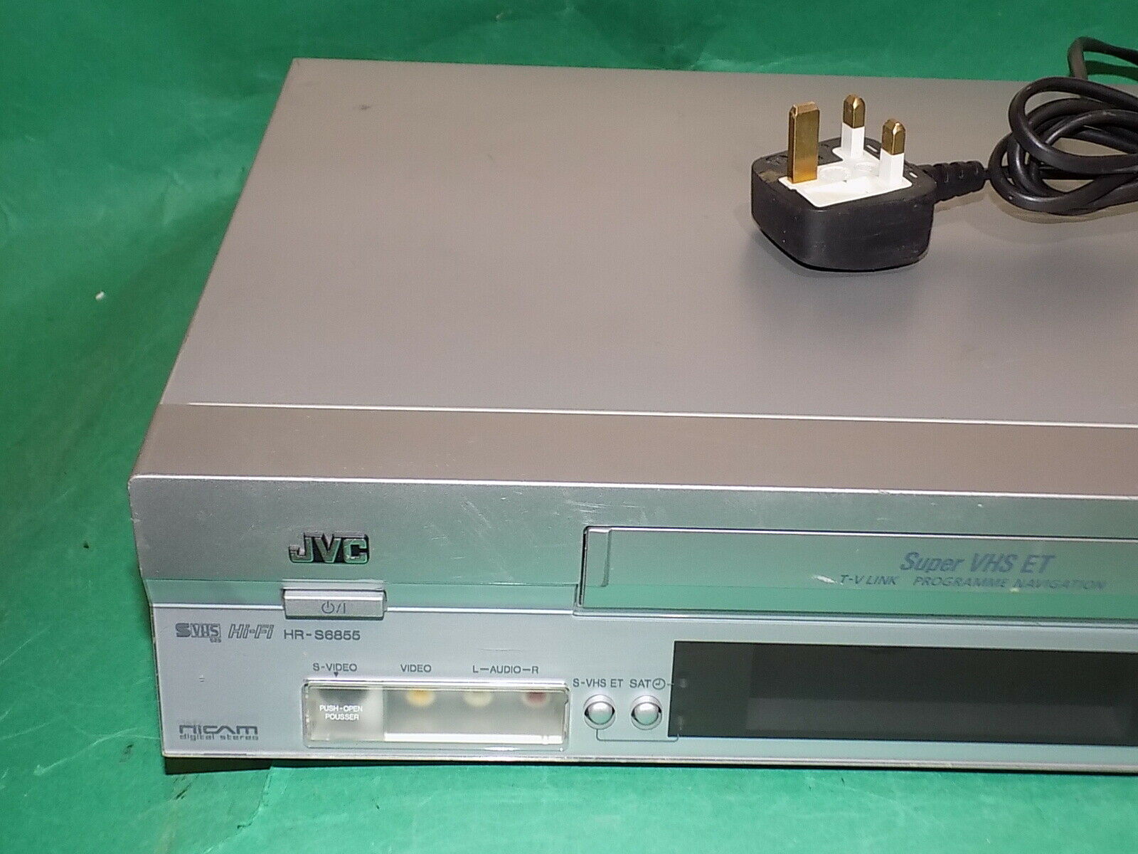

    I may be able to get hold of a JVC HR-S6855 here in the UK.
    It has S-VIDEO on the front Click image for larger version
    This on the rear:
    Any advice on this one?
  19. Member DB83's Avatar
    Jul 2007
    The front s-video will be for input.
    You could always do what we have to do and RTFM
    Here is the relevant page:
    https://www.manualslib.com/manual/84251/Jvc-Hr-S6855ek.html?page=9#manual
    May 2022
    Earth
    I was assuming based on the conversation above - and the fact this is SVHS - that the SCART may output colour via my Belkin in/out scart adaptor and S-VIDEO cable TO S-VIDEO?
    (Ref: https://www.manualslib.com/manual/84251/Jvc-Hr-S6855ek.html?page=50#manual)
  21. Yep, looks like it should work. Man, they wanted to simplify it, but only made it more complicated. Select this if your device support this, or select that if your device supports that. At least with dedicated cables you can just yank out a cable to make sure it is not being used.
