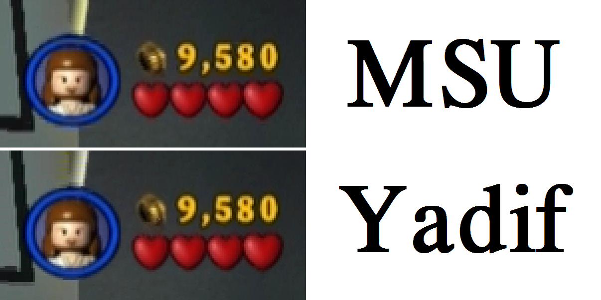

 Another thing is chroma. I noticed on your yesterday's video that red hearts are poorly rendered, looks "dirty". I noticed in VirtualDub2, that Yadif handles chroma better than MSU deinterlacer. Usually I prefer MSU over Yadif because MSU handles diagonals better, but in this case Yadif clearly was better.Last edited by ConsumerDV; 30th Apr 2022 at 14:24.
