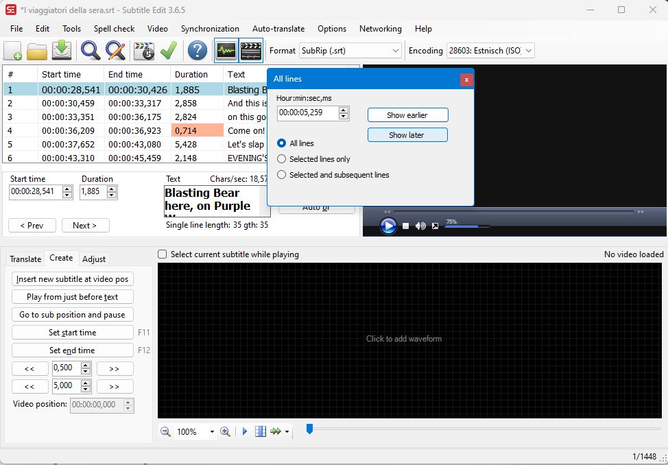

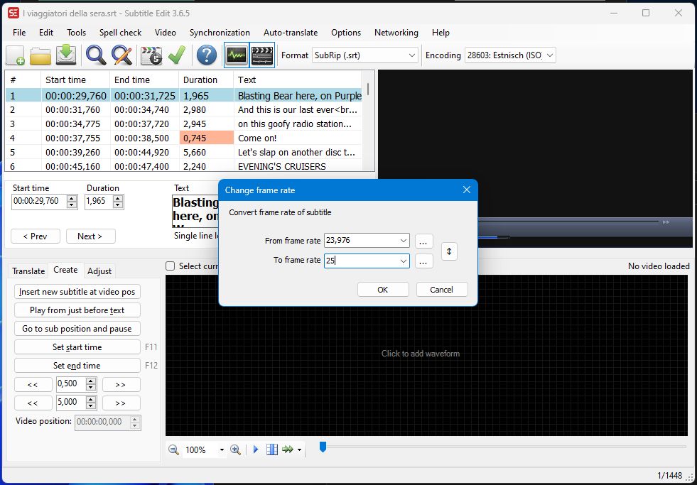

  5. Use Subtitle Edit.
    The english subtitle is probably for a movie with 23.976 fps. So you should first convert this subtitle to a 25 fps subtitle (Synchronization, Change fram rate).
    [Attachment 64564 - Click to enlarge]
    The subtitle will then start at 28,541 seconds.
    Then use (Synchronization, Adjust all times, all lines, show later) with 5.529 seconds to bring it to the desired start time of 33.800.
    [Attachment 64565 - Click to enlarge]
    Then save the new srt.
