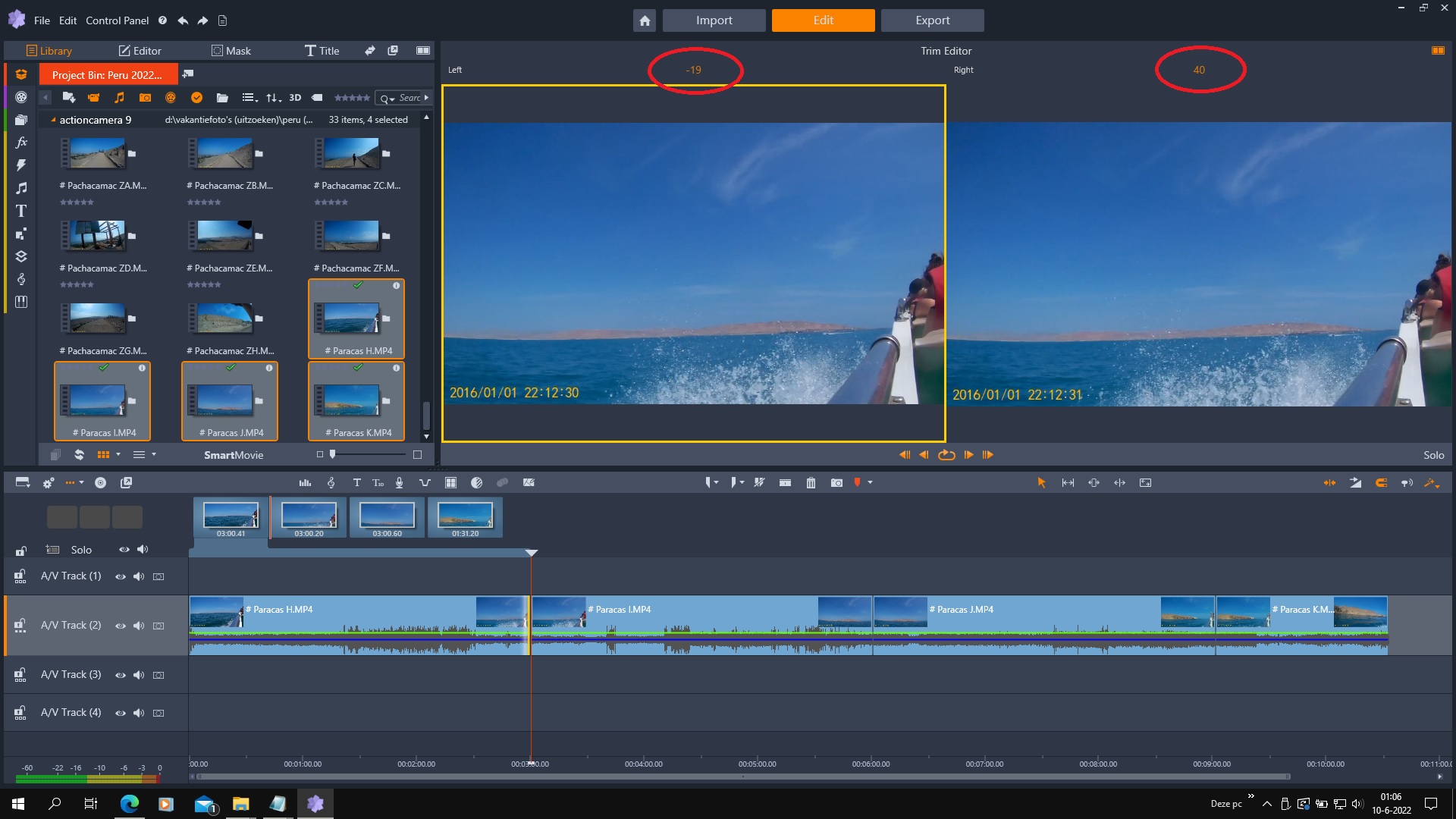

 In Pinnacle I just have a trim editor which shows both left and right clip, and gives the possibillity to precisely find the matching frames with previews next to each other.
 In this printscreen the numers on top show the frames I needed to adjust to find the perfect cut.
 When finished I just save and jump to the next cut to repeat unless all the clips are matched at the matching intersection.

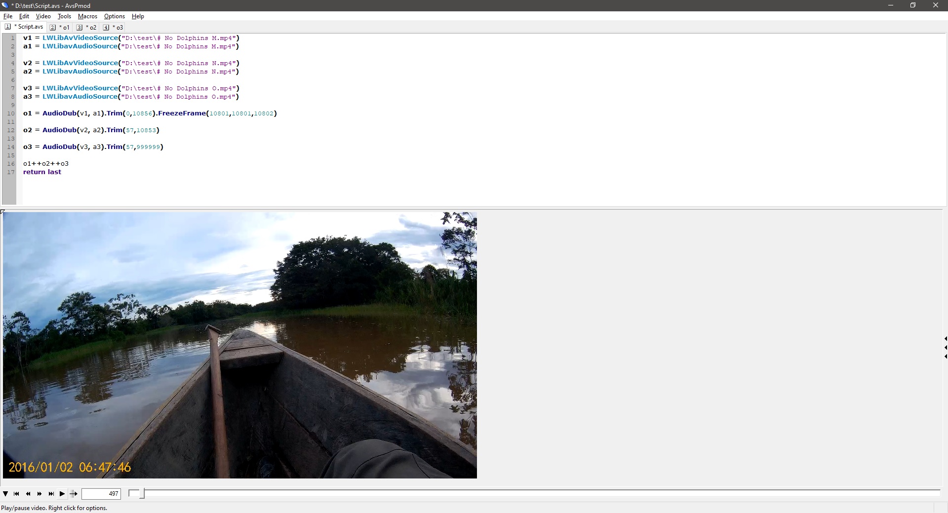

	I now got this script so far. It seems to be working as desired in script playback so far.
 [Attachment 65315 - Click to enlarge]
 But now I've saved the script as an *.AVS file. And tried to use it on the batch file. It doesn't work. I've tried to change the extension *.MP4 to *.AVS in batchfile too. but with the same results.
 How should I edit this to a new clip now?
	You have duplicate "o1", it doesn't work like that, do it as you did before.

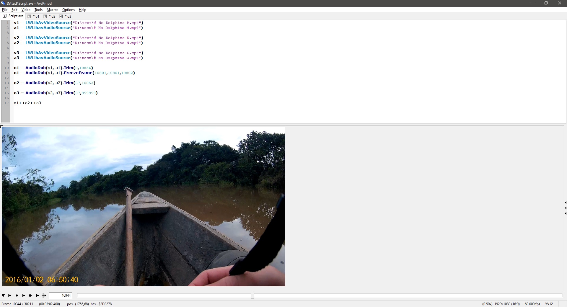

 Having this so far now:
 [Attachment 65316 - Click to enlarge]
 No, this was just a short footage which were split into 3min. segments because of looprecording. These glitched frames only occured on automatically clips cuts in between. I mannually end the recording at the end of the 3h clip. So there's no glitched frame here.
 The seccond clip was also not containing a glitched frame.

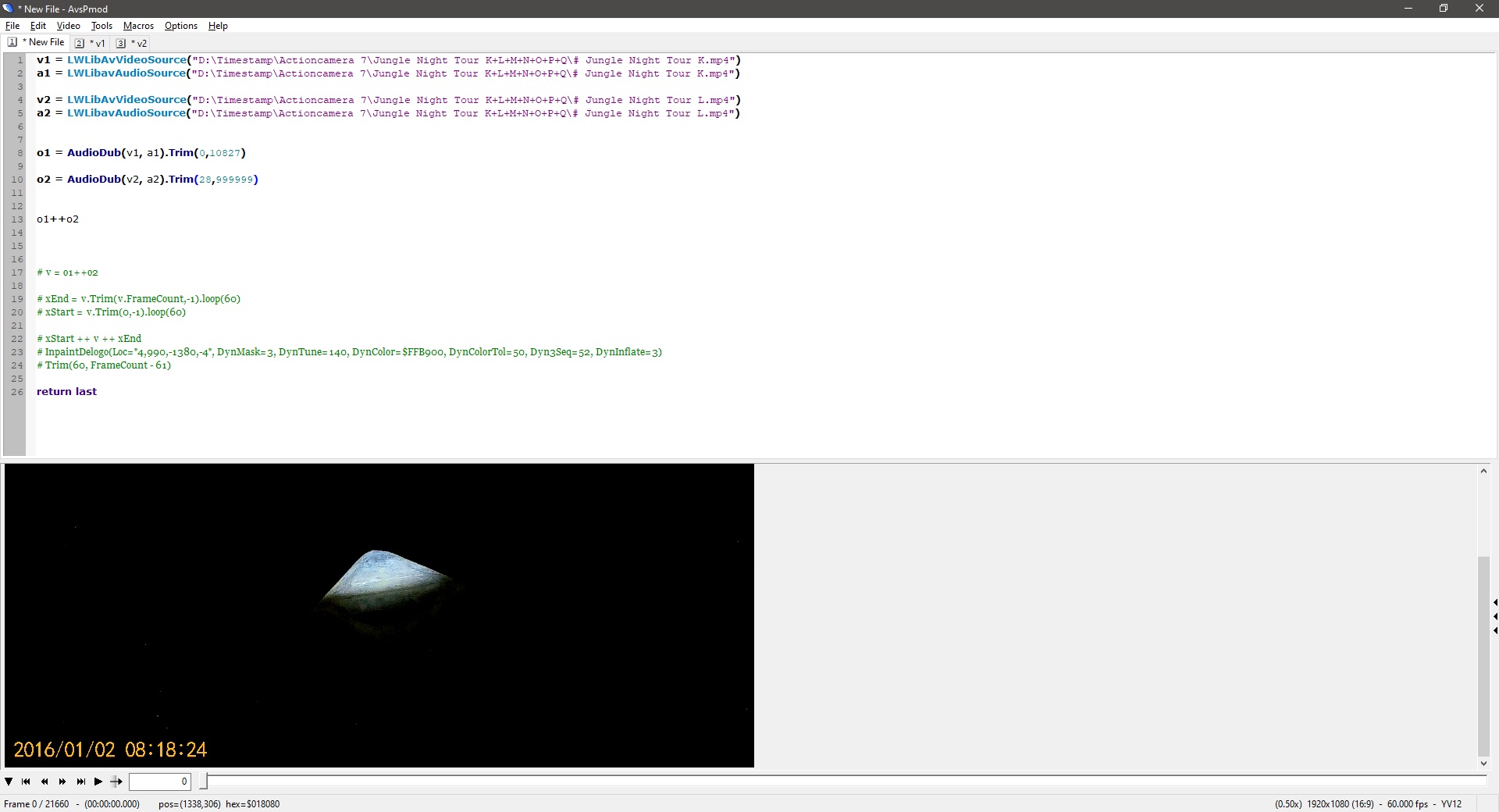

 I've prepared this script now:
 The biggest files I'm going to make exist out of a maximum of 11 clips.Code:v1 = LWLibAvVideoSource("D:\dir\file.mp4") a1 = LWLibavAudioSource("D:\dir\file.mp4") v2 = LWLibAvVideoSource("D:\dir\file.mp4") a2 = LWLibavAudioSource("D:\dir\file.mp4") v3 = LWLibAvVideoSource("D:\dir\file.mp4") a3 = LWLibavAudioSource("D:\dir\file.mp4") v4 = LWLibAvVideoSource("D:\dir\file.mp4") a4 = LWLibavAudioSource("D:\dir\file.mp4") v5 = LWLibAvVideoSource("D:\dir\file.mp4") a5 = LWLibavAudioSource("D:\dir\file.mp4") v6 = LWLibAvVideoSource("D:\dir\file.mp4") a6 = LWLibavAudioSource("D:\dir\file.mp4") v7 = LWLibAvVideoSource("D:\dir\file.mp4") a7 = LWLibavAudioSource("D:\dir\file.mp4") v8 = LWLibAvVideoSource("D:\dir\file.mp4") a8 = LWLibavAudioSource("D:\dir\file.mp4") v9 = LWLibAvVideoSource("D:\dir\file.mp4") a9 = LWLibavAudioSource("D:\dir\file.mp4") v10 = LWLibAvVideoSource("D:\dir\file.mp4") a10 = LWLibavAudioSource("D:\dir\file.mp4") v11 = LWLibAvVideoSource("D:\dir\file.mp4") a11 = LWLibavAudioSource("D:\dir\file.mp4") o1 = AudioDub(v1, a1).Trim(999999,999999).FreezeFrame(1000,1000,1001) o2 = AudioDub(v2, a2).Trim(999999,999999).FreezeFrame(1000,1000,1001) o3 = AudioDub(v3, a3).Trim(999999,999999).FreezeFrame(1000,1000,1001) o4 = AudioDub(v4, a4).Trim(999999,999999).FreezeFrame(1000,1000,1001) o5 = AudioDub(v5, a5).Trim(999999,999999).FreezeFrame(1000,1000,1001) o6 = AudioDub(v6, a6).Trim(999999,999999).FreezeFrame(1000,1000,1001) o7 = AudioDub(v7, a7).Trim(999999,999999).FreezeFrame(1000,1000,1001) o8 = AudioDub(v8, a8).Trim(999999,999999).FreezeFrame(1000,1000,1001) o9 = AudioDub(v9, a9).Trim(999999,999999).FreezeFrame(1000,1000,1001) o10 = AudioDub(v10, a10).Trim(999999,999999).FreezeFrame(1000,1000,1001) o11 = AudioDub(v11, a11).Trim(999999,999999).FreezeFrame(1000,1000,1001) v = o1++o2++o3++o4++o5++o6++o7++o8++o9++o10++o11 xEnd = v.Trim(v.FrameCount,-1).loop(60) xStart = v.Trim(0,-1).loop(60) xStart ++ v ++ xEnd InpaintDelogo(Loc="4,990,-1380,-4", DynMask=3, DynTune=140, DynColor=$FFB900, DynColorTol=50, Dyn3Seq=52, DynInflate=3) Trim(60, FrameCount - 61) return last
 So this way I always have the same setup without the risk of making typo's here. And I just have to remove the lines or vallues that are not in use when merging smaller video's

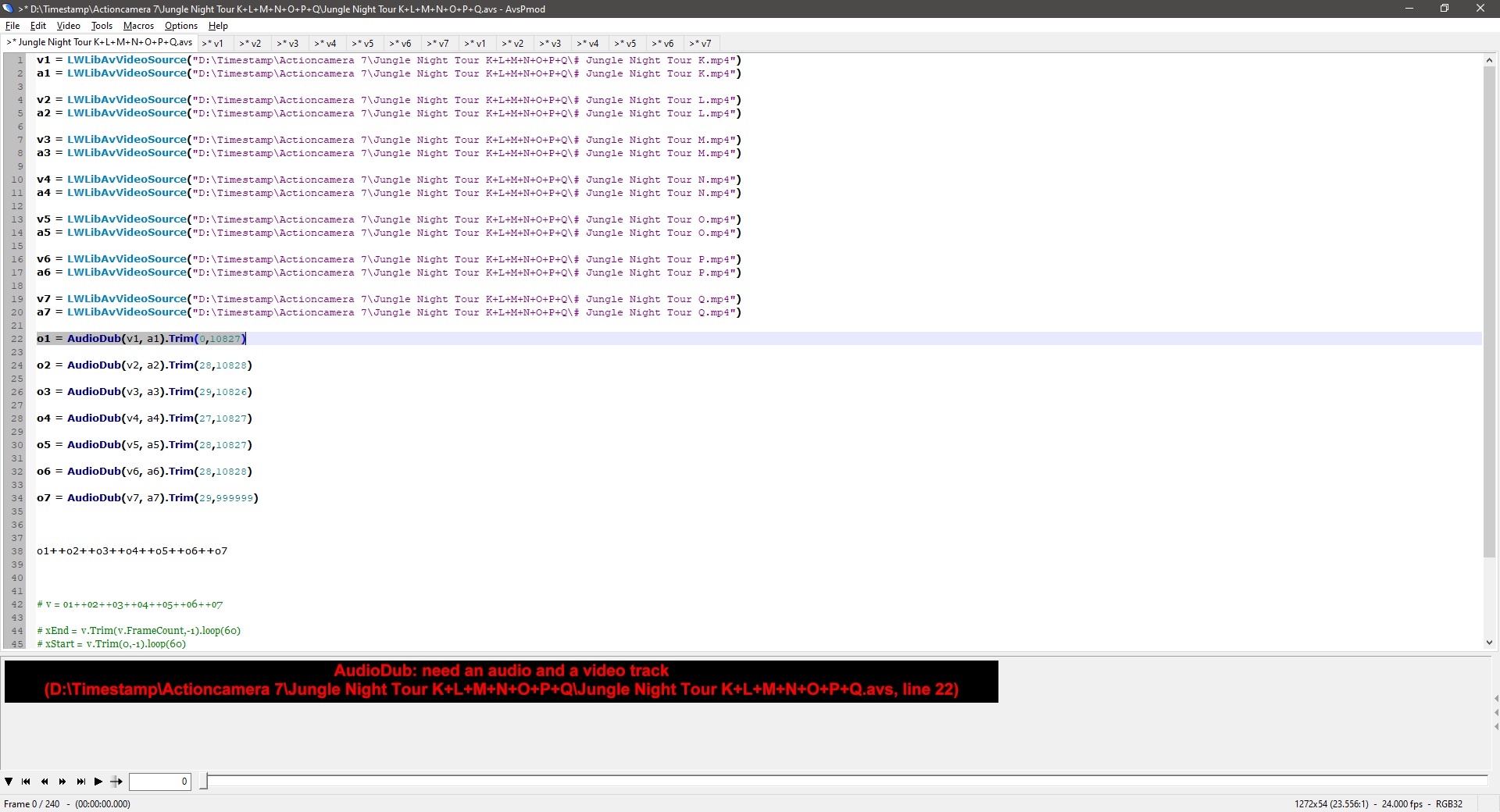

	What is going wrong here?
 I just configured another video in exactly the same way, but it didn't gave errors.
 [Attachment 65327 - Click to enlarge]
 The path and the filename is correct, it's the same as tab 1 and I have videoplayback there.
 Edit:
 Strange, this is working...
 [Attachment 65328 - Click to enlarge]Last edited by Rockel83; 10th Jun 2022 at 18:36.
	v1 and a1 are both opening the video stream. You need to change a1 to open the audio. Same for the other imports.
