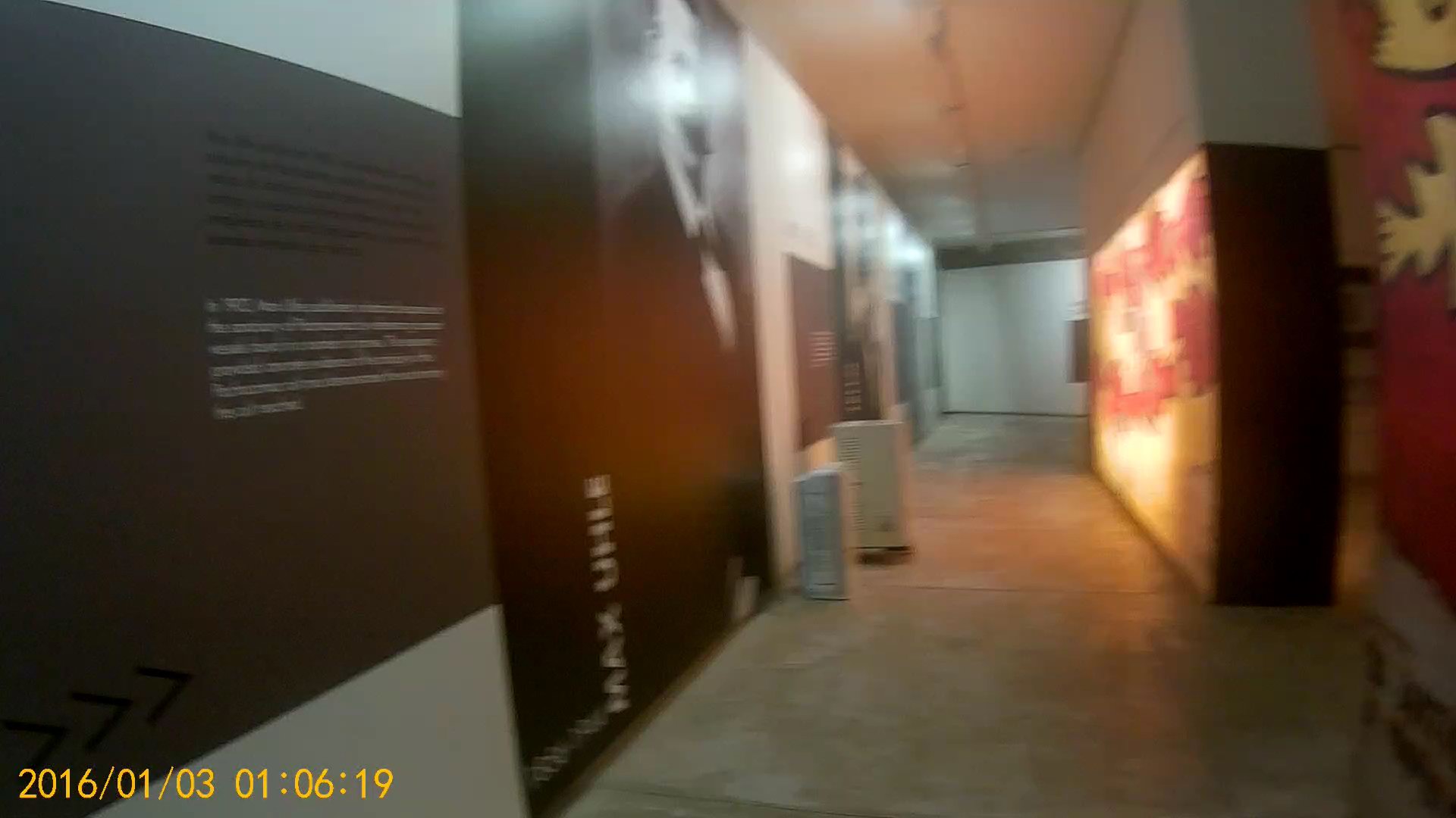

    This is a screenshot of the timestamp (located botom left, but it's hard to miss haha).
    [Attachment 64537 - Click to enlarge]
    But it's actually found on a lot of video's, over 100. With a lot of diversity of landscapes and backgrounds.

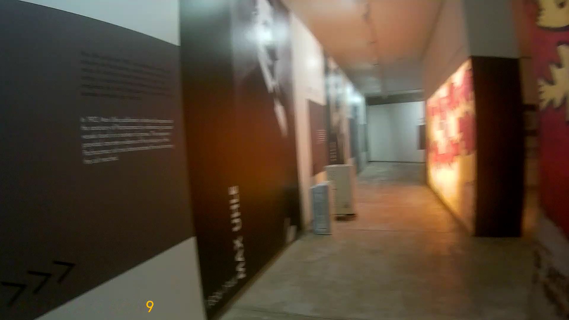

    I did a small test, overlaying the time stamps with a rectangle and inpaint the whole rectangle in Vapoursynth:

    which doesn't look bad (recangle need to be a bit wider), but removing something from a pictue and from a clip consisting of xy pictures per second are different things,... (temporal coherence is a ....) Also it would be better to have a proper mask instead of a static rectangle.
    -> InpaintDelogo might be the right approach, but this at least shows the idea

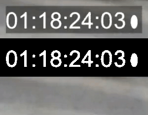

    Once I removed a more complex timestamp:
    Before:
    After:
    Gif of timestamp [from top to bottom: original/mask/result]

    Yes, "DynMask" specifies a method to get a dynamic mask, "DynMask=1" is for your own dynamic mask.
    Btw, the last digit in this video stays steady for 1s [60fps] so only max "Dyn3Seq=60" can be used, that is not enough to get a clean mask in this video as background sometimes is brighter than timestamp, currently InpaintDelogo doesn't use colors to get mask, maybe I could add some parameter for colors to help.
    Anyway there is "maskPatch" parameter, it can be used to cover all variations of the last digit.

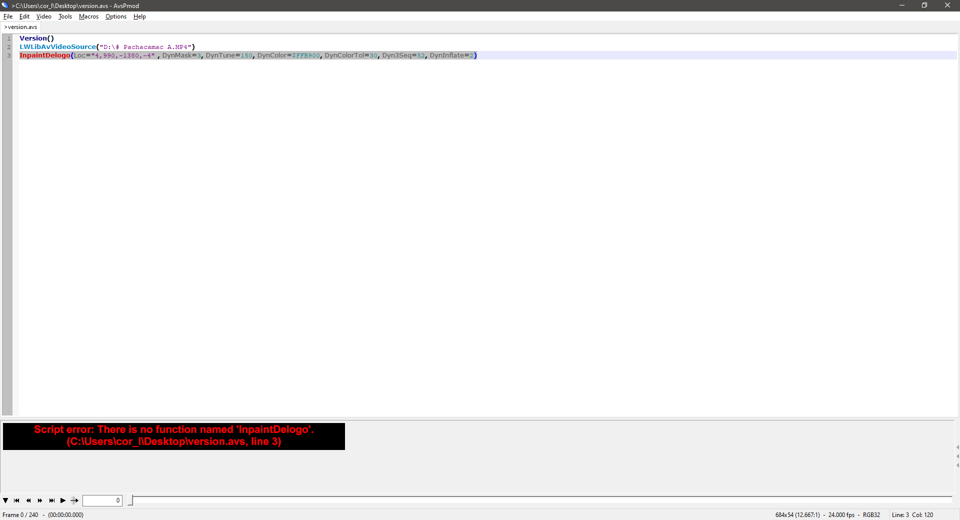

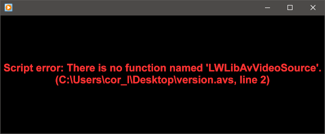

    I've made a file called "version.avs" with the following content:
    Version()
    LWLibAvVideoSource("D:\# Pachacamac A.MP4")
    InpaintDelogo(Loc="4,990,-1380,-4" , DynMask=3, DynTune=150, DynColor=$FFB900, DynColorTol=30, Dyn3Seq=52, DynInflate=2)
    But when opening this "version.avs" with MediaPLayer, it gives me the following error:
    [Attachment 65055 - Click to enlarge]
    And with AvsPmod:
    [Attachment 65056 - Click to enlarge]

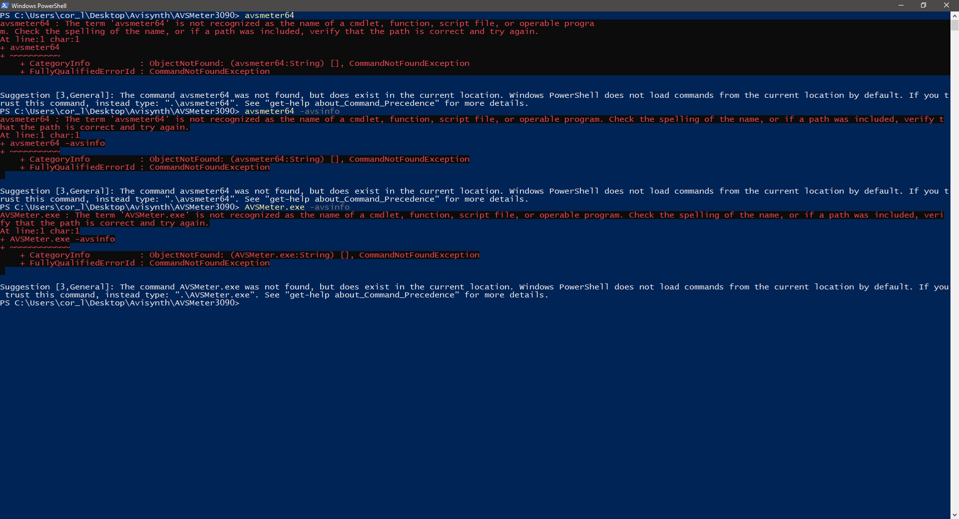

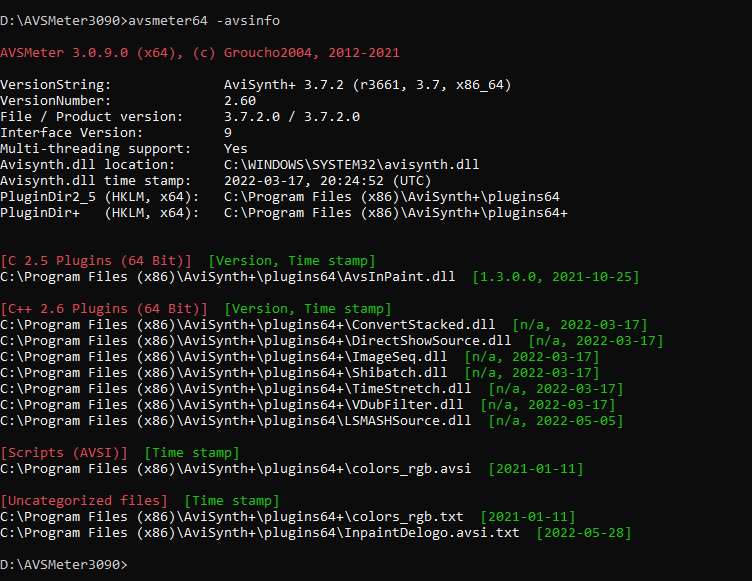

    Not knowing what I'm doing wrong here. Ive downloaded the AVSmeter and checked this site for help: https://forum.doom9.org/showthread.php?t=174797
    But it doesn't gives me a proper output to whatever I type.
    [Attachment 65061 - Click to enlarge]
    Should this be placed in the AviSynth+ directory or whatever?
  27. Video Damager VoodooFX's Avatar
    Oct 2021
    At Doom9
    You are trying to run it in PowerShell, you need to run it in Command Prompt [cmd.exe].
  28. Member Rockel83's Avatar
    Apr 2022
    Holland
    Oh cool! That did the trick!
    I tought both had the same functionality... And Powershell was easier to open in a specific dir, holding Shift
    But in CMD I got feedback!
    [Attachment 65062 - Click to enlarge]
  29. Video Damager VoodooFX's Avatar
    Oct 2021
    At Doom9
    It should be "InpaintDelogo.avsi" not "InpaintDelogo.avsi.txt", and required plugins are missing, install them all.
