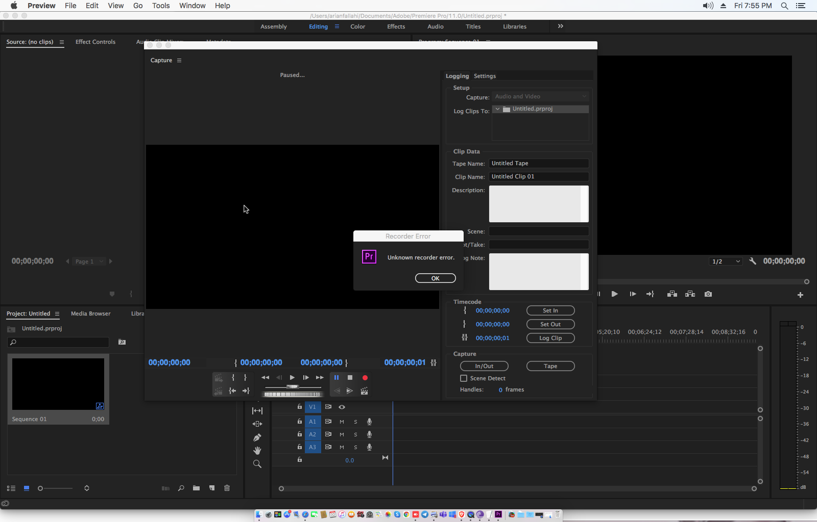

  1. Alright, so this time around I'm dealing with Panasonic's technology since I got a very sweet deal on a brand new D-VHS VCR from them.
    No Component or HDMI output, but I see a Firewire out. So instinctually, I think that that's the only feasible HD output on the deck, since the rest of it consists of Composite, S-Video, and Coaxial. Plenty of people have done Firewire captures with their camcorders and even specialized tape decks, so why not with this? I mean, the output is there.
    However, since I've gotten my hands on the hardware, it's been nothing but technical difficulty. And the Internet doesn't have many opinions on these issues, let alone clear cut answers.
    The problem is also not as clear cut as you may think. My Firewire cards on both my Mac as well as my Windows 10 PC can clearly detect the VCR as well as identify it. And I can even control the playback within Adobe Premiere Pro, but I'm not seeing any video or hearing any audio to preview and nothing can be recorded.
    I'm just curious as to whether I'm doing something wrong, if there's a setting on the VCR I don't know about (I can't read Japanese), or if the Firewire output is just for show. But seriously, why have it if you can't capture footage? That's half the purpose of Firewire alone.

  4. Capturing Memories dellsam34's Avatar
    Jan 2016
    No $hit heh, They leave the threads hanging and wonder why their problems don't get solved, I'm actually more patient than some members even when I sometimes use harsh words.
    Anyway, a common practice some thread starters do is never read the user manual for the thing they are inquiring about and come here looking for spoon feeding, If he read the manual he would have known that a D-VHS is not a DV machine, it is an MPEG-2 HD/SD, therefore DV capturing software will not be able to capture anything.

    Nov 2021
    I had this problem with my two JVC HM-DH30000U. I connected the cables, the software installing appeared and it installed everything normal, went to look for the video and audio and nothing.
    I went to work on another one of the same model, and I messed up! I believe that when I moved and changed the cables without turning off the devices and computer, I damaged (Fried or fry) the dv/I-link output of the Dvhs or the firewire input of the capture card. I still do not know.
    Because now if I connect the cables, the computer shows a driver error incorrectly installed with an exclamation mark in the driver.
    Until then, I didn't know that I had to have such a CapDVHS.exe on the computer to capture audio and video from the D-Vhs.
