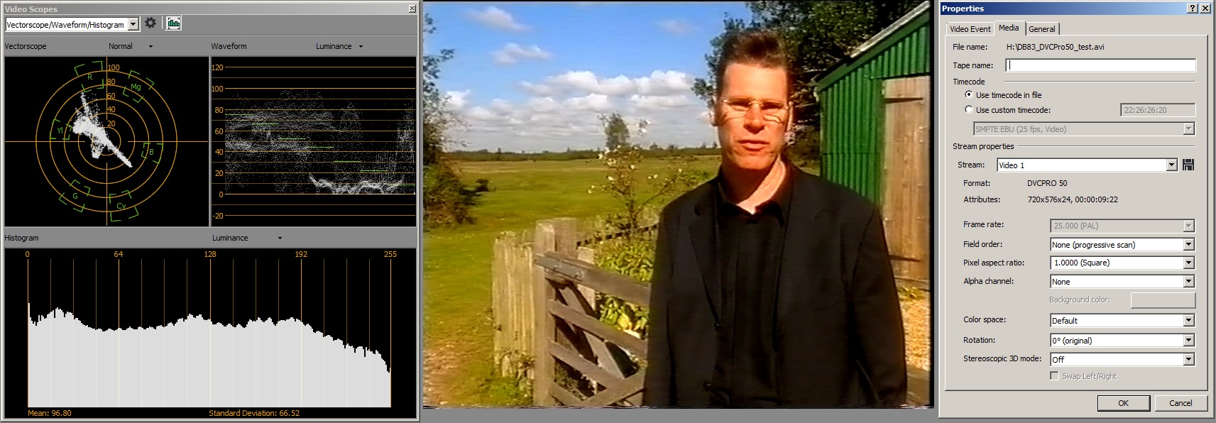

  3. @DB83, thanks! This is not my source, but it does not matter. Does the dude look at a nuclear blast? Still not the effect I hoped for. Is something wrong with Vegas? Had it got worse from v13 to v14? I don't want to upgrade anyway, I think v17 requires Windows 10, also it was blamed in being less reliable lately.
    Thanks for the attempt!

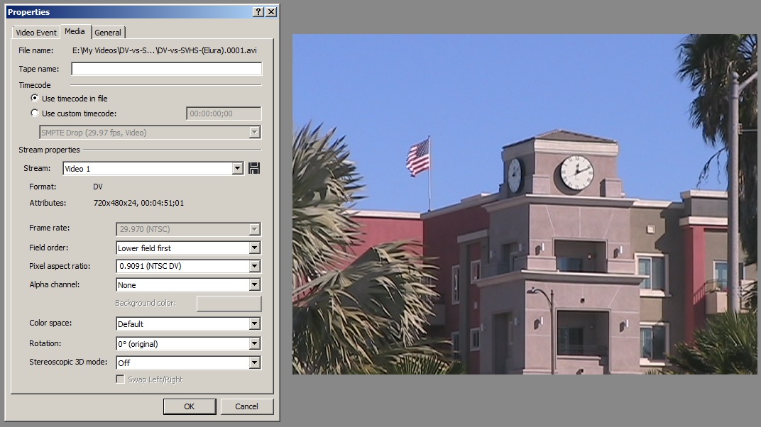

    I loaded a DV-AVI file captured through FireWire, and it reports correct metadata. Oh, well.
