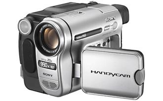

    Hello friends, I bought this camera, I don't know if it's good, I had some tapes from a friend, but I don't know if it had something recorded, because the video is just showing this (video I sent).
    I know it doesn't read digital tapes. Would that be the case?
    I would be very grateful for advices on how and what to use in it.

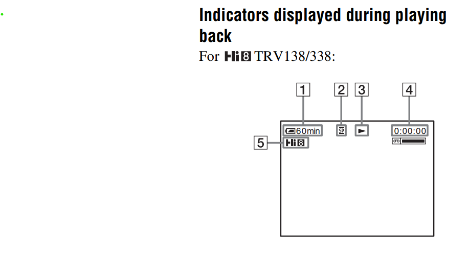

    According to the manual page 34 I would have expected the Hi8 logo to appear on the screen for a Hi8 analog video, but I don't really know.
    Secondly, why are you always posting in bold letters? Means shouting at people.
Name:	Screenshot 2022-04-21 104856.png

    That's just a V8/Hi8 camcorder, The tape could be blank or could be a D8 tape, To find out for sure you would need a D8 camcorder, No need to get a D8 with analog playback since you have an analog camcorder already.

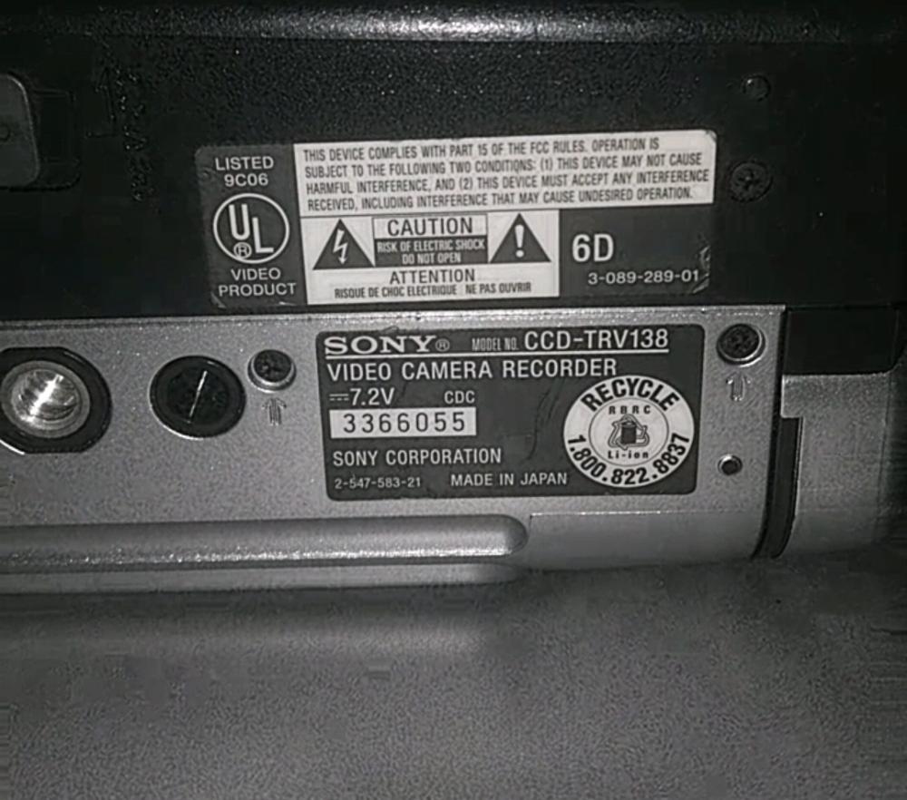

    Maybe a PAL/NTSC mismatch? You're in Brazil where the TV standard was PAL-M. Is your TRV138 a Brazilian variant, or an import?

    Is your TRV138 a Brazilian variant, or an import? How to know that??

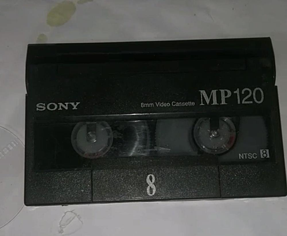

    There were 4 TDK tapes and one sony like that on the pic. All of them were like the video i posted here.
    [Attachment 64456 - Click to enlarge]

    As far as I know, Digital8 can only be recorded on tapes bearing the Digital8 or Hi8 logo, not standard "8" (Video8) as pictured.

  14. Looks like a Video8 cassette to me, rather than Hi8 or Digital8. This would explain why you don't get the Hi8 logo on your screen.
    The Hi8 logo or Digital8 (D8) logo is normally printed on the cassette case as well. Surprised to see "NTSC 8" on your cassette.
    Your tapes may simply be empty because your Handycam should also play Video8 as far as I know, but I am not sure.
    Or the recorded format is NTSC and your Handicam (PAL for Brazil) is not compatible with the recorded format.
