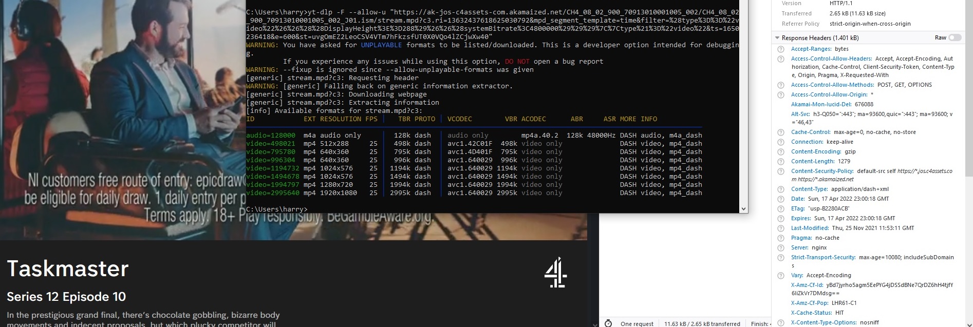

    [Attachment 64378 - Click to enlarge]

    I ran the command and obtained the list, as showed in the codehound's screenshot.
