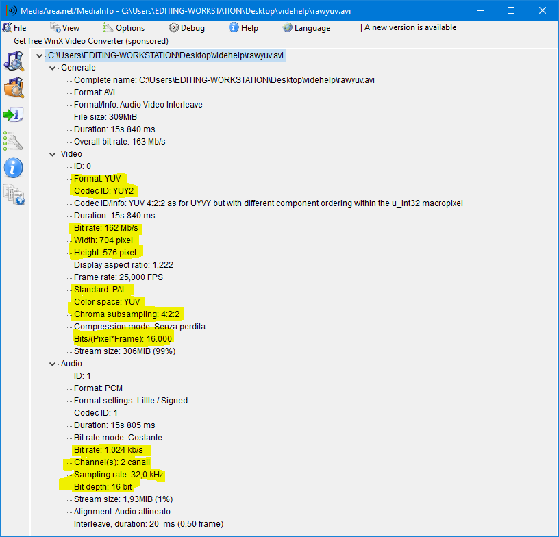

    I've recoded them in YUY2 lossless mode, but I have no space to keep them all this way, since they take about 75GB/h...Image
    [Attachment 64315 - Click to enlarge]

    A raw yuv sample is attached (just one second because it would be sooo large)

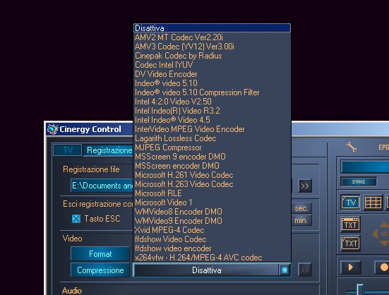

    I can't capture any HuffYuv here. I could only convert it afterwards, if I can avoid to convert it to RGB24, like VirtualDub wants me to...
    [Attachment 64337 - Click to enlarge]

    I can't capture any HuffYuv here.[...]
    You've got Lagarith, x264vfw, etc. installed so your capture program certainly has no problem using external codecs. Just install Ut Video Codec or MagicYUV; they're better than Huffyuv these days anyway.

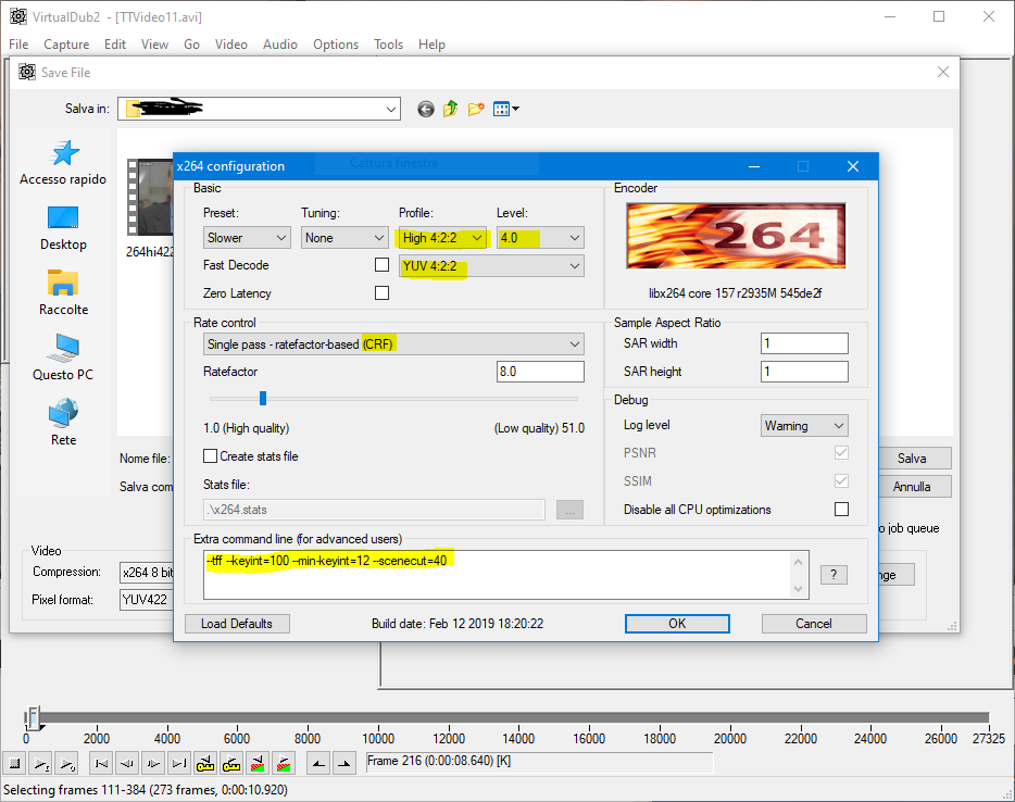

    I guess then I would be going to keep some masters in ut/magicyuv, and the least important tapes in H264 high422@L4 at around 25-30 Mb/s.
    Something like this for instance
    [Attachment 64340 - Click to enlarge]
    Of course I'm not caring at all about compatibilty across all devices, since of all the recordings I'm going to have a vp9 deinterlaced low-bitrate copy (and perhaps upscaled).
